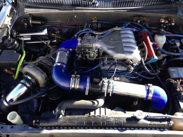

    Of course man. I assume you'll be fine with a 2" 135 degree silicone bend straight into a small 2" pipe that immediately opens up to 3" to fit over the MAF input and 90 degree bends straight into the TB.

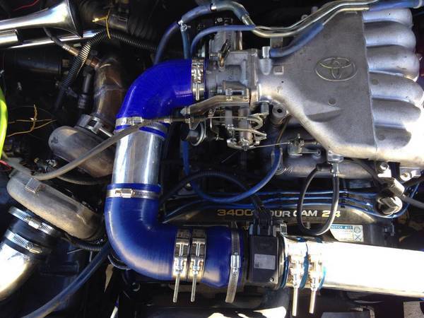

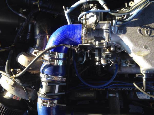

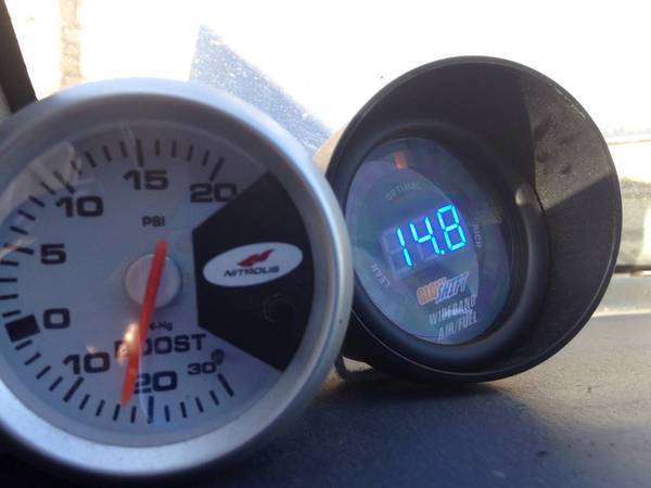

    Hey guys I found out that the placement of the MAF is VERY important in both fuel economy and power. With an elbow attached directly to the input, the truck idles at 1500k rpms and 13.2:1 AFR. With just a straight 3" pipe feeding it, it idles at 1100 RPMs and 14.7:1 AFR. It's also different when driving. In complete vacuum it stays within 13-14 AFR during acceleration but with the elbow right in front of it it fluctuates between 11 and 15 (mostly near 15) during acceleration. Boost affects it a lot less than I would have imagined... of course we're talking a measily 5 psi though. So you dudes who are fabbing up your own intake system, make sure your MAF has AT LEAST a couple inches of straight 3" pipe feeding it with a straight silicone coupling. Even if you have to cut the wires and make the harness longer to put the MAF a little more upstream.

    A honeycomb flow straightener can help too :thumbsup:
    Are your running a BOV btw?
  13. Oct 3, 2014 at 8:28 AM
    #93
    GioGuitarDude
    GioGuitarDude [OP] Well-Known Member
    Jun 18, 2013
    #106509
    959
    Gio
    96 TURBOCHARGED 5 speed X-cab 3.4 DLX tacoma
    Cold air intake
    The intercooler does a good enough job of mitigating the spiral effect of the turbo. I was thinking about getting a flow straightener but I'm sure I can come up with a solution that costs less than $90+. No blow off valve, but if I do get one its going to be one of those gradual release ones that keep boost in there durring a shift but also take some of the opposing force away from the compressor to get rid of surge. I hate that hehehehehehe chuckling sound of turbo surge.
    EDIT: Oh I forgot to tell you (and Robb) to make sure you use loctite or a second lock nut on each Vband clamp for the crossover pipe because mine have already come loose. Last night and today whenever pressure built up I would hear this annoying fart/whistling noise that I thought was a boost leak but turned out to be an exhaust leak. Loss in power and way laggier too. Tightened them up and back to normal.

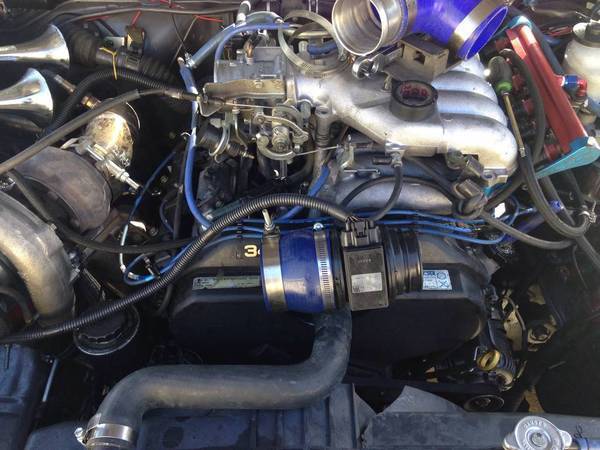

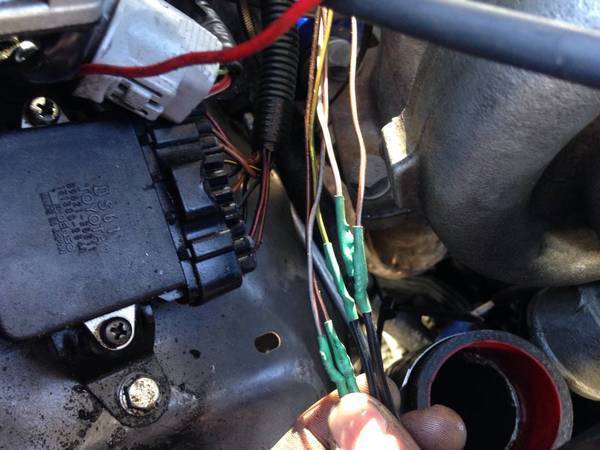

    Ok so today is the day that I set my intake up right. Idle is too high and too rich. Boost AFRs are too unpredictable.
    Step 1 - splice in 18" of extra wire length in the MAF wire harness.
    Step 2 - cut charge pipes down to perfect/non-goofy looking lengths.
    Step 3 - take a drive.
  19. Oct 5, 2014 at 4:50 PM
    #99
    GioGuitarDude
    Jun 18, 2013
    #106509
    959
    Gio
    Cold air intake
    Took a drive. Drives and idles PERFECTLY :yes:
