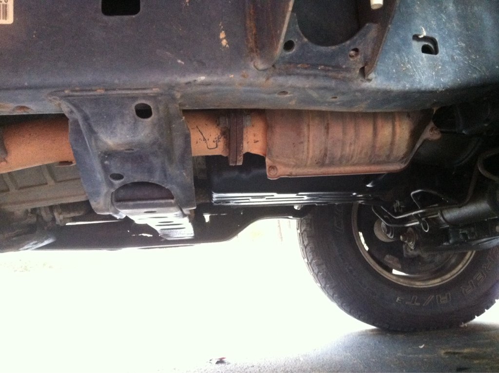

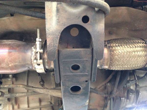

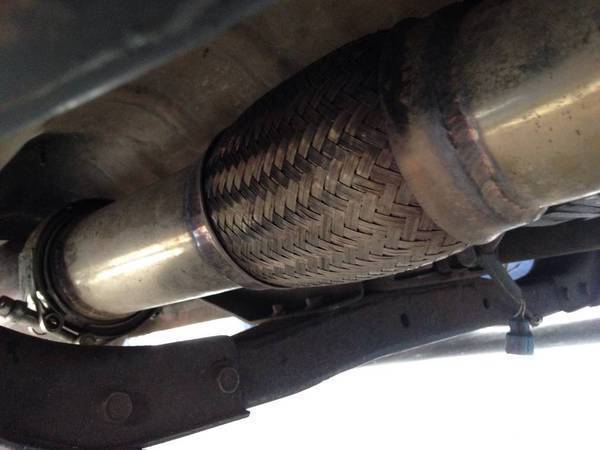

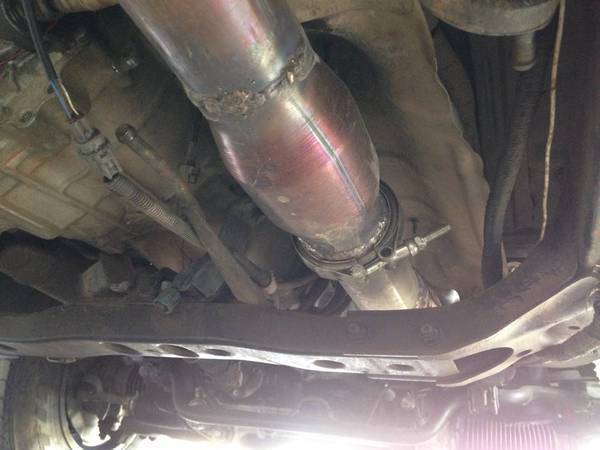

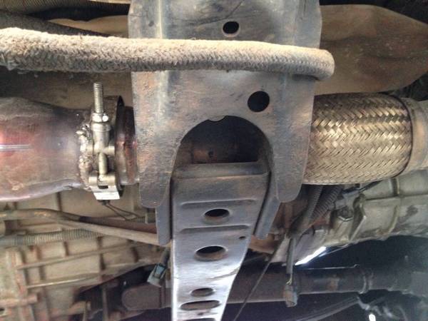

    Gio, any updates? How's it working so far?
    Think you could do me another favor and take some pictures of the downpipe under the truck? Trying to get an idea of how far back it goes before it terminates.

    Not sure how much that helps but the downpipe ends at that vband clamp

    That helps out quite a bit. It shows that you're correct and that the CXRacing downpipe terminates after the frame crossmember thingy, and my stock downpipe terminates before it.
