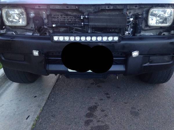

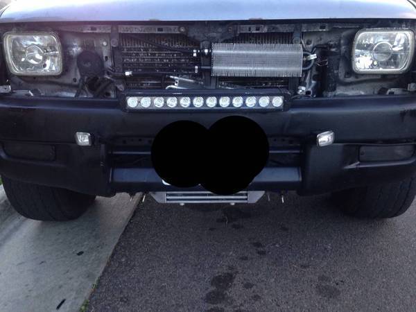

    A little update. I got done installing my pre-turbo oil cooler today. The lines went like this from engine oil port to turbo:
    3/8"NPT-1/8"NPT reducer>1/8"NPT inline restricttor>1/4" SS/nylon braided hose>oil cooler>1/4" SS/nylon braided hose>turbo.
    Then a touch of plastidip (the shade distortions are undried plastidip)
    255 walbro install maybe tomorrow.

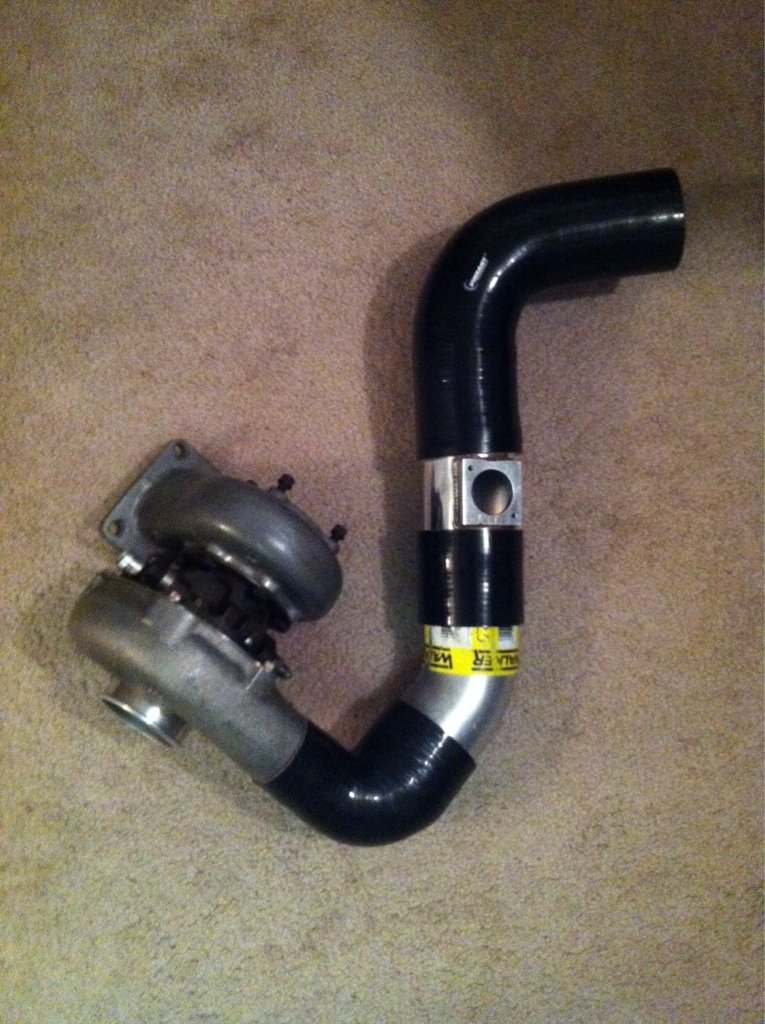

    Gotcha, I'd still be curious to know what your LTFT's are. Pretty much that's exactly what I plan on doing. Have we already talked about this in another thread somewhere? I can't remember. I'm using this Specter MAF kit I found that's lets you change out inserts to adjust the diameter of the MAF housing. The aluminum housing is 3", and has 2.75", 2.5", and 2.25" plastic inserts. Believe stock is 2.75", so the 3" should match up nicely to the green top injectors found in the non-turbo Supra motors.

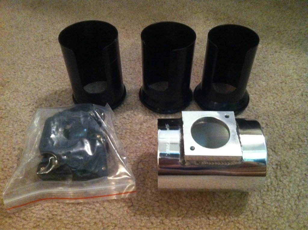

    Got the rest of my intake last week. Whole thing should look something like this:
    I found some of the green top injectors at the local pull-a-part. Found them in a Toyota Cressida, which shares the same motor as the Supra. Lucky me, some one got to the motor before I did, and took the entire top end but left the fuel rail and injectors placed neatly to the side.
    Thanks for letting me piggy back off your build thread, I should probably get around to making my own, lol.

    No prob dude. That intake pretty much looks exactly as I imagined... sexy that is :D
    not too fond of the specter MAF kit because I have the old school one piece solid MAF. It will be a lot easier to have the truck run lean right now and richen it up to where it needs to be with the additional injectors (in my case anyway). It sucks that we have to wait for the ECU to learn and work around mods to make the final adjustments but that's toyota for you. Never discussed this before I don't think.
    And by the way how are you going to fit the downpipe to that exhaust housing on that turbo? Do they make a small profile 3" Vband adapter or something? You only have about an inch and a half to work with in some spots before the downpipe hits the firewall of the truck.

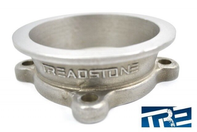

    I've got one of these from Treadstone Performance sitting in my box of turbo related parts:
    http://www.treadstoneperformance.co...-Band+Adapter,+4+bolt+(T31)+2.5"+to+3"+V-Band
    It could be a little tight, but hopefully it'll work. If not, I might be hammering on my firewall lol.

    If your exhaust housing is similarly sized to mine then you should be fine with this adapter. Of course a 4Runner firewall could be different than a Tacoma one and everything being said about it here is for nothing lol
