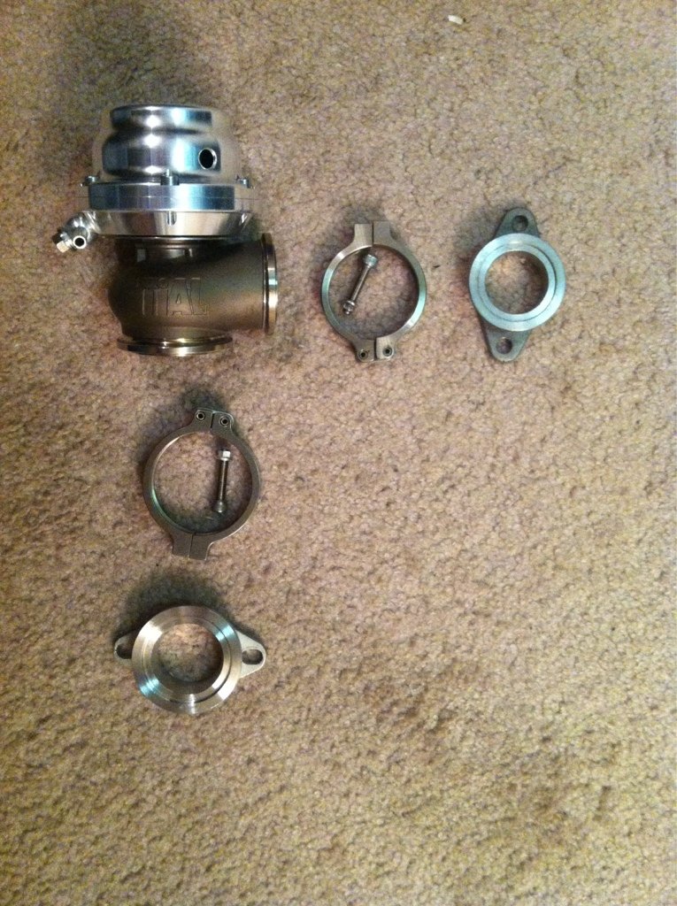

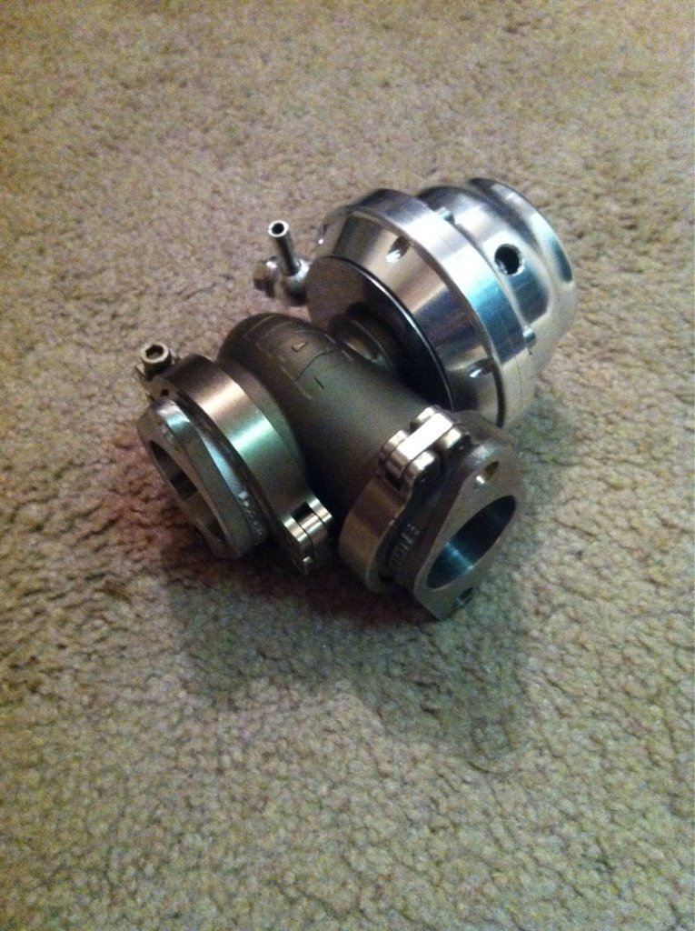

    I would say yes there is a good probability that those adapters would cause it not to fit, because I had a hard time getting my wastegate dump pipe on just from the gaskets spacing the thing out. BUT you don't know till you try. I'll try to snoop around mine today to figure that out for you for sure.

    What did it conflict with? The downpipe?

    Intake, exhaust, lift. Typical stuff.
    Yeah I hear you. Its why Im taking my time to do this right. You can always get an oil-less turbo btw :thumbsup:
    It might but it will be tight, the waste gate down pipe dosen't have a lot of space iirc if you are refering to the CX kit.

    I may end up chopping off the 2-bolt flange from the CXRacing header, and have someone weld on a vband flange instead if it comes down to it.

    Yeah. Don't worry about it until you get the headers though... I'm assuming they are all a tiny bit different considering they're made by hand.
