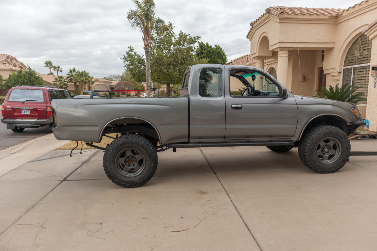

  10. Jun 6, 2018 at 8:53 PM
    #30
    LuxurySport
    LuxurySport [OP] Well-Known Member
    May 11, 2018
    #253220
    54
    1996 Tacoma Extra cab

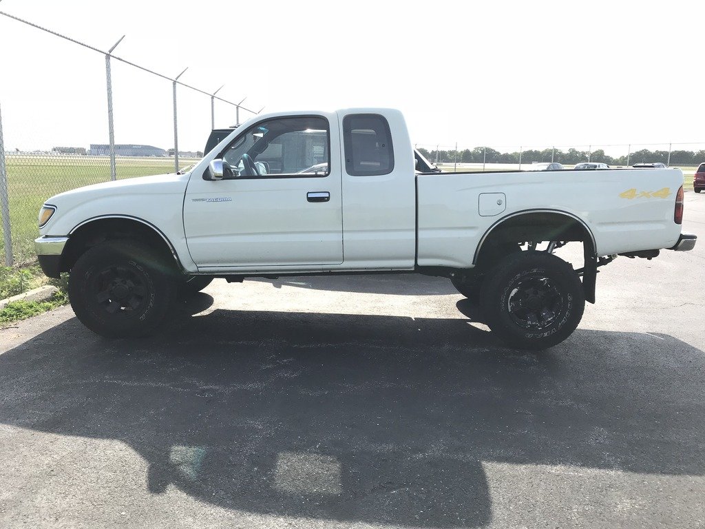

    Here's how she sits.
  11. Jun 6, 2018 at 9:35 PM
    #31
    Kiloyard
    Kiloyard Road Warrior
    Oct 28, 2017
    #234330
    1,031
    John
    Phoenix, AZ
    1999 3.4L SR5 4X4 410K miles
    Toytec Boss/Eibach Coils & Deaver J59's
    Yeah that's pretty darn high. I can see daylight between the bottom of the frame rail and your tire. How tight is your rear brake line?

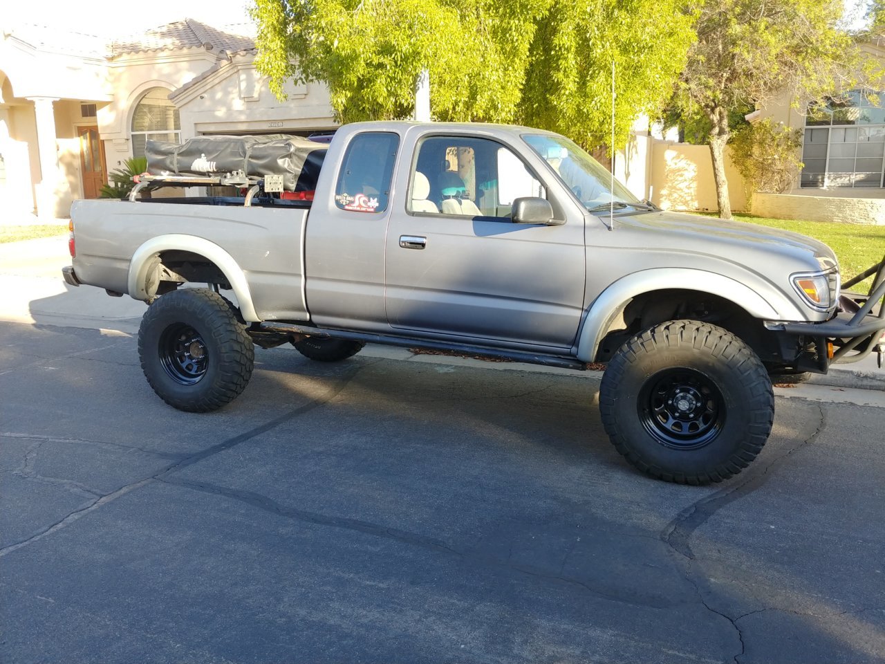

  12. Jun 7, 2018 at 7:29 PM
    #32
    LuxurySport
    May 11, 2018
    #253220
    54

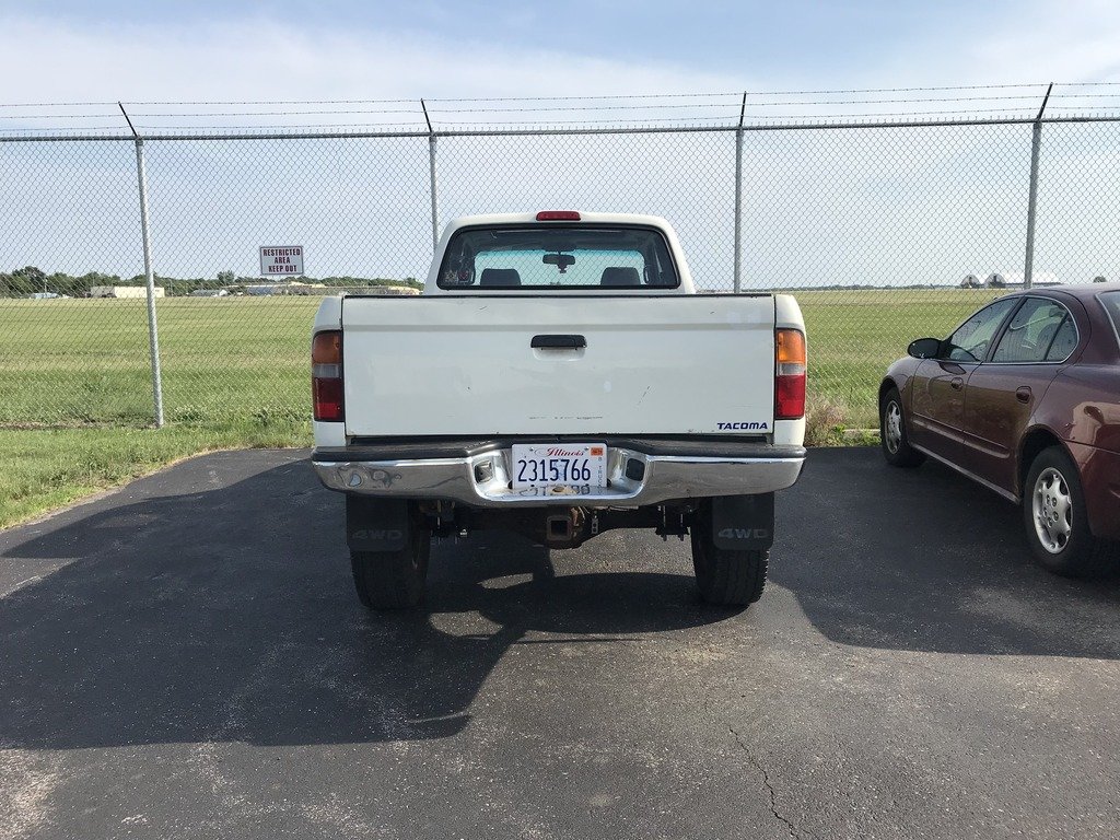

    Not in this picture but went out and bought some sandbags ~280lbs and set them in the bed across the axle to help with the settling process (hoping atleast).
    Here is another picture of it sitting on a flatter surface. Its pretty high.

    Phoenix, AZ
    Well, I hope I didn't give bad advice about that. It doesn't appear to have dropped much. Does it ride better with the added weight?

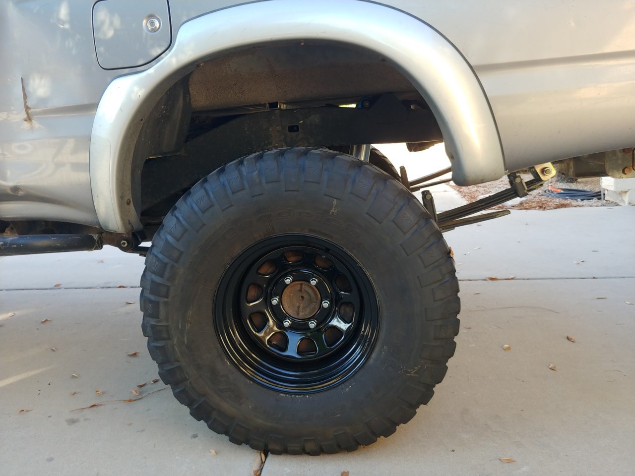

    Haha 280 ain't enough to make those settle any, I get about 600 before it becomes pliable.
    That's with about 200lbs if tent and hilift
    Loaded down it still can hold it's own...
    Exact same leafs you have
    Here's when I first put them on...
    Dalandser and Kiloyard like this.

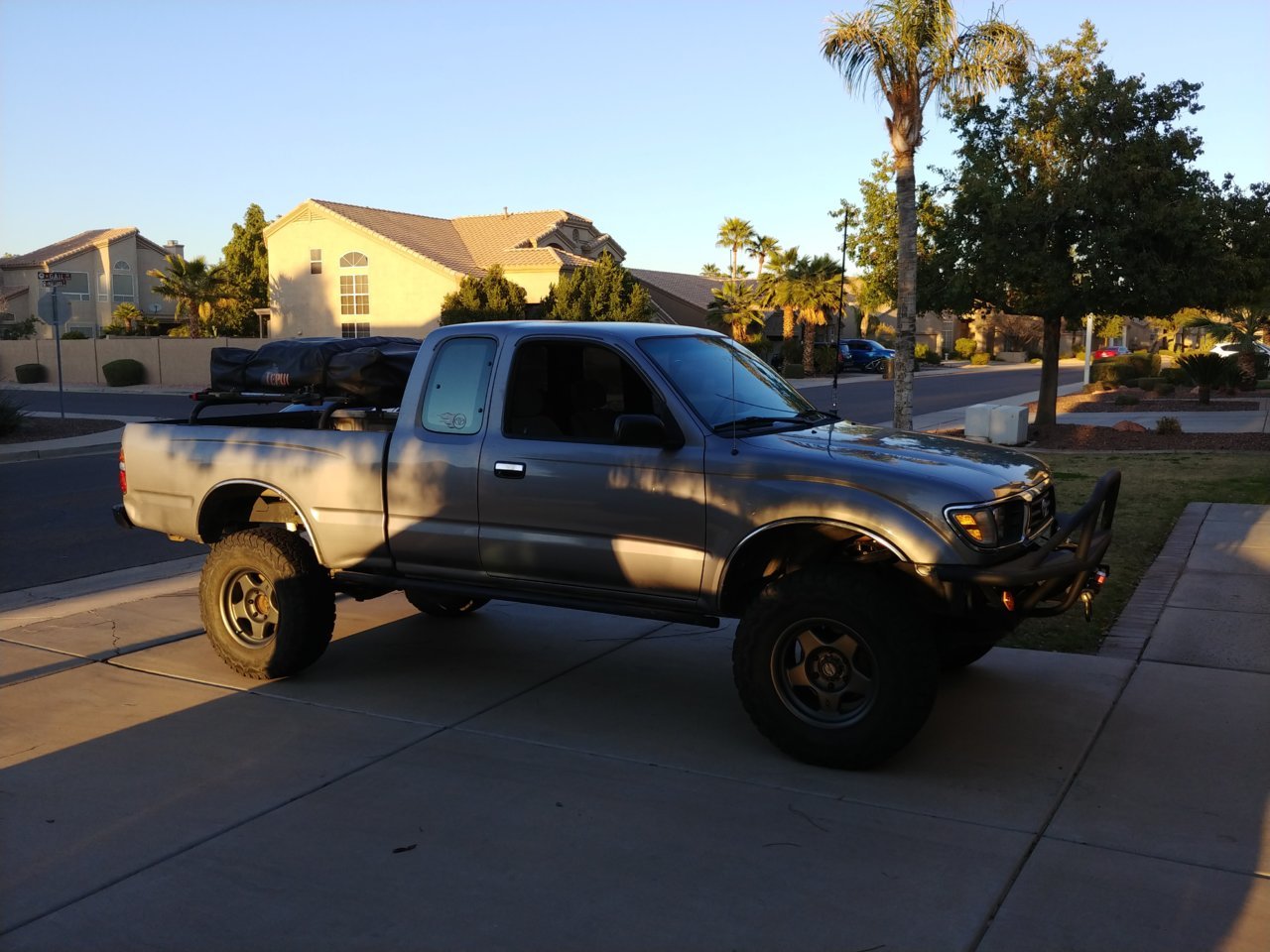

  16. Jun 7, 2018 at 7:50 PM
    #36
    LuxurySport
    May 11, 2018
    #253220

  19. Jun 7, 2018 at 8:13 PM
    #39
    Speedytech7
    Feb 20, 2014
    #123587
    58,107
    FCQM+VG Cheney, Washington
    It's less Tacoma and more mod

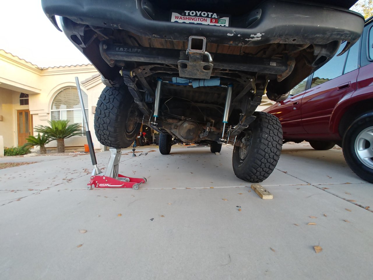

    Yeah they don't wear down much which is good, but unless you carry a lot it's hard to match the lift well. I have about 2.0-2.25" of lift in the front on icon coilovers.
    Here's a more current pic.
    It matches pretty decently right now when loaded for camping and rides with some stinkbug when unloaded.
    Those leafs are capable...
