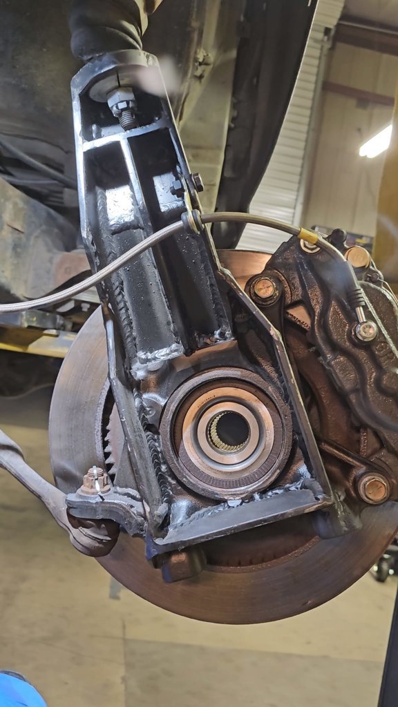

    Your continuing the tradition. In all the shit that rig has done between me and you it's never been a trailer queen. It has been on a flatbed once but I didn't quite trust driving a field repaired lower link home 280 miles on the highway. lol
    As far as welded spindles go. Yep, just remove the LBJ nut and pop the LBJ loose. This makes short work of it.

    Ahhh carrying a ball joint separator would be the ticket.
    I was trying to work out how you would get it out because I have about a 75% chance of destroying the bolt or nut threads when I get impatient and beat it out with a hammer

    I'm curious on the welded spindles. I bit the bullet on the TC heim uniball conversions. Looks like if they were welded to the spindle I could possibly still press in new uniballs. Not sure if that’s totally overkill though.

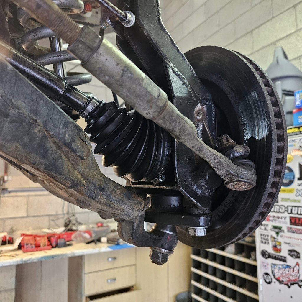

    I do think a big thing that contributed to my failure design wise is the steering stops that contact the LCA are on the ball joint that is bolted to the spindle. Same for the steering arm, it is attached to the ball joint that is them bolted to the spindle.
    If these were a part of the spindle I feel like it would be a lot tougher so either nothing would happen or that spindle would be destroyed if I hit it hard enough. , exactly what i needed to make me circle back around to thinking about this.
    tundra spindle LBJ adapter doesn't seem to push the tire up as much as i thought, but the camburg arms i have would hang down pretty low compared to these stock ish ones.
    the steering arm does sketch me out, wish I could come up with a better option then just weld the hell out of it. Maybe machine a LBJ adapter to take a uniball and build the steering arm in it as one piece to get machined? but then I might be in the same place just shearing off those two big ass bolts instead of four tiny ones

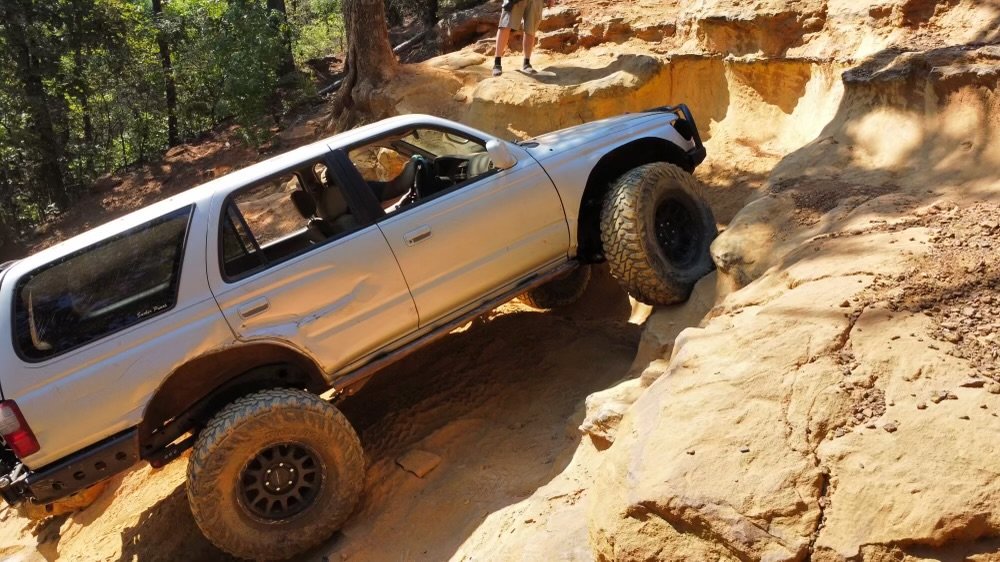

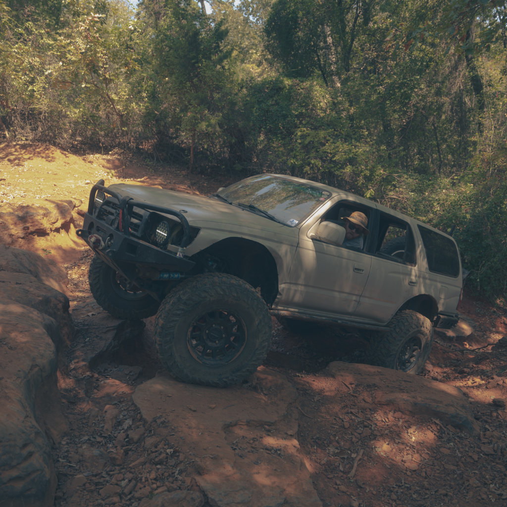

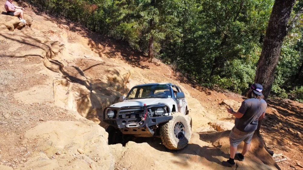

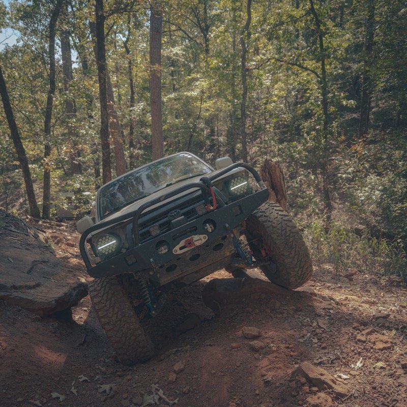

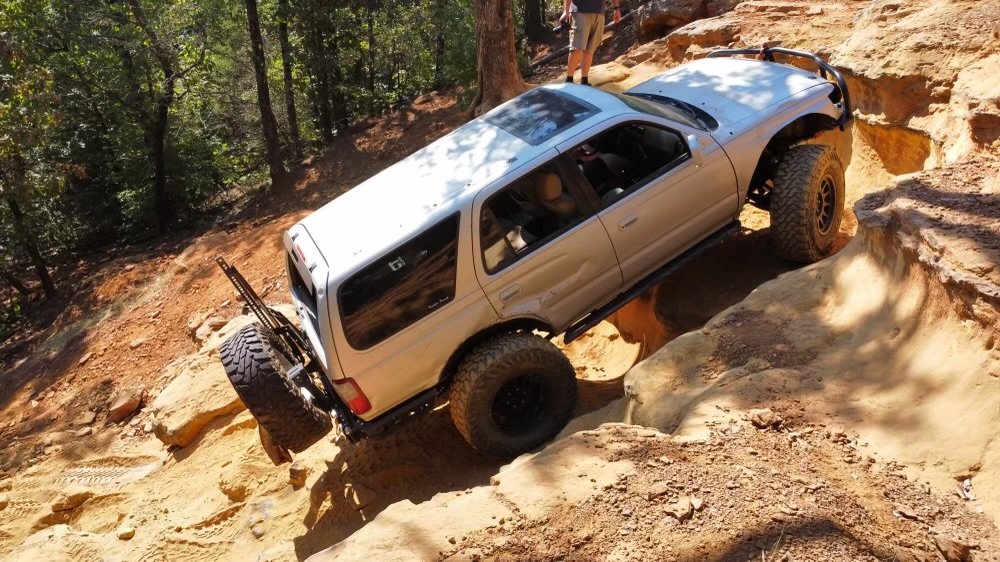

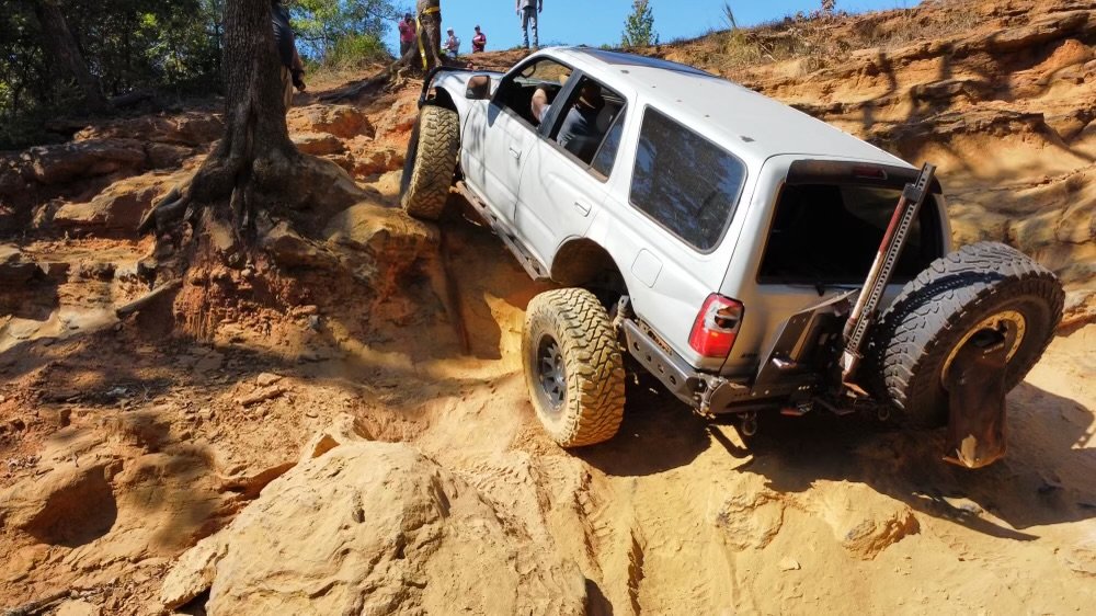

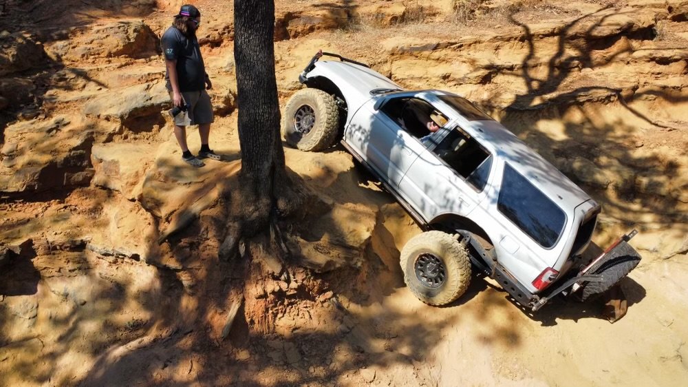

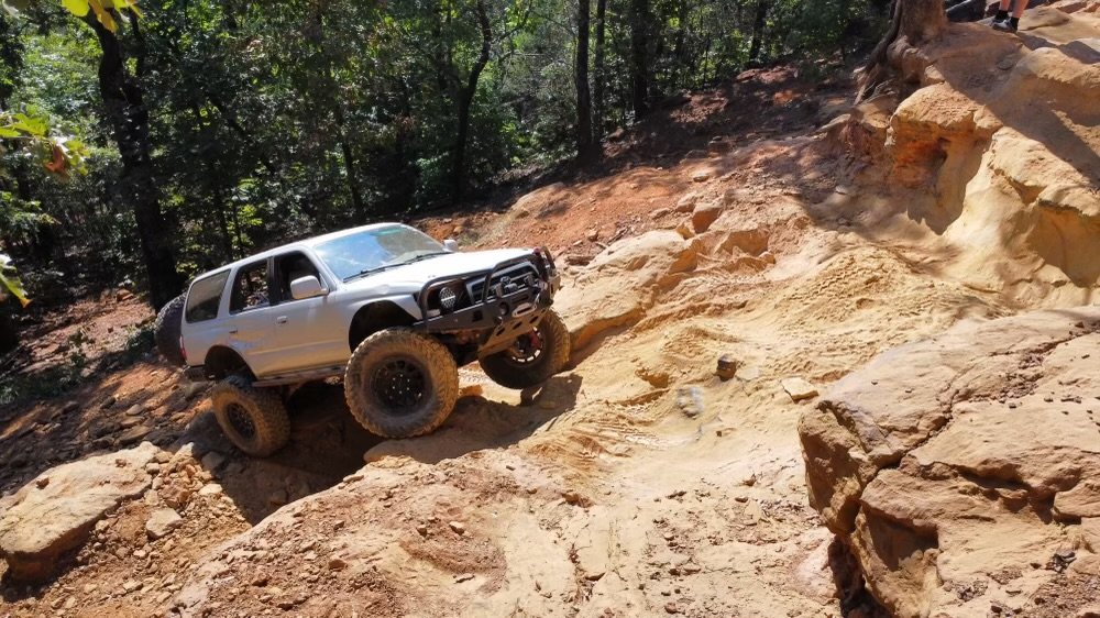

    Another trip in the books.
    drove a trail for the first time that I got denied on every time before with 35s.
    played around on a big obstacle that to my knowledge only one other ifs rig has done, but I couldn’t get it.
    May have to try again when there isn’t 6” of moon dust covering everything. I thought maybe it would help being so dry once I spun the dust off the rocks but it was slick once it covered the tires
    Didn’t break anything glaring which is a win but I turtled a few times on the tank and the driveshaft is all scuffed up. Doesn’t seem bent atleast. Also looks like I cracked the frame in the very back where the bumper mounts on the passenger side. I kept backing bumper and diff into a rock and pushing through it when trying to shimmy over so I figure it happened then.
    I’m really just using this as and excuse to post drone pictures someone got though so here they are haha

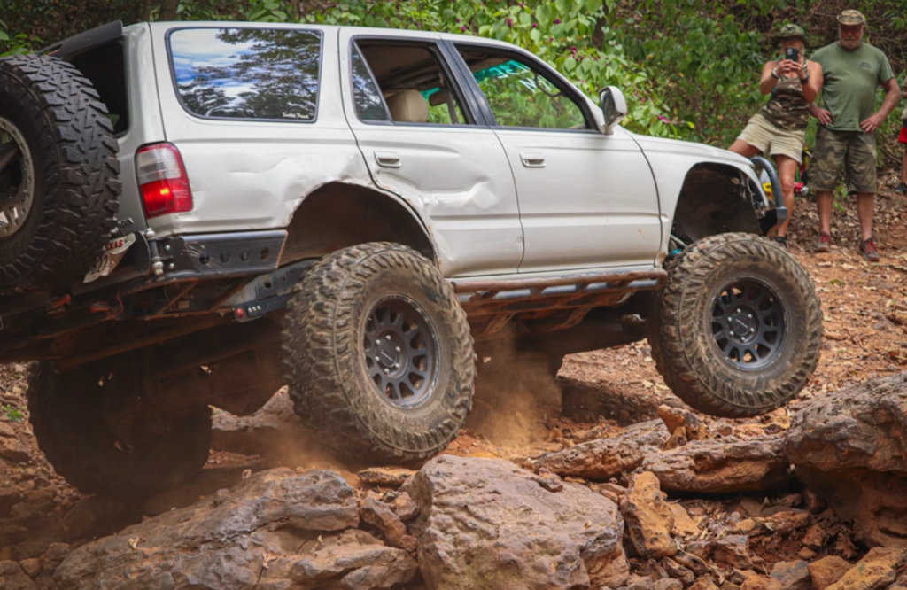

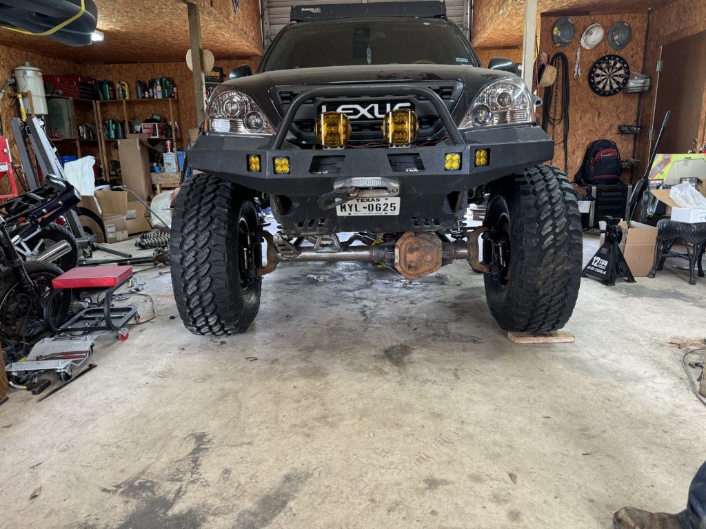

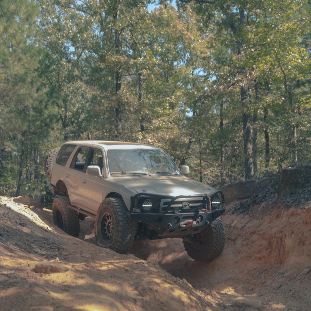

    Few more uneventful trips down.
    and helping with a friends project
