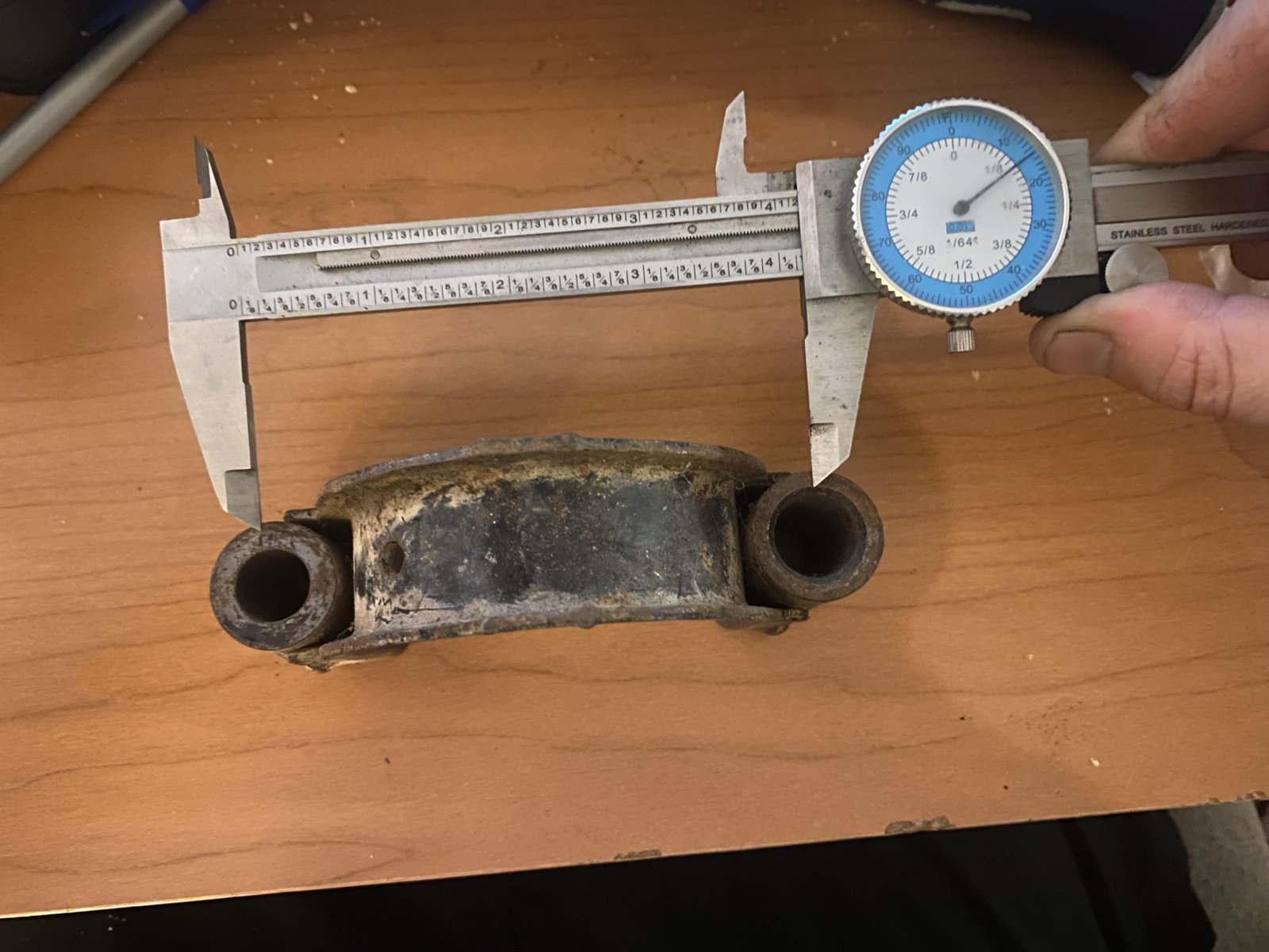

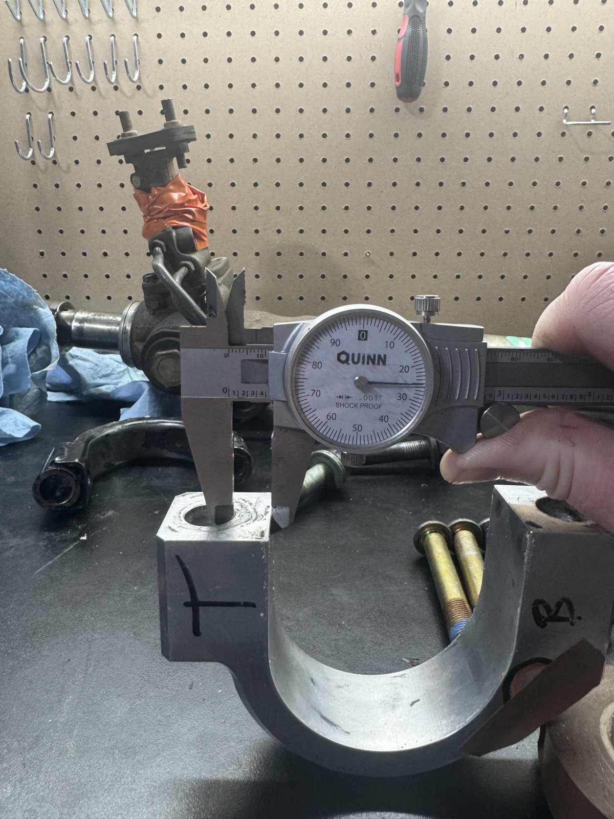

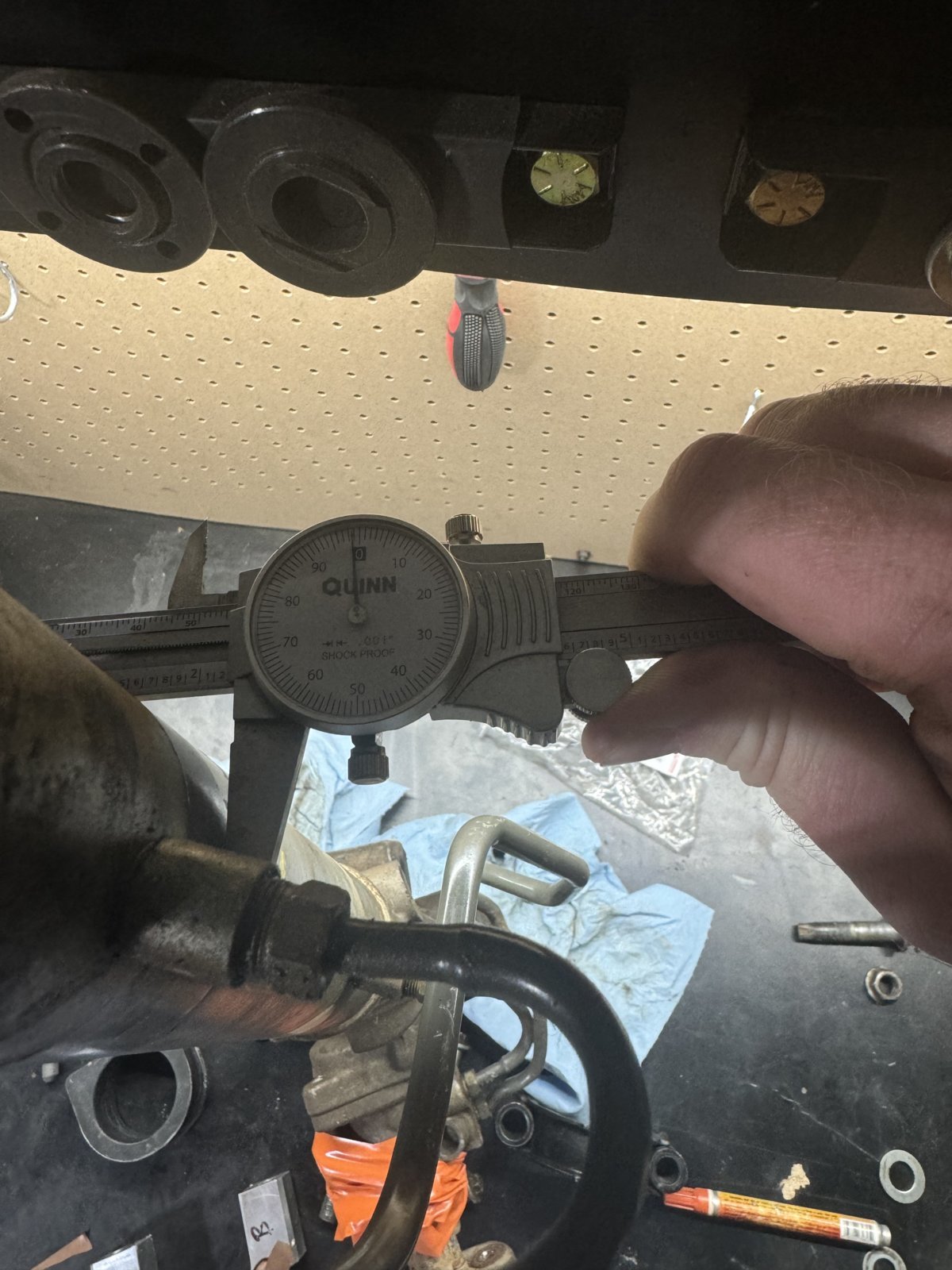

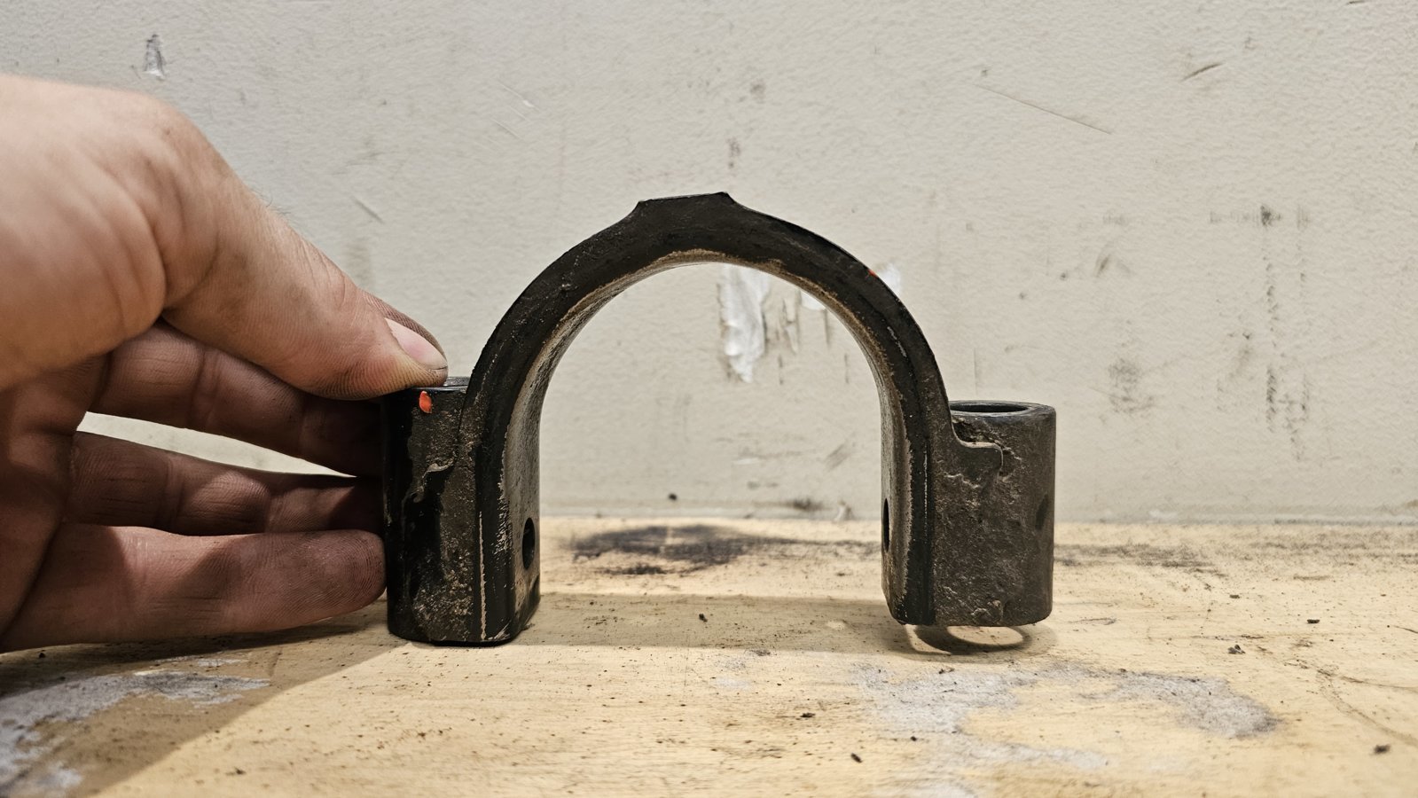

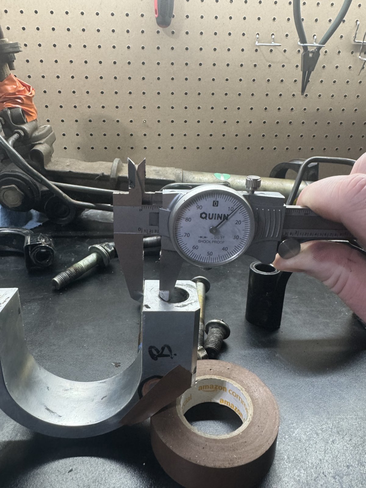

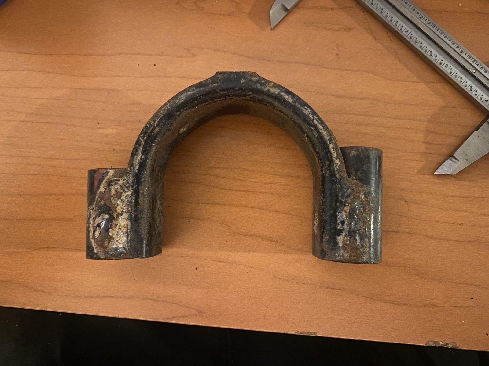

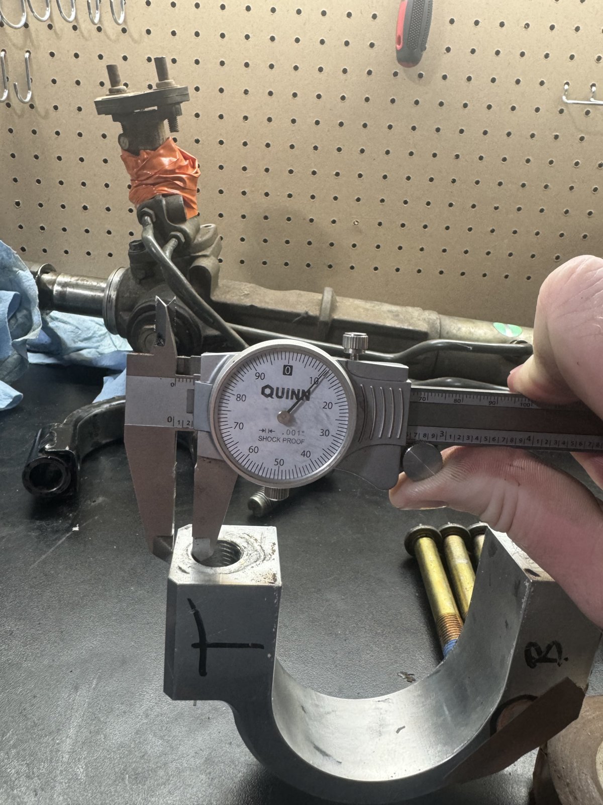

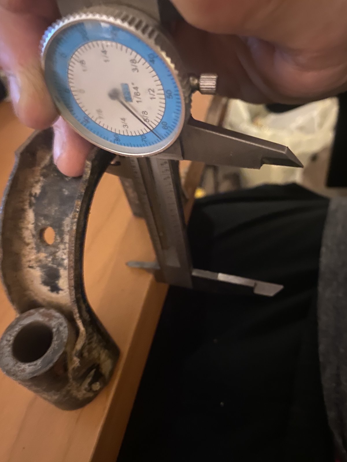

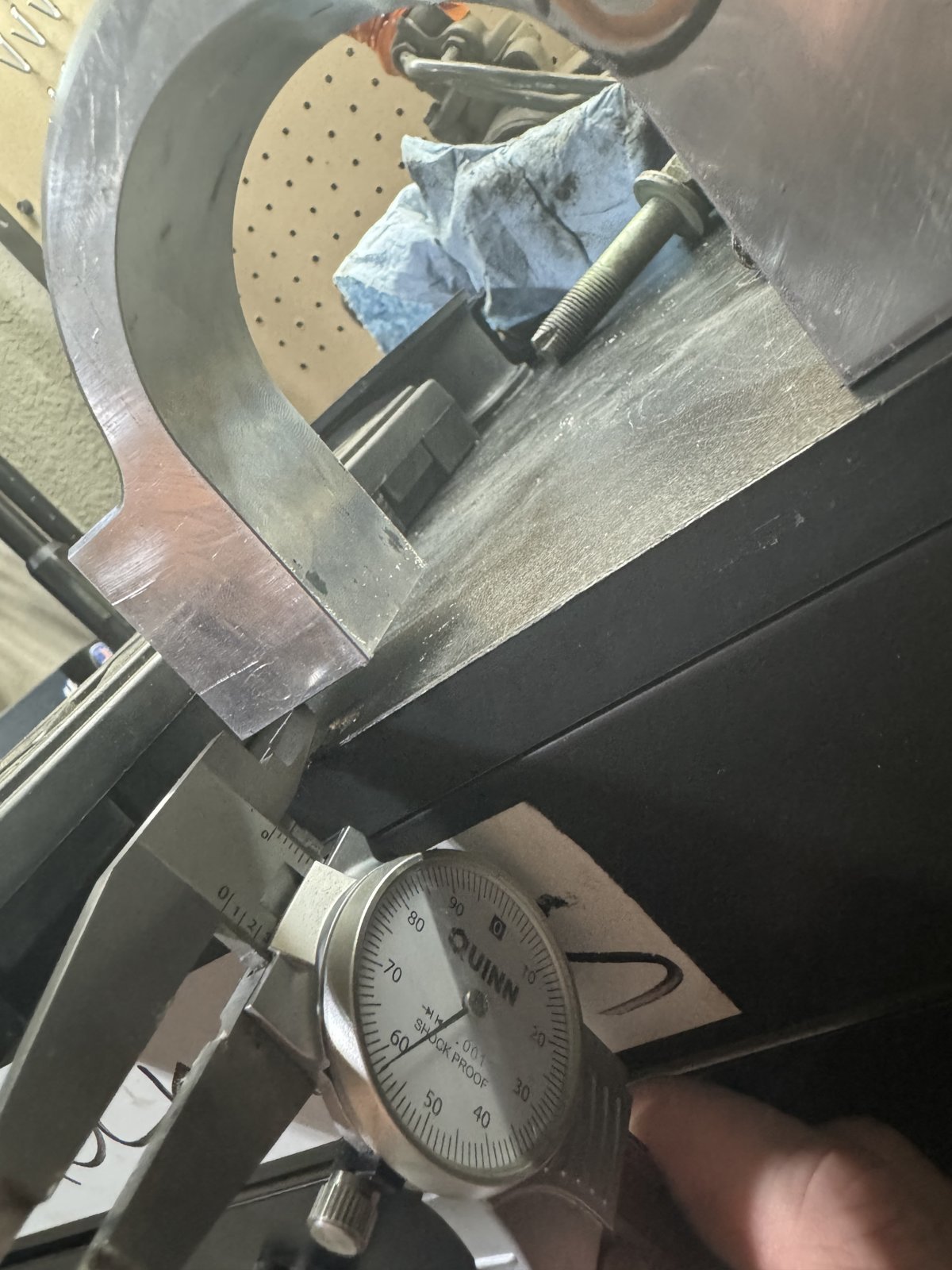

    Can you grab me this dimension on both ends? I need to know where those holes are positioned in the part length-wise. I'm assuming that they're centered width-wise.
    Also, do you have a 3d printer by chance? I could send you the files to print and do a fit check on while you have things apart.
    Also looking for this height. Although given yours is bent, it's probably not accurate to what it should be. A measurement off of the new OEM clamp would prob be better for that one.

    Will do tonight.

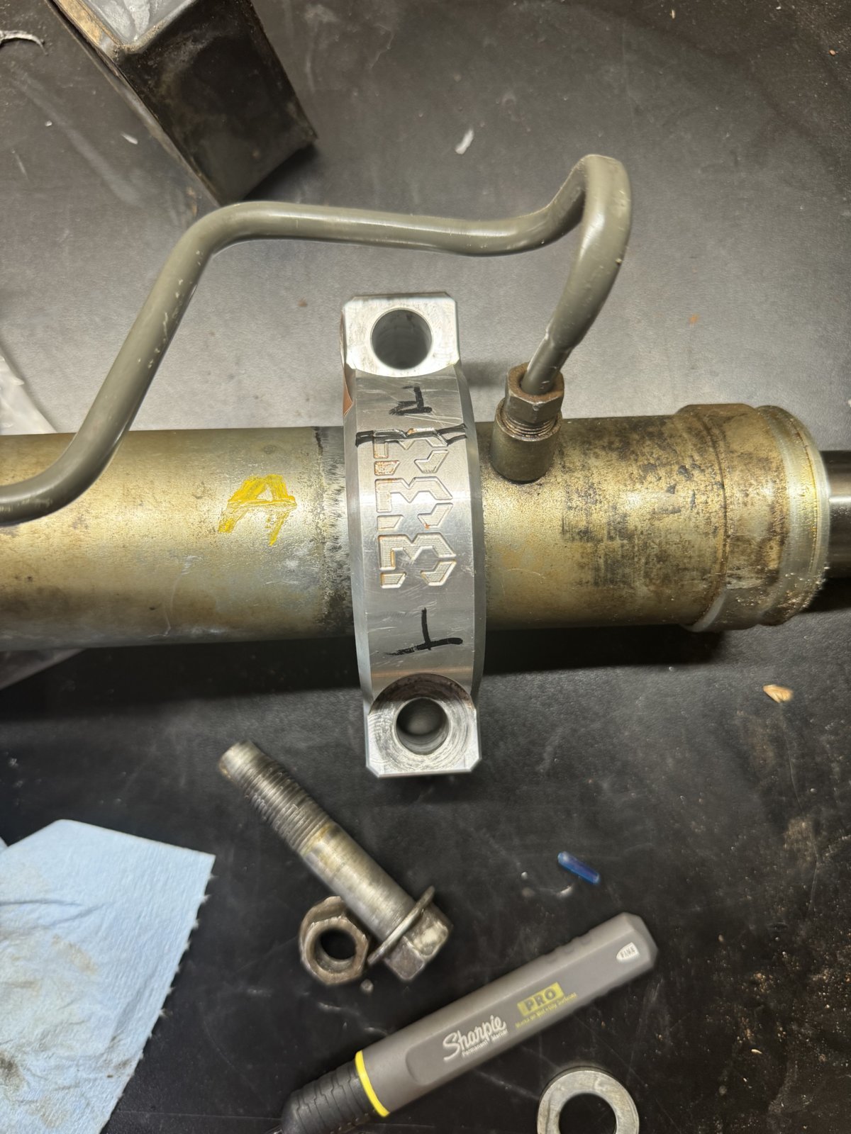

  3. Jun 17, 2024 at 8:36 PM
    #123
    JTFisherman
    JTFisherman [OP] Well-Known Member
    Feb 19, 2019
    #283636
    1,638
    Jake
    Texas / Missouri
    4Runner

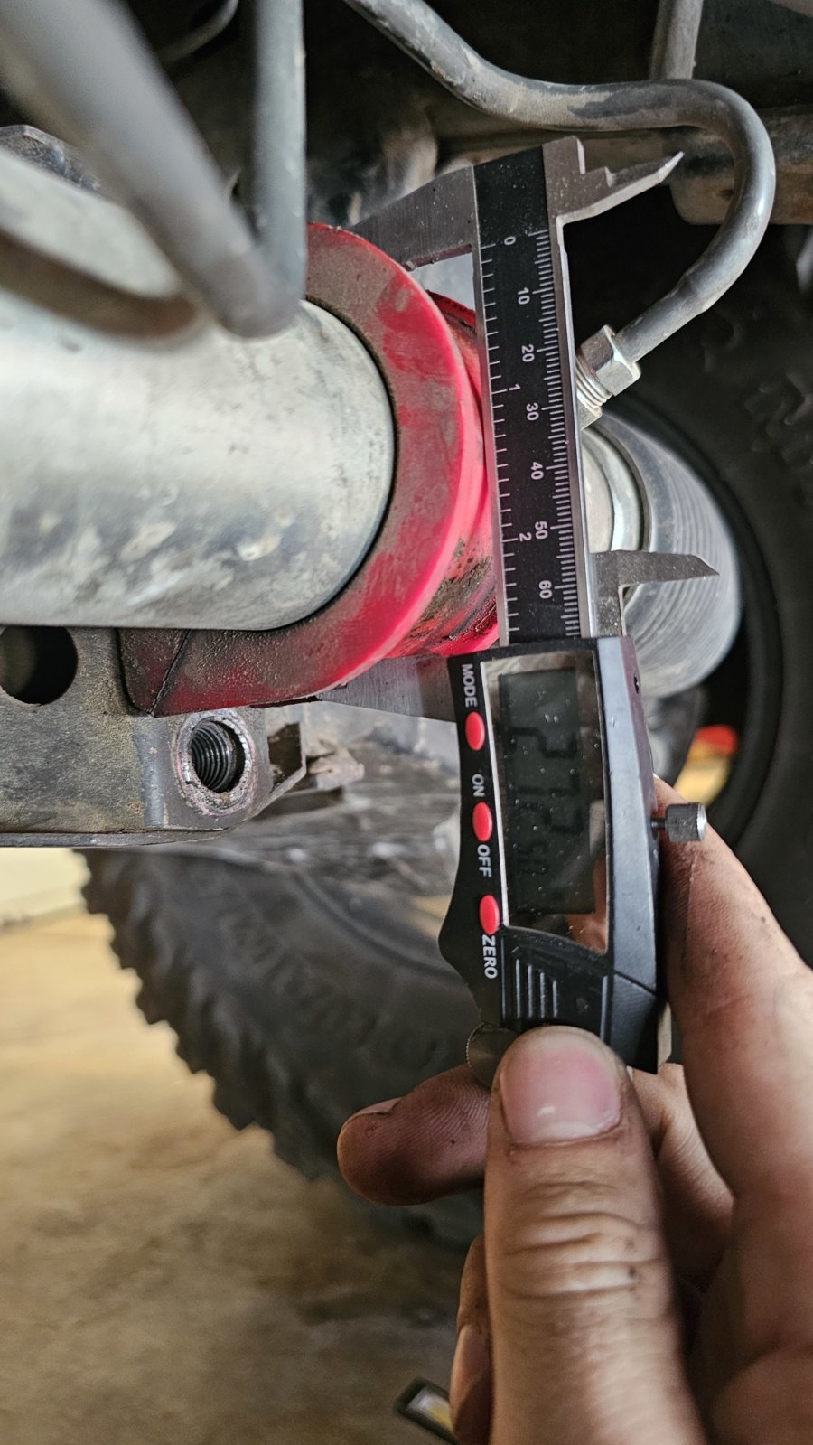

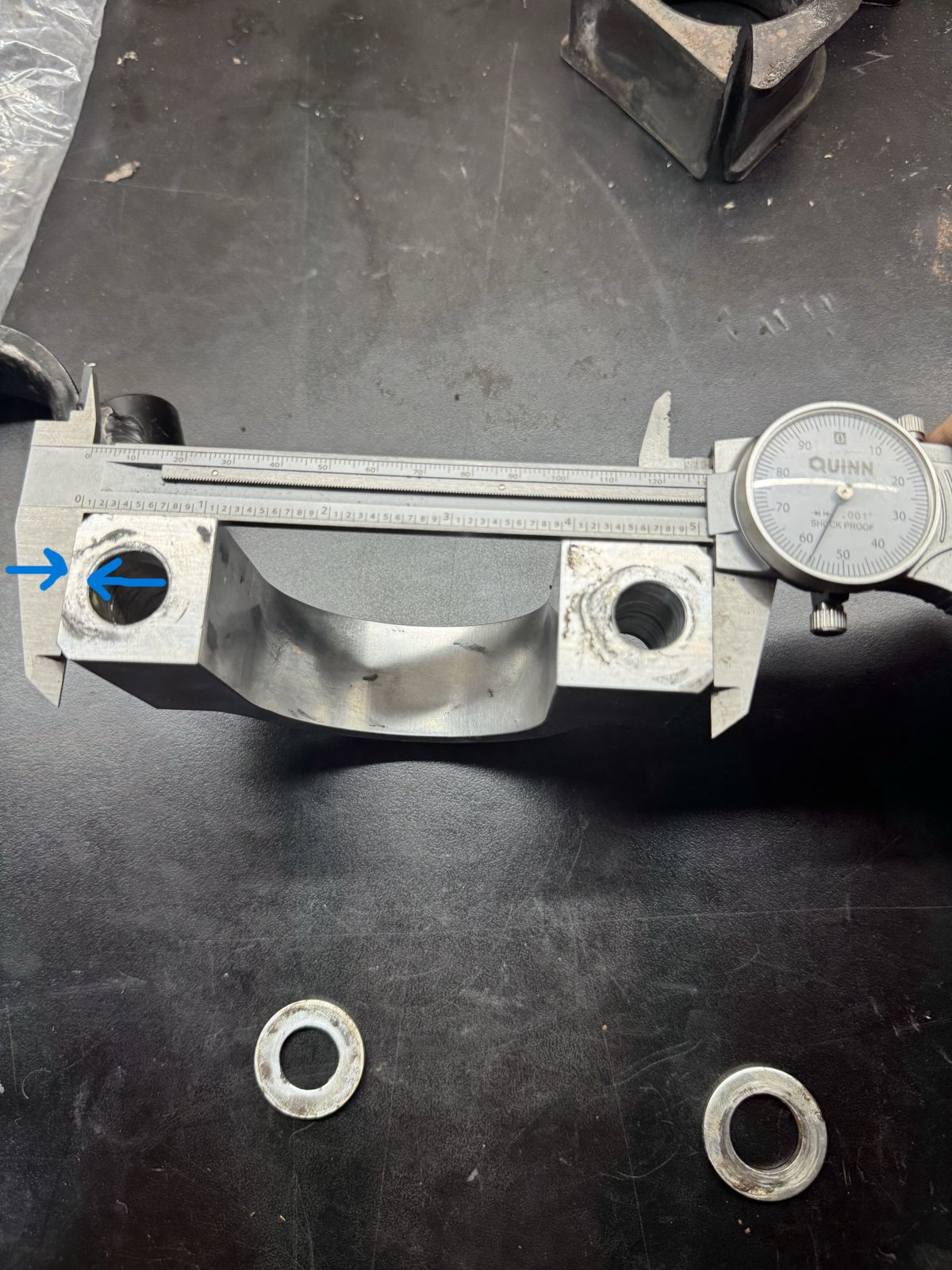

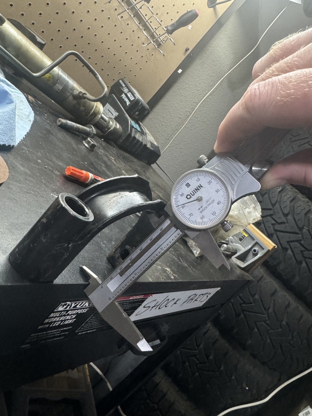

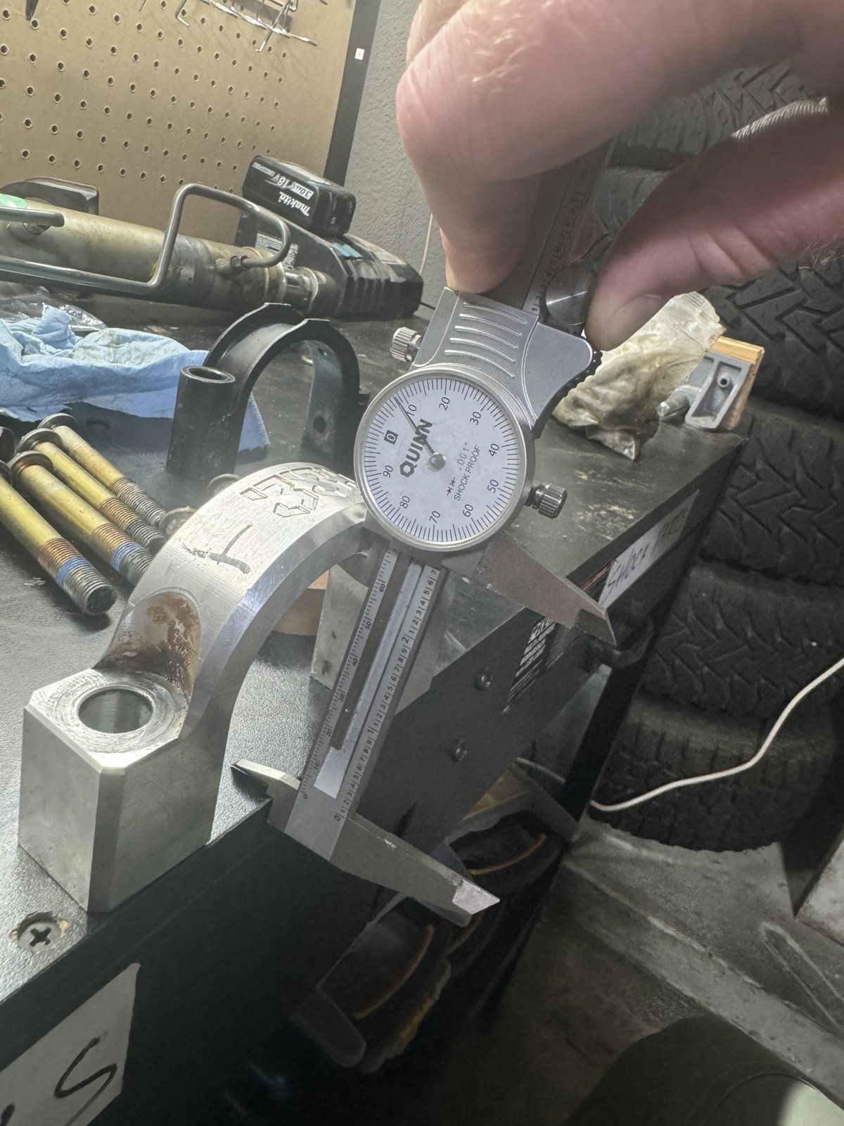

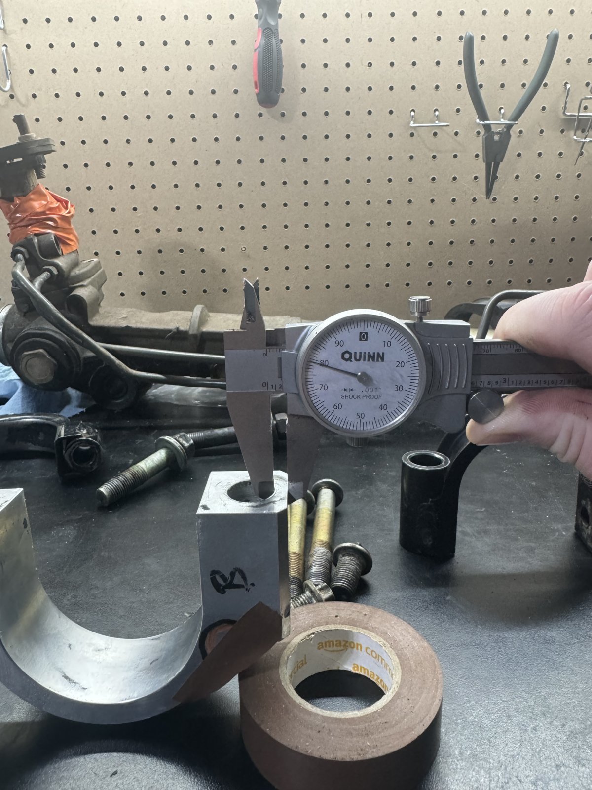

    Edit - everything is out of order, I’ll edit later on the computer, you can probably figure out most of it.
    As I think about this more, it could be interesting to just do away with the bushing all together and make that billet aluminum mount interface straight with the rack. Would be easy to add some beef to it by leaving all the dimensions the same other than brining in the ID but you would have to do some funny business to get it in place over the fitting. Maybe you could cut a slash in it and get enough flex to go around the high pressure fitting on that side and just bolt it back together?
    this measurement (img_8554) could be a bit off from galling on aluminum from threads
    Rack OD
    this measurement seems better to me, worst case if this is tight it just clamps to frame harder
    If you make this all aluminum and ditch bushing, you could fully enclose the rack and maybe just slash it here to fit over the high pressure hose and bolt back together?
    Or at the center of where the aluminum is thinnest between rack and frame you could just take .5” out for a gap, it would still be hard to flex over the ridges at the end of the rack for retaining the boot but you can also sand those down.

  5. Jun 18, 2024 at 11:40 AM
    #125
    betterbuckleup
    betterbuckleup Well-Known Member
    Jun 26, 2017
    #222483
    4,831
    Ian
    Concord, CA
    2000 Tacoma SC 2.7 4x4 5spd
    Thanks for the pics.
    If I was to design a solid mounting bracket eliminating the use of brackets, I would do it with a 2 piece design so you didn't have to deal with hydraulic fittings or any of that. Not a bad idea, although I would worry about making things too rigid and then translating forces into the housing of the rack at that spot.
    Lately I have been pondering the idea of making replacement bushings out of delrin or a similar material. My initial thought was to make the two driver side bushings and then leave the D-bushing poly.

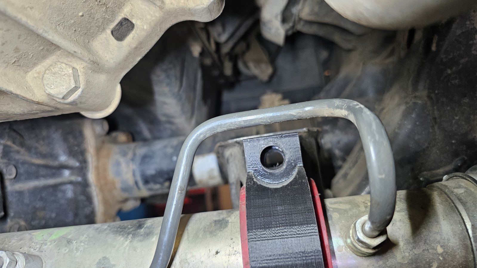

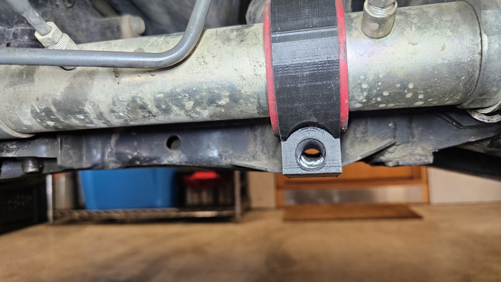

  11. Jul 15, 2024 at 11:05 PM
    #131
    betterbuckleup
    Jun 26, 2017
    #222483
    4,831
    Ian
    Concord, CA
    The 3D printed clamp is really tight around the bushings. I can't get it over the bushing without the two ends spreading apart. Not sure how much of a tight fit the metal one is over the TC bushings, I've heard that people have had to use a hammer to get it on....

  12. Jul 15, 2024 at 11:15 PM
    #132
    Dalandser
    Dalandser ¡Me Gustan Las Tacos-mas!
    Feb 19, 2015
    #149090
    17,666
    Anthony
    Downey
    08 PreRunner Regular Cab / 98 4x4 Extra Cab
    Empty Wallet Mod
    My stock clamp slipped right over a TC bushing. If you mean people had to hammer the clamp onto the stud to make it fit, I think people hammering the clamp just didn’t assess which was causing interference; the clamp, the mounting stud being bent if they have one, or the surface of the mounting stud / threaded bolt holes.

  14. Jul 16, 2024 at 8:54 AM
    #134
    JTFisherman
    Feb 19, 2019
    #283636
    1,638
    Jake
    Texas / Missouri
    4Runner
    Does your model have sharp corners on the inside where it interfaces with the bushing? Don't know if TC bushing has a fillet or not but that could help fitment if you match that interface. My 333 is tight but I don't need a hammer with a rubber bushing, just get the bolts started and they pull it all the way on.
    As long as it will bolt up, I think some extra tension would be nice.
  15. Jul 16, 2024 at 11:06 AM
    #135
    betterbuckleup
    Jun 26, 2017
    #222483
    4,831
    Ian
    Concord, CA
    it does have sharp corner currently. Good call, I'll print another and see if that makes a difference. the TC bushing does have a slight radius on the corners there. Currently there is about a .02" interference fit between my measured bushing height and the inner clamp height.
    Also did discover my clamp is bent as well, albeit not as much as yours.
