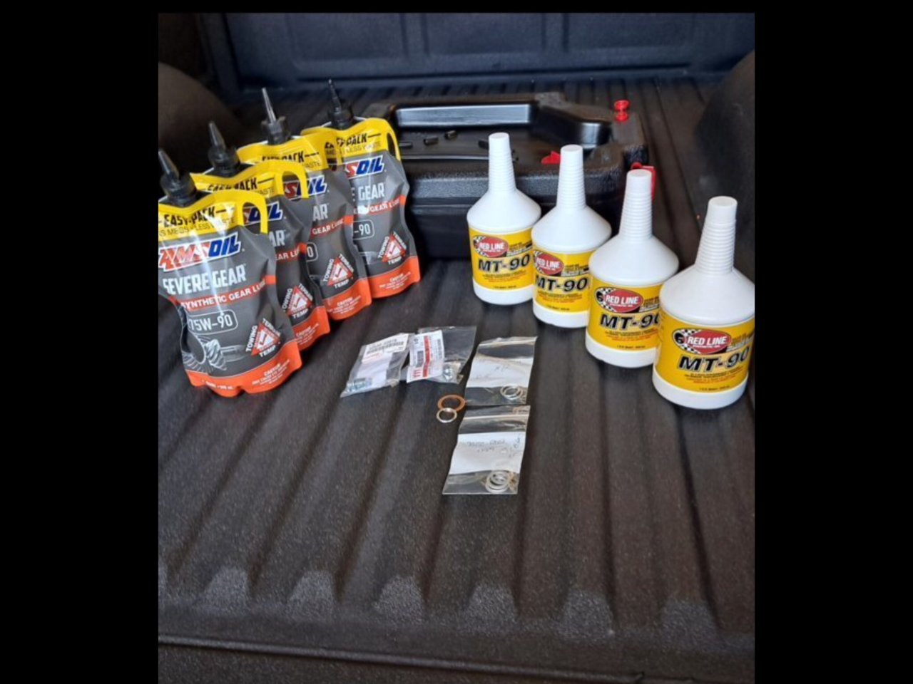

    Hey guys,
    I have a '97 Taco V6 4X4 5 speed with only 135K on it. The R150F transmission is making a whining noise in 5th gear. 1st thru 4th gear is fine. So I run it on the highway in 4th gear to get to where I am hunting then lock the Aisin hubs for the mud. The Taco has been used primarily as a hunting vehicle here in MS in deep mud/water. I am of the opinion that 5th gear/bearings are worn and it is just time to send the transmission to Marlin for rebuild. Any one had the same problem? Thoughts? TIA!

    Putting Redline MT-90 in the transmission is worth a try. The Amsoil 75W-90 I used for many years was WAY better than Mobil 1 gear oil in the R150F 5 speed manual transmission. So I am firmly of the opinion that the type of gear oil used can show a big difference in manual transmission function. Will change the Amsoil 75W-90 gear oil in the transmission out to Redline MT-90 and report if it made any difference.

    OK,
    I ordered the Redline MT-90 online since I could not find it locally. It arrived and was put in today. I test drove the Tacoma on the Interstate with the Amsoil 75W-90 GL-4 Gear lube in it, changed the transmission lube to the Redline MT-90, then test drove the Tacoma over the same course at the same speeds. The Amsoil in the R150F had been in there for 3 years with probably 6-7K severe OFF-ROAD miles on it. 5th gear is noticeably quieter especially under full throttle with the Redline MT-90 and the synchros are working noticeably better thru all the gears. I am sure some of this is simply due to having fresh high quality GL-4 gear lube in the transmission. But I have to give the Redline MT-90 a thumbs-up. It made a noticeable difference in the overall function of my 24 year old gear box. Will take the Taco OFF-ROAD this coming week then make a final decision as to whether to pull the R150F, separate the transmission from the transfer case, then ship the transmission to Marlin for rebuild this summer or let it go a bit further.

    Looks like some crush washers there. Where can I look up the parts I'll need to do the trans, diffs, and transfer case oil changes? I didn't see anything about it in the owner's manual. Also what diameter tube will I need to pump for the brake flush?

    I use clear vinyl 3/8" tubing.
    https://www.amazon.com/dp/B07CJHTDVV
    Replace the rear differential breather while you're down there. 13mm box/open wrench
    https://www.amazon.com/dp/B00NF1SLT8

    I got the washers from the dealership.

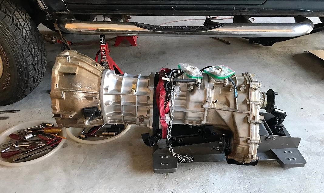

    Even a top-shelf synthetic gear oil such at Redline MT-90 or Amsoil will not fix a sick transmission, but the Redline MT-90 definitely helped me limp along in the Taco for one more year/approx. 200 days of hard wheeling while hunting/shooting. In 2022, my R150F 4x4 tranny took the trip to Marlin on the West coast for rebuild. My tranny was much more sick than I realized. Besides all the normal wear items such as bearings/seals/synchros/etc. that were replaced, the tranny needed an output shaft/2nd gear/3rd gear/1-2 sleeve/and 3-4 sleeve. The tranny is still going thru the 10K mile break-in period with LUCAS 80W-90 dino oil and is surprisingly smooth in all gears even with the dino oil. Just returned from a day of shooting/wheeling on our local WMA and my tranny is very quiet and pretty smooth. But I do very much look forward to the day that I can put Redline MT-90 in it. This tranny should be impressively smooth with MT-90 in it. Marlin warned me not to put any synthetic gear oil in their build until the 10K break-in period is over because the synthetic gear oil will inhibit any further break-in.
    Marlin rebuilt R150F 4X4 tranny ready to reinstall in 2022:
