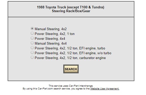

    86-88, what truck? I didn't say I was going to use it as a 30 year old salvage part, but rebuilding a box is just *not* hard. Nor is tapping holes. But I do need to know *which* 86-88 trucks it comes from. :)
    I pulled up car-parts.com for an 88 Toyota Truck (not Tacoma or T100). My choices are:
    Yikes!! Little help, please? Clearly the manual boxes are out, so that's about a third of them I don't have to deal with. But 4X2, 4X4, 1/2 ton or 1 ton? I don't know what, if any, the differences are between them back then. To be honest I'm a little surprised Toyota had a 1 ton in 88.

    Any power steering box from a 86-95 truck or 4runner with IFS and 4wd is what youre looking for. Pre-86 used a push-pull type box and is what most swap out for the IFS boxes when converting to hi-steer.
    burntkat[OP] likes this.

    Outstanding. This is the kind of info I was hoping for.
    I understand it's likely been mentioned many many times in the past, in several hundred page build threads. But I could not find it. I was overwhelmed by results, none of which seemed to say 'this is what you want'
    I am going to be using the trail gear frame plate kit so that will of course be a factor in what I go with. It sounds like the last post is the one I want.
    EDIT: this is the frame reinforcement kit I refer to - http://www.trail-gear.com/product/4994/tacoma-frame-plate-ifs-box-mount-kit
    It seems to jibe with what he said, except it specifies 86-95 Hilux. I thought those weren't available in the US?
    Again, many, many thanks for the information, folks.
