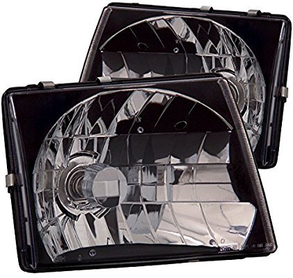

    But, has anyone tried taking a pair of these:
    https://www.amazon.com/USA-121139-T...s=Anzo+Tacoma+Headlight&qid=1578198578&sr=8-4

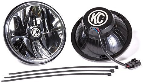

    and mounting a 7" round LED inside them?
    https://www.amazon.com/KC-HiLiTES-4...eadlight&qid=1578198741&sprefix=KC+7+I&sr=8-5
    I think optically it would work great, but the trick would be mounting the lights solidly. You'd probably have to cut up the housing of the anzos. But it might be totally worth it, assuming it didn't look awful.

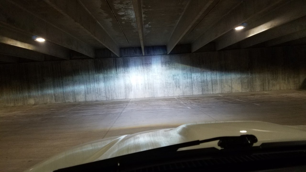

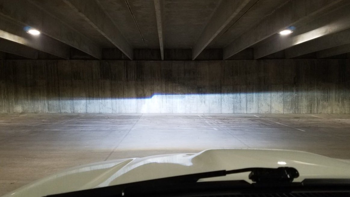

    The led or hid lights can and do put out a lot of light BUT it’s about how the light is projected .
    The common scattered LED and HID light are very dangerous if not controlled correctly.
    I had HID in a halogen lens which work great if you don’t care about the on coming cars.
    The super dangerous situation with this setup or any other scattered LED OR HID setup is if you get caught in fog or a heavy snow storm the bright lights will reflect back on you and you will not
    be able to see 100 feet or 50 feet in front of you. Ask me how I know :)
    The head light setup is about the light out put and the reflector lens and the controlled footprint.
    If you have a scattered light pattern which is common with the cheaper setups your asking for problems
    and will have to buy another setup.
    Lookup reviews on any setup you buy with real photos and fog and snow scattered light if possibly.

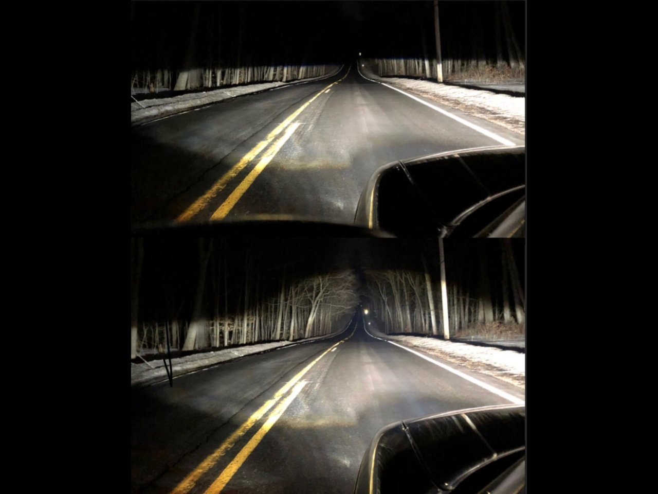

    This is what happened to me 2 months ago, was snowing crazy with those big fat snow flakes.
    I seriously could not see 50 feet, maybe 30 feet, in front of me going down the highway at 30mph, that’s a 65mph highway with no place to pull off.
    In all my miles of driving this was the scariest situation I’ve been in before White knuckling it for 20 minutes like this.
    That was it, those old lights regardless how bright they were for regular night driving, they were going.
    I’m not saying a projector light is for you but a projector light
    is controlled and doesn’t go above the 30” on low beam with zero scattered light or so and will not have the issue I had before as shown with this low beam photo
