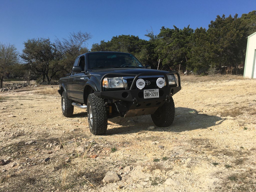

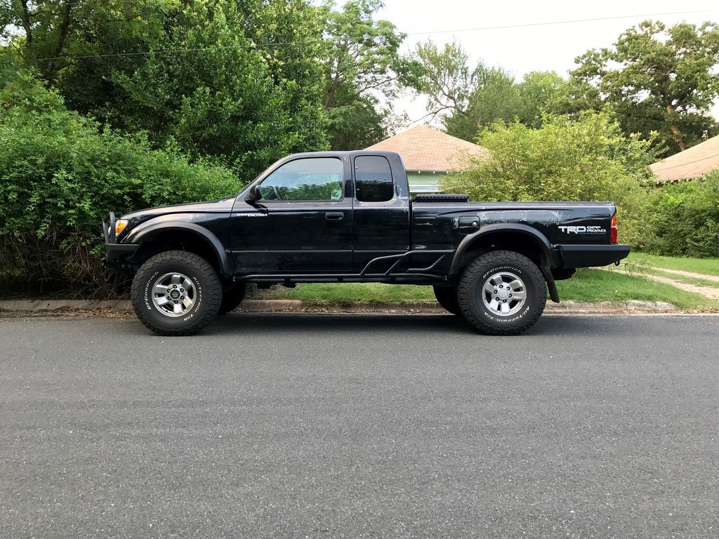

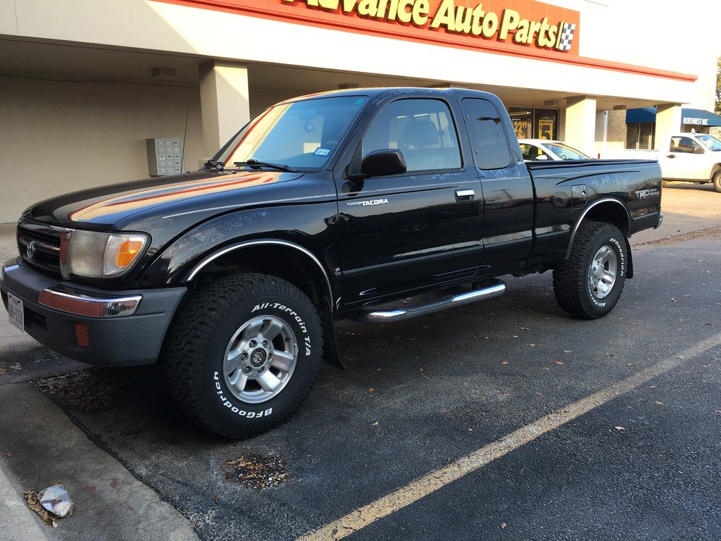

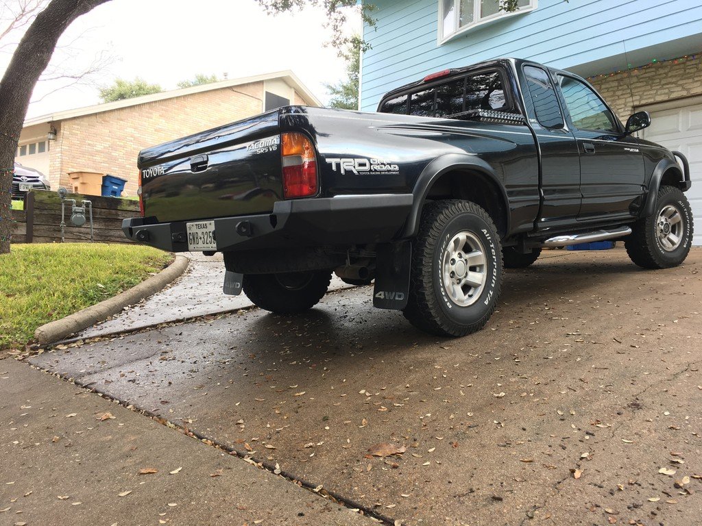

    Hey TW! Here is my 1999 Tacoma 4x4 3.4 L w/ MT and 167k. Previous owner added the TRD Off Road graphics. Just got the B.A.M.F. sliders installed. Current mods are full OME 3" lift, TC UCAs, 33" BFG AT, and Relentless bumpers. Plus a few other odds and ends.
    Future plans are to paint it (clear-coat is peeling), and get a set of Harrop e-lockers. Maybe do a re-gear at the same time since I'm on OEM 4.10 gears. I think it'd be the ultimate to do a diesel swap, but that's a long way away.
    Here is how she looks today.
    Prior to the lift with 31" tires.
    Front bumper shot.

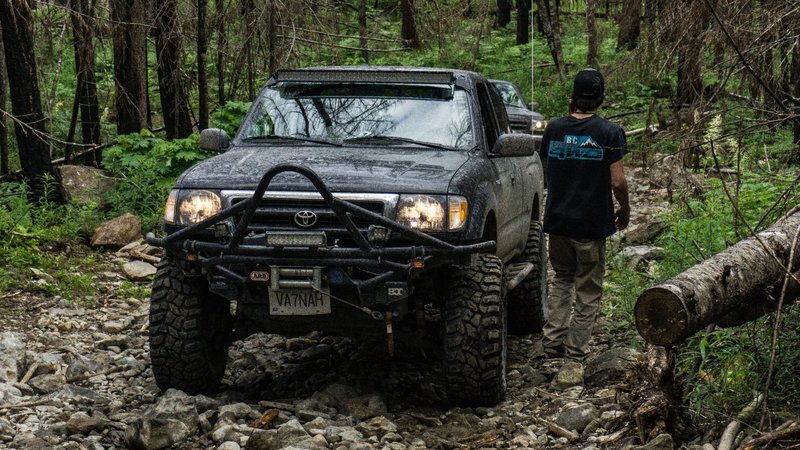

    3" suspension lift (Sway Away 2.0 Racerunners with eibach 14" 650lbs coils) All Pro Offroad Rear Expo Leafs w/ toytec boss shocks 4crawler 1" body lift Trail gear front bumper & rock sliders Trail gear rear bumper w/ custom tire carrier 33x12.5x15 Cooper Stt Pro Glare led 42" curved lightbar spidertrax 1.25" wheel spacers on the front Smittybilt 9500 winch Trd E locker w/ 12voltguy harness
    yeeeeee haw first gen best gen

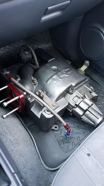

    Anyone have experience installing one if these?
    Should i get my engine & transmission rebuilt?

    As long as your engine has been maintained it will be fine. Install is pretty easy. Take off the Intake mani and replace it with the S/C. Then replace your alternator belt with the CHarger belt. The rest is just connecting vac lines. Takes about half a day

    Wait, no computer work needed?

    Not of you're running the "stock" 6psi pulley. A couple guys on here are even running a 2.2 pulley without any electronics. It really varies from one truck to the next. Some can run a 2.2 pulley with nothing else done with zero pre-ignition and others need a 7th injector and fuel pump with the stock pulley. A big factor is the elevation you live at and typically drive in

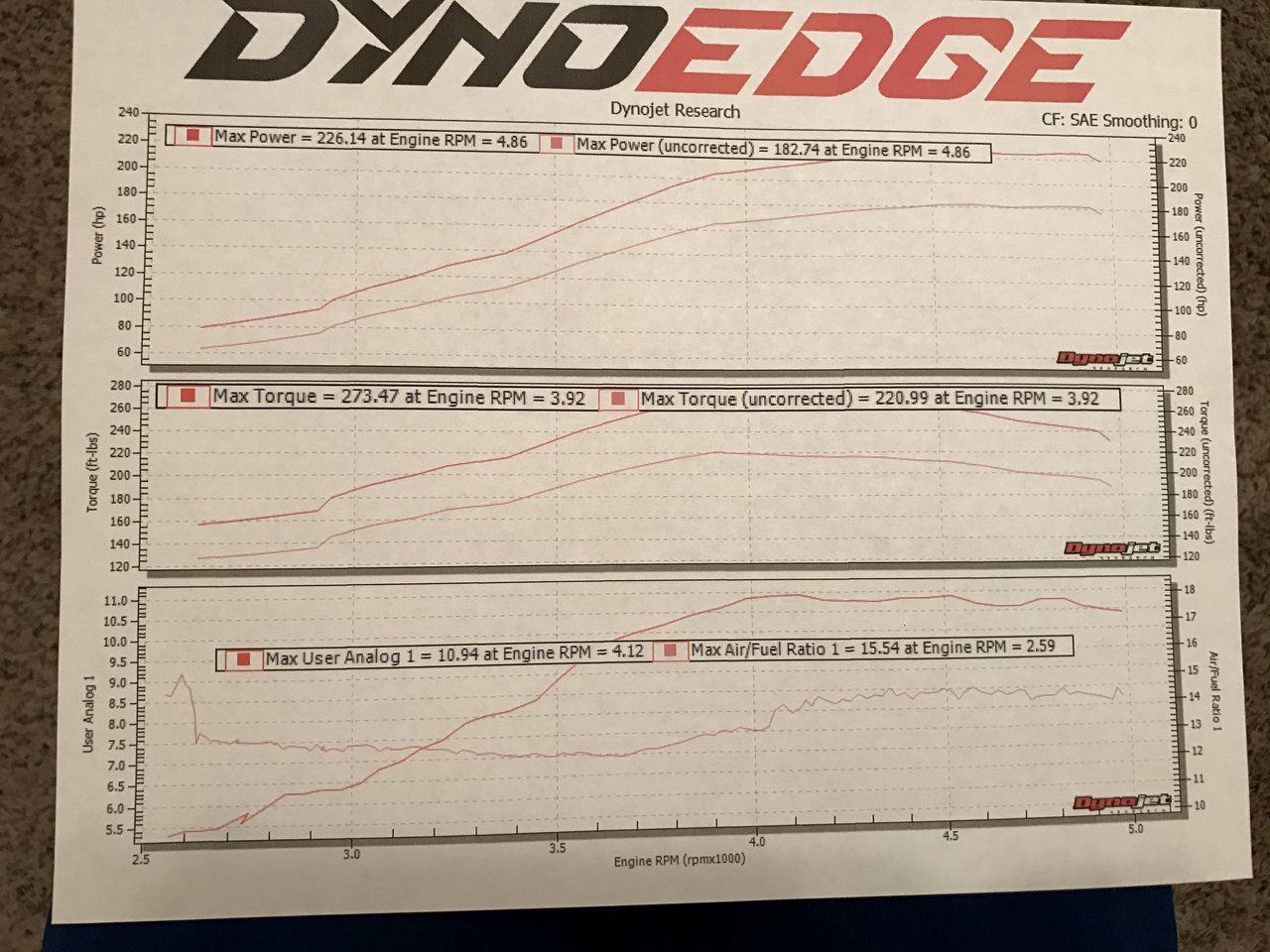

    Here's my dyno sheet. This was done in March on the stock ecu w the pink injectors and a Walbro 190 pump. Boost was closer to 8psi then.
    182 hp at 5000ft altitude
    226 hp corrected for sea level
    Their wideband was showing that it was leaning out by reading through the tail pipe. Mine was at 10.8 reading pre-cat
