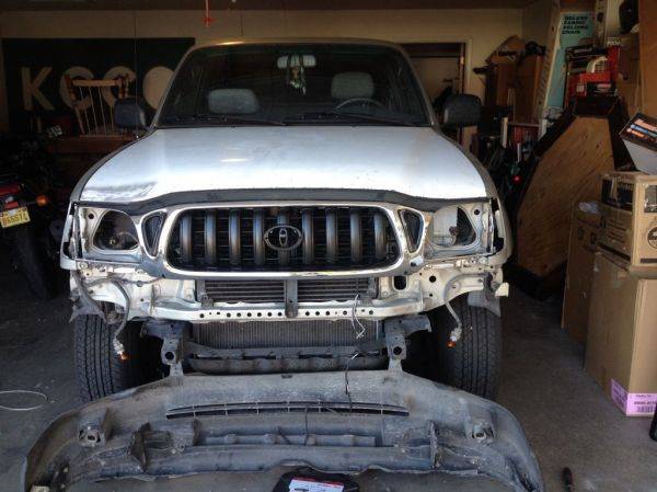

    UPDATE 2 - April 2nd: Disassemble
    Next, you will want to take out headlights, corner lights, and hood latch. Make sure you save the bolts and know where each of them goes. To remove headlights and corner lights, there are many threads and helpful links on the internet :thumbsup:

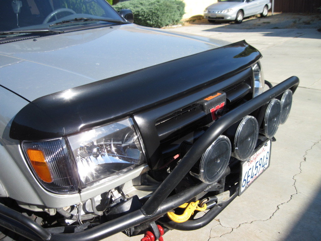

    I like the '98 - '00 grill
    tho' screw that Tupperware carp

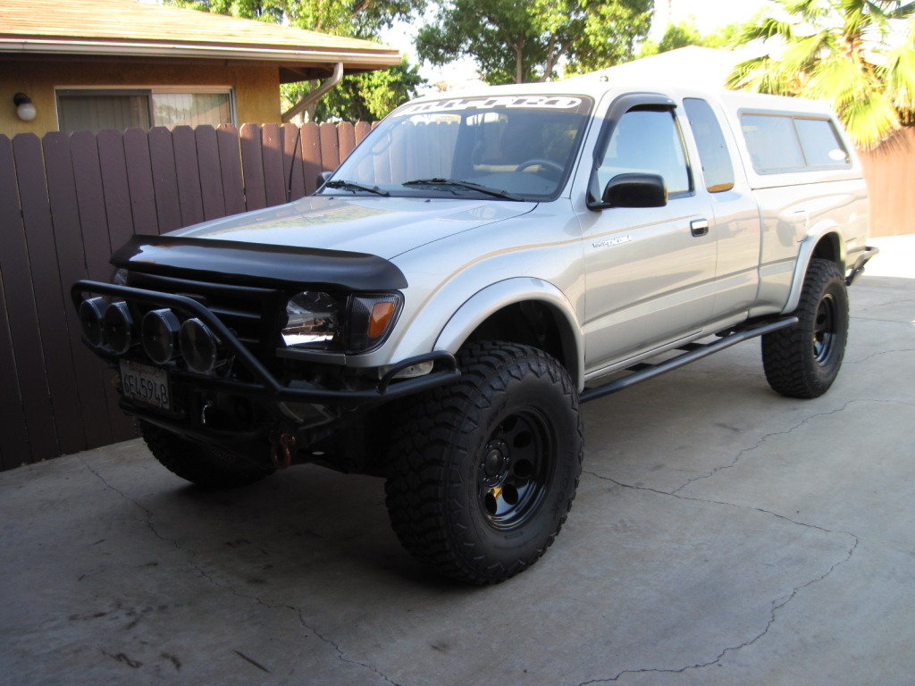

    sub'd! May do it in the future but I go on phases of liking the 01-04 and then back to the 98-00 and then back haha.
    Good luck man :popcorn:

    I do like the front WITH a tube or plate bumper like yours! I can't stand the plastic bumper. But I don't have the money for a bumper like that. So I had a bull bar covering up the plastic bumper but I sold that for $160 so that is funding my project!
