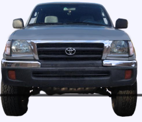

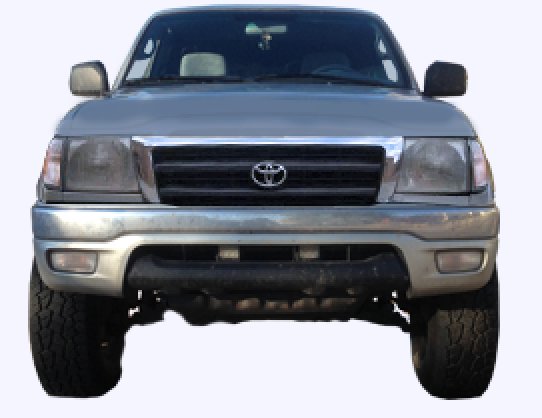

    Good question. I bet if you really wanted to you could. But I bet it would not be worth it. The problems I would see though are:
    - mounting of the headlights. The 98-00 are mounted different than the 01-04 and use a different bracket. This bracket makes the 0104 headlights sit a little higher as well.
    - the space. the 9800 are bigger and there will be gaps as you mentioned. These gaps would probably not be able to be filled by the 0104 grill because where the gaps are, the grill of the 0104 will not be sufficient enough.
    - Don't think it will look good/not much different than the normal. I did a quick mockup below. The corner lights of 9800 are bigger and will not flow (cant use the 0104 lights unless you have the grill). You can see how much gap will have to be filled below the light and looks kind of awkward.
    What I would suggest if you want to change the front of your truck without much money or skill is change the front bumper to an 0104. If I knew how good it looked I probably would not have done the full conversion. Just the bumper

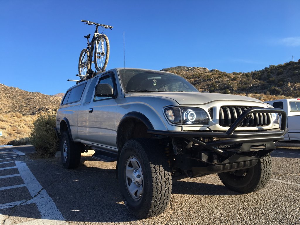

    All interested in what it looks like today

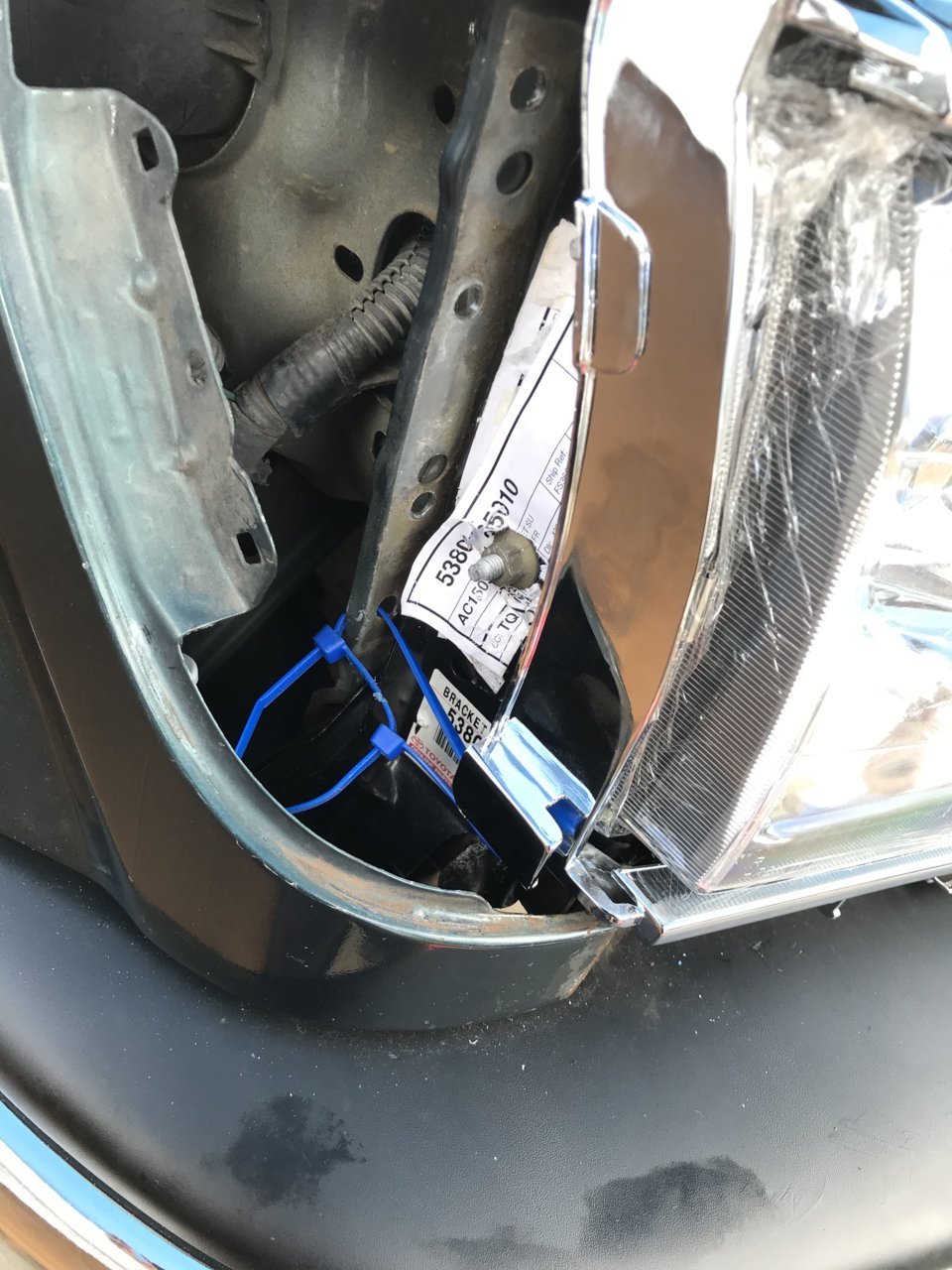

    Did everything and bought everything stated in this post but my corner lights won’t sit flush and I gotta push really hard & zip tie my grill on the left side so it doesn’t pop? Wonder if it’s becuase it’s all replacement parts?

    Make sure you grill is clipped into the radiator support? Also your corner lights clip into the grill and above the grill and screw into the top of it. Do that?
    Pics would help!

    It wouldn’t sit all the way in unless I zip tied it like this. But hey I mean it does the job I guess lol and I really love the 01-04 front end compared to my 98 ! Thanks for the reply tho I thought you would’ve been done with this thread

    Huh sorry about that! I’ve long since sold the truck or I would be more help right now haha
    There’s gotta be something in the way somewhere, not sure what though!
