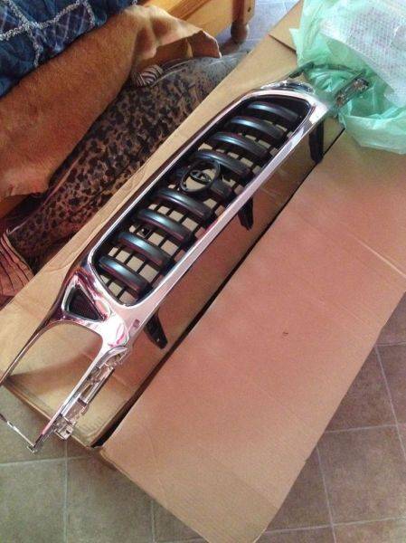

    Good news: Grill came in!
    Bad News: Had to go buy fender brackets from the dealership. $64 ugh... This is becoming more monies and time than I wanted. The parts guy was nice and they were for sale for $37 each :eek: but thanks to kevinthefawker he said I could have them for $30 since I had the parts number. Now just gotta wait for those to come in

    What color grill?

    Chrome :D

    To make the grill fit you will have to cut one of the tabs. This is the only one you have to cut as the other fit right into place
