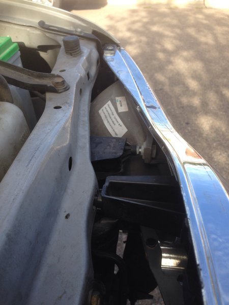

    Quick question, how does everything bolt up together with the headlights and grille! I have both in and they are not staying in place, it all seems very loose..

    Were you able to buy those fender/headlight brackets?

    yes, I drilled out the spot welds and put them in

    It seems that those two side bolts don't hold it together well enough, as well as the grille will not clip in all the way. I may have to pull the bumper off tonight.

    Also did you cut that one tab off of the grill? With the tab in the way of the grill it will not allow any of the other holes to go in

    Yes! should be able to fit right in. are your headlights only attached by the two on the sides?

    Let me go out and take a picture! I haven't checked in a while haha

    Did you headlights come with this black plastic piece that attaches to the headlight? (Black plastic with screw and white attached to the grey housing below)

    There should be three mounting points. 2 into the bracket and one into the core support. Hold its pretty steady.
