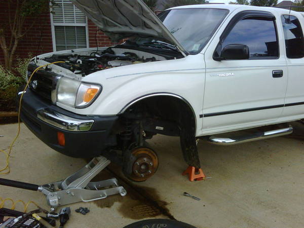

    1. Jacked up the front Lf side & braced it with a support jack for safety, then, took the Left front tire off

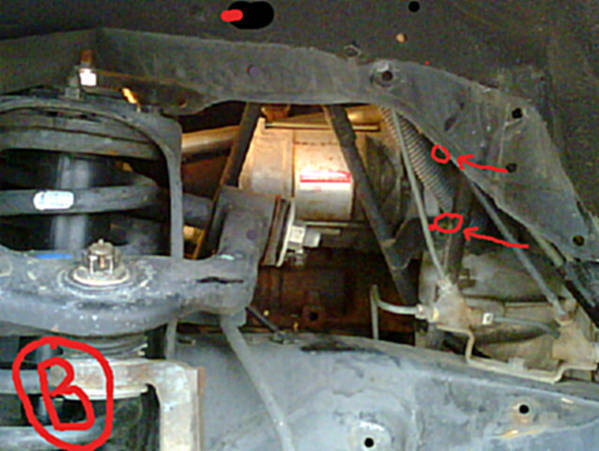

    4. Took out 2 bolts (3/8 socket) that hole the starter on, (Like everyone says it does take some manuvering in the cramped area, but you'll figure out how to get the starter out. Thru the wheel well was definitly the best for me. In PIC - B, I tried to show where the bolts are located even though you cant see them.)

    Here are a couple picks that hopefully help.
    PIC - A
    PIC - B
