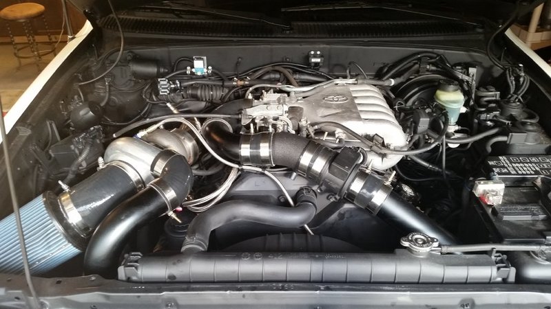

    I cant. I had to clock it a little so the drain would fit. It was hitting the t4 part of the flange and I couldn't tighten up the oil drain without clocking the center housing of the turbo......

    Same here. Im going to take a trip to a fab company one of these days to see about a new drain line.

    Finished....minus the cat back.....it's a work of art.

    WOW!! That set up really came out awesome! Very Clean... Do you have any pics of your drain line set up? How's the tuning working out so far?

    Needs lots of tuning. Ecu takes time to learn too. Plus my rear 02 sensor is still hanging. Putting on exhaust tomorrow.

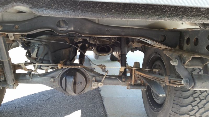

    Tough to see exhaust but it's in there. Zoom in......
    Exhaust sound is incredible. Have a borla muffler with 200 cell high flow cat dumping right before the axle.
