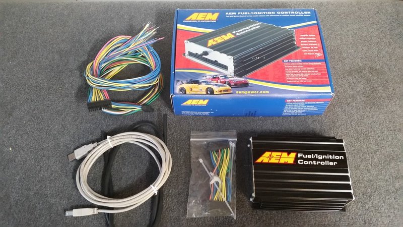

    You have 4runner ECU? Hmmm.... Should be the same. You have a laptop? I got an old netbook for $50 of CL (you will need this to tune the AEM in your truck).
    Use it to help during installs (don't mind if it gets dirty or beat up). You'll need something to interface with the AEM while you drive.

    Yeah, I got a good laptop. Fic is already mounted in the glove box. Going to download the software from aem. I just ordered the boomslang ready to go. The company told me they have done hundreds of tacomas and assured me it has resistors and is completely plug and play. I shouldn't worry about a thing on it for $400 know what i mean. So once that comes in I can start tuning. I'll most likely need some tips on tuning and all that. My understanding is you try to zero things out

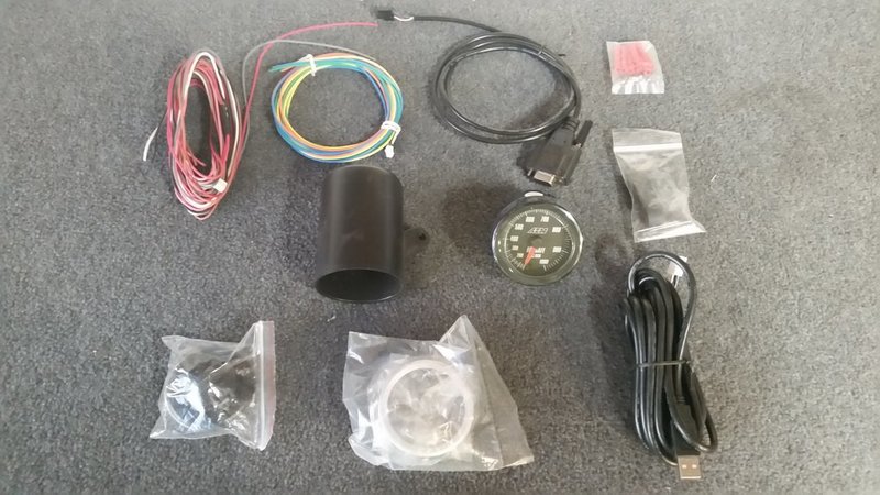

    aem water methanol failsafe

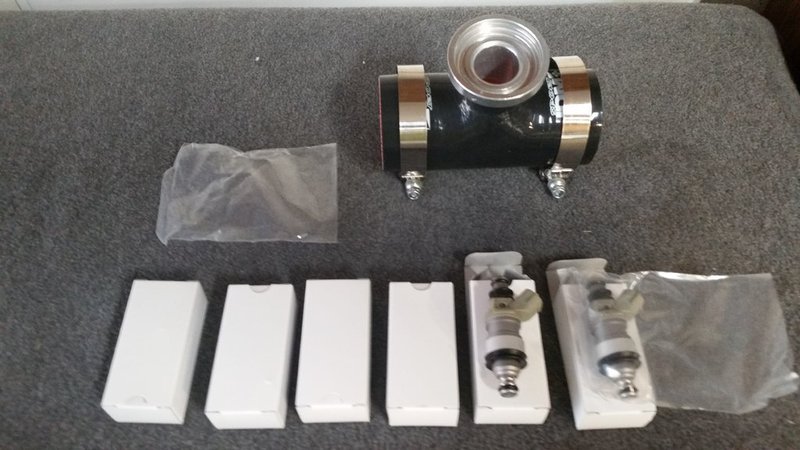

    440cc injectors and bov coupling.
    It's been stressed upon me several times that especially with a manual you want to run a bov. I don't want to damage, or possibly damage my investment so I'll be putting in a bov.

    The cx Kit doesn't have a BOV?? Wtf..

    It does, I don't think he got the kit though. Its cheap, I didnt use mine.
    The surge pressure on the bearing is equivalent to only about 1 PSI more than your boost pressure when you take your foot off the gas. IE, if Im running WOT at 8PSI, and take my foot of the gas, the spike in pressure from the surge will be equal to the pressure of running at 9-10PSI. I guess if you are running high boost on your turbo you might want one :notsure:
    Its on compression surge that kills turbos.

    Aem fic 6. Pulled the kit out of my glove box until the harness arrives. Boomslang said about 1 week. I don't want to but the glove box is going to be the best location for mounting.

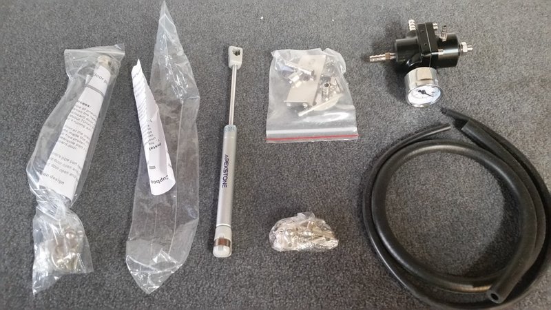

    140 psi fpr and gas struts to lift the lids of my bed boxes.

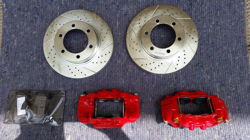

    Tundra brake kit from callahan. Has the 13wl calipers (bigger caliper and pads).

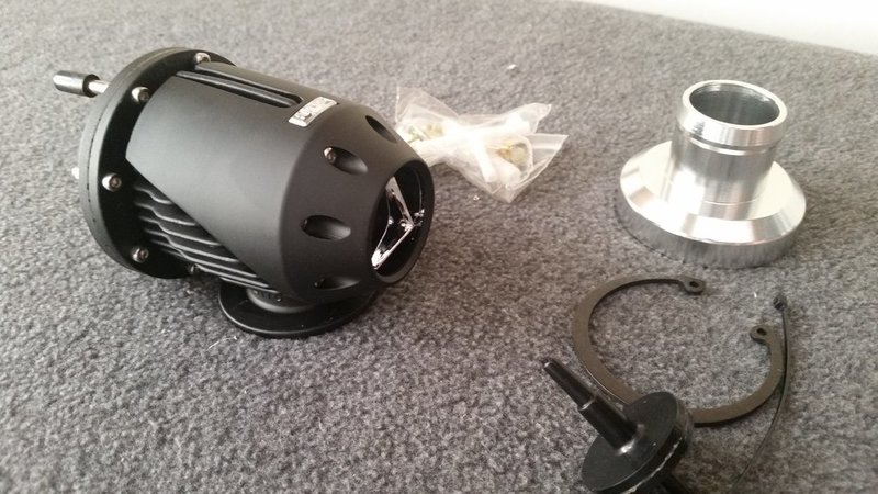

    I've seen guys boostin close to 30 psi with no BOV in their supras and evos with no problems at all, but I get where the concern comes from. And Just an FYI that ACM unit should fit perfectly either behind one of the side kick panels or under the carpet where a passenger's toes would go (right under the glove box against the firewall). That's where I have my split second unit (that still isn't hooked up).

    Got my new super fake hks bov. For $40 it will do what a real $250 one will. (I hope?)
