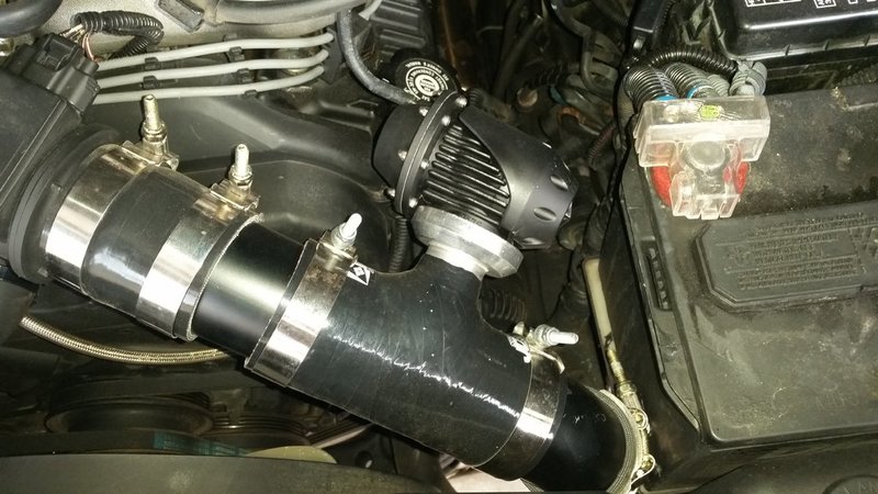

    Installed my bov and I love it. It makes a very quick short whistle sound followed by a pssssssh. Much better imo than putting pressure back on the turbo. No real loss in spool or power. I mean, how often do you see a tacoma down the road and hear a pshhhhh. It's fun. I really like driving by big full sizers with their loud exhaust that doesn't make them any faster, giving them a little bov release, and letting them know a little tacoma will smoke them. Or at least hang with a 250/2500 or 350/3500.

    When people hear my bov at signals they'll be like "you got a turbo!?"

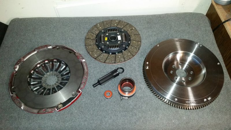

    Got in the LCE dual comp clutch and 30lb billet steel flywheel. Might be a few weeks before I'll have time to drop this badboy in. Anyone have a link offhand on how to install a clutch into our rides? I'd rather make things easier on myself.
