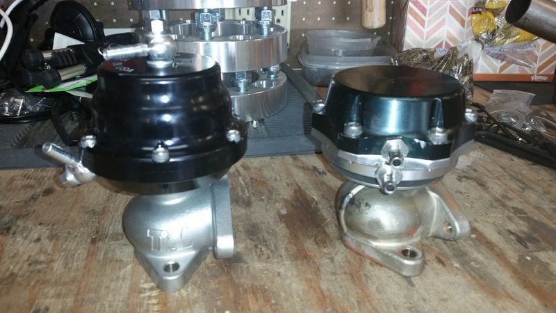

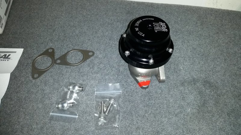

    Hoping this will help solve my boost creep issue. Almost certain it will. I remember gio and I blowing through my eBay wastegate and it had a tiny leak. Now my wastegate doesn't even vent off air like it did before, makes a weird ass noise. So I'm going to try this, 100% Tial 38mm. Got a .5bar (7psi) spring in it. I feel comfortable at 7 with my methanol.

    Swapped out the eBay wastegate for the tial. There was definitely a hole in the diaphragm as I could suck air through the cheap ebay while the tial would remain air tight. Now I can redline the whole way in boost to about 5000rpm. 4psi holds, idle afr 15, boost afr 12.5 without meth, 11.5 with. I'm still having difficulty tuning the electronic boost controller. Can anyone pitch in and tell me what I should do. There are many settings and they don't seem to greatly change the wastegate. Any info on these would be much appreciated:
    -duty cycle %
    -gain %
    -spring pressure psi
    -afr start pressure psi
    -boost cut afr
    -boost cut %
    -afr cut

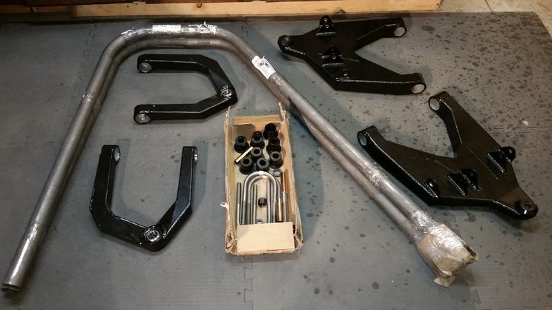

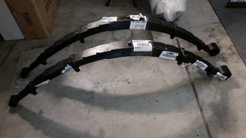

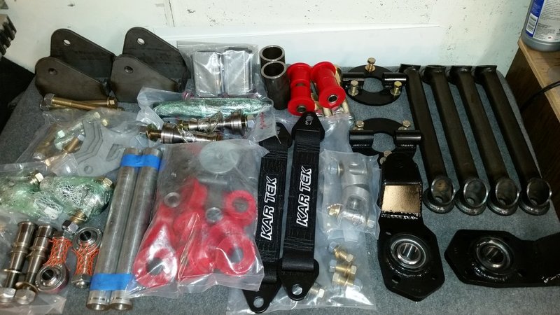

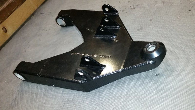

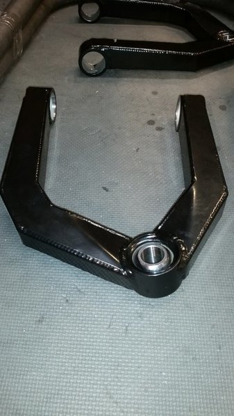

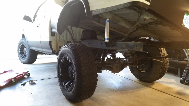

    Received the Solo Motorsports 3.5" over LT kit. Waiting on the fully fabricated spindles (4x4) and fiberglass.
    I really hope it's worth the price, I could have gotten a really nice car instead. I'll be LT front and rear. The front should be somewhat easy, but the rear is going to take a lot of work!

    Woah... Have you actually looked inside the eBay wastegate?

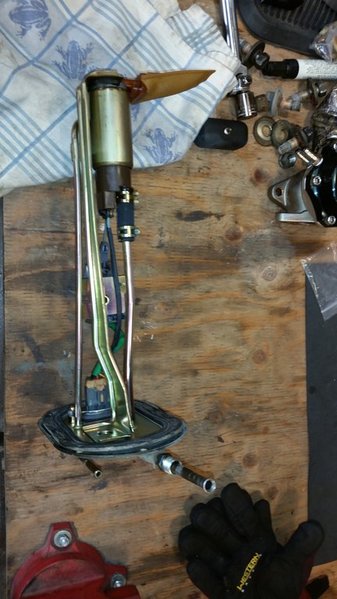

    No. I might do that when I get home. Picking up glassworks fiberglass right now. Worked on the fuel pump today. 255lph walbro.
    I'm very concerned because my check engine light keeps coming on and the pump whirrrs loudly? I can hear it in the cab. It quited down a little with a full tank of gas

  14. Aug 12, 2015 at 2:23 PM
    #374
    GioGuitarDude
    GioGuitarDude Well-Known Member
    Jun 18, 2013
    #106509
    959
    Gio
    96 TURBOCHARGED 5 speed X-cab 3.4 DLX tacoma
    Cold air intake
    Sounds like an air leak to me
  15. Aug 13, 2015 at 7:00 AM
    #375
    j0shu4
    j0shu4 [OP] 98 TRD 4x4, 3.4 Turbo, Full LT, Fully Locked
    Dec 21, 2014
    #144706
    1,995
    98 TRD, Turbo, 3.4L, 4x4, LT
    Turbo, Fiberglass, Full Long Travel, Lockers, T100 axle, King Shocks
    Pump quieted down this morning. I dunno, maybe had a little air in it or needed to break in. Hopefully it stays that way. I think the code is from installing it though. I wired it using crimp/butt connectors because the oem plug wouldn't fit the walbro. I did it nice and tight, but I wonder, could current be conducting in between the terminals? I dont think the oem plug was water tight either.....Or the thrown code from the additional pressure?

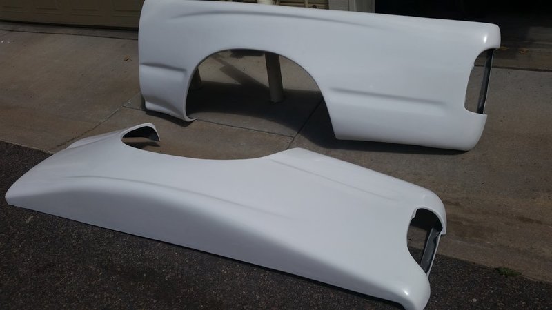

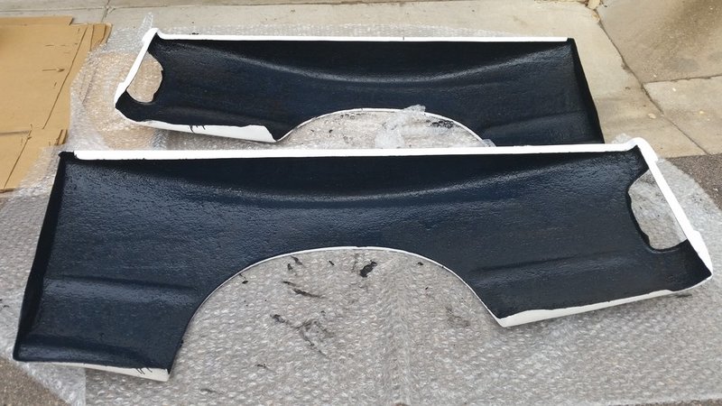

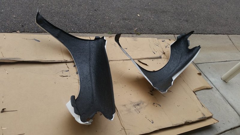

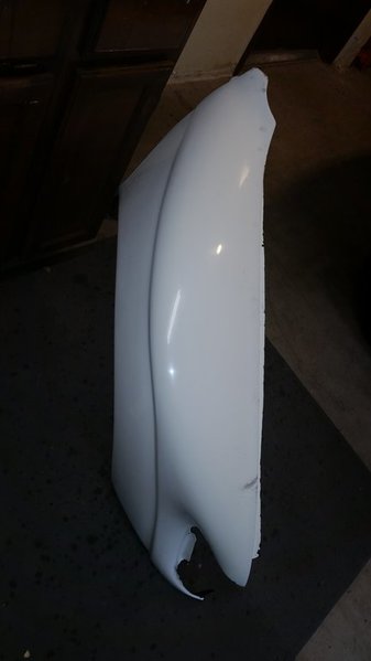

    These arrived after 3+ months. Glassworks 6.5" flare and 4" rise front fenders and 7" flare and 4" rise bedsides. I was worried about unanswered phone calls and all the horror stories but in the end they arrived. To be fair to glassworks they appear to be top notch, looks like a good fit and the finish is very nice. I'm super excited to get these on. I put 2 coats of bedliner on the insides for added protection and sound reduction (minimal).
    20150812_174245.jpg 20150812_174257.jpg 20150812_145503.jpg 20150812_173223.jpg 20150812_173236.jpg
    I'll have to clean them up and decide if I want to keep them white or what I want to do with the paint scheme on the truck.

    Press out all the uniballs and coat with anit-seize or chassis grease. You'll thanks me later when you have to replace them. The mag chloride will corrode the bare surfaces in no time make it a pita to remove.
  20. Aug 13, 2015 at 9:22 AM
    #380
    j0shu4
    Dec 21, 2014
    #144706
    1,995
    Thanks for the tip! Solo said they were ready to go and already greased. Is this something different?
