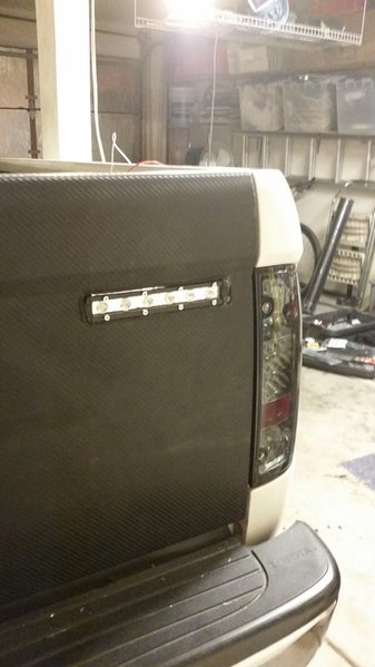

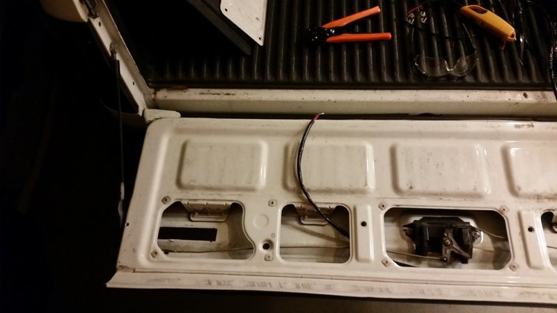

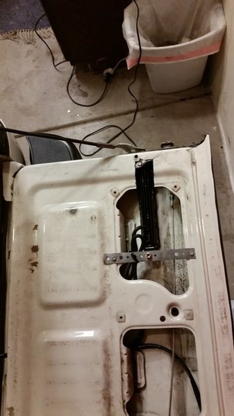

    Installed reverse/work lights into the tailgate....
    Afterwards I sale them in with black silicon.

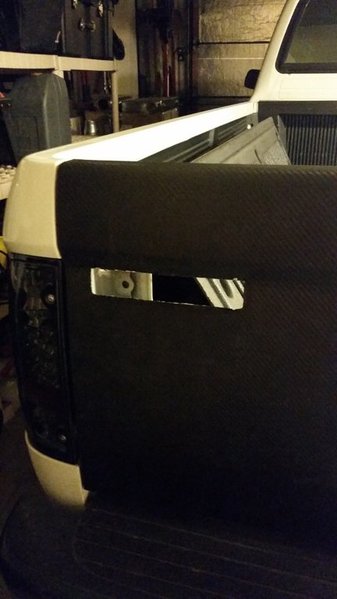

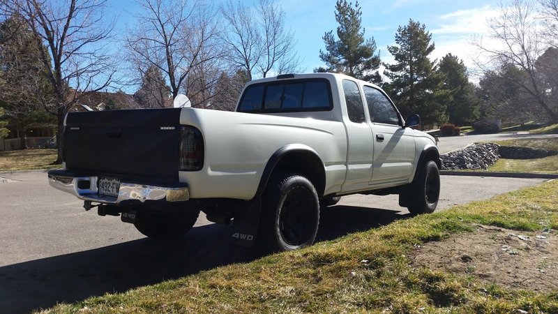

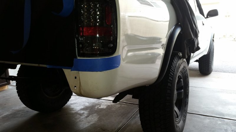

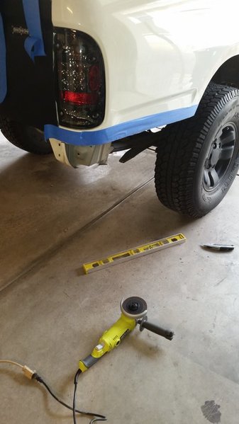

    today I removed the stock rear bumper, trailer hitch since I never use it (going to cut it up and mount it higher and tucked better than the oem location), spare tire (will relocate), and spare tire mount system. removing almost 200 pounds from the bed actually made my truck handle considerably better and a little faster (At least with the stock springs), definitely noticeable. I also cut the bed from behind the rear tires all the way around to the tailgate, primered, cut and painted the rearfenders. much more ground clearance and it looks way cooler. took a couple pics with the lights on.
    Before cutting....
    During....
    After....

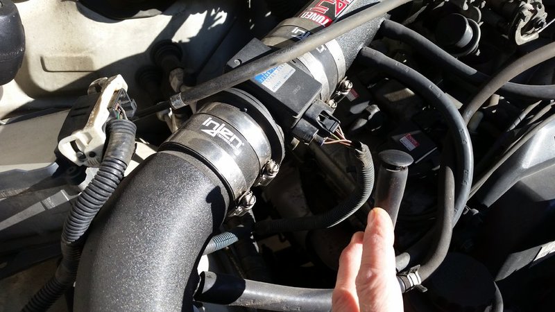

    I I am going to have to super analyze these vacuum lines. maybe I should take a picture and show you what I think is the proper routing. This would be most helpful that way I'm not playing a guessing game.

    Sweet. Like Chris said, there are only a few lines you have to worry about. It won't be that hard to figure out. You can start by buying a couple nylon check valves. I'll try to get a peek of my engine at lunch today so I can assist you a little better. And where in co are you bro? I'm in thornton and work in aurora maybe we can meet up.
    EDIT: hey dude, is your MAF a solid piece or the flange type? If it's the solid type then you may have to keep a significant section of the charge pipes 3" to make sure the readings are right. At least 6" to a foot before it.

    I'm sure my maf is some sort of black plastic housing.....is it one piece, not sure, will have to look. So hopefully this weekend I can buy the Toyota header gaskets, check valves, stove high temp sealant, and sealant for my oil pan. That should get me close besides any reducers or modification to my charge pipe system. I will most likely start the intercooler mount first. I need some aluminum L channel to mount it. Is Home Depot the best for that?
    MAF.....

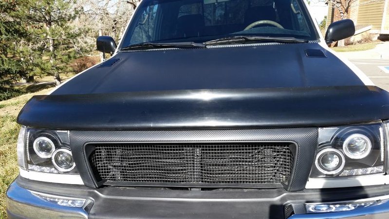

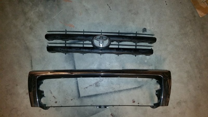

    At some point I redid my grille and added an electric dual toned horn.... (sounds like a Ferrari's horn, way better than stock)
