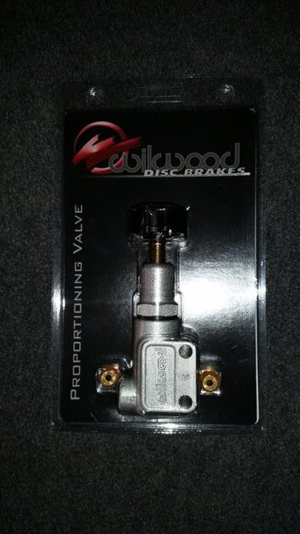

    Picked up proportioning valve from jegs. (Adjusts rear to front brake bias %)

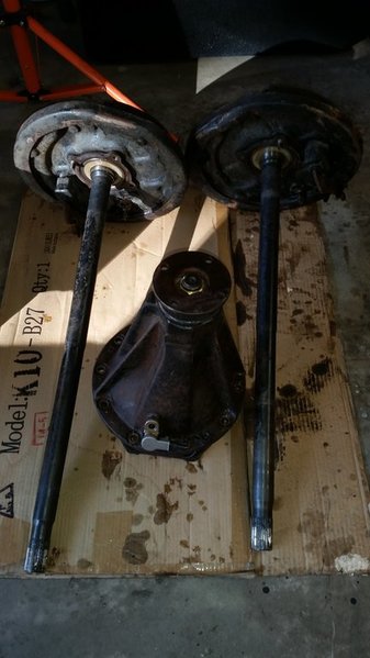

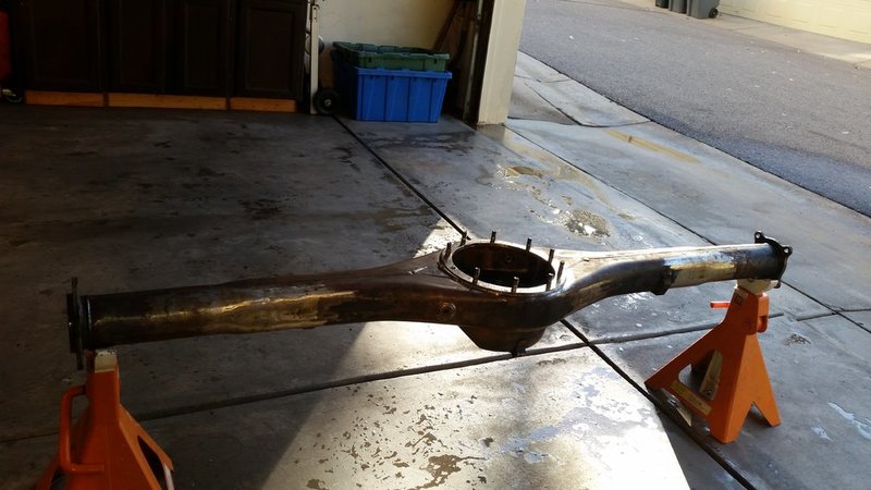

    Prepping the rear axle.....lots of work ahead on that thing. (T-100. 66 wms) Keeping the drum brakes as recommended by like everyone (vs. discs), and going to start with new drums and shoes.
