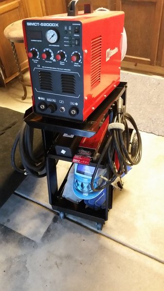

    Can you post a link to the type of welder you're using?

    http://www.simadrestore.com/po20si5250ap
    Simadre 5200dx, 2015 model, you can find them new off ebay ($450), 1% failure rate on welders, im sure other companies have that or more. hooked up to my house breaker box. Going to practice soon.

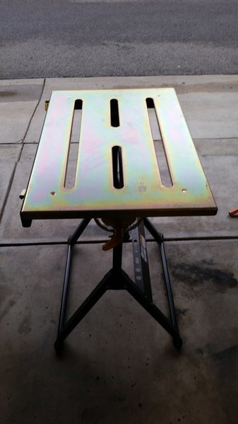

    Welder....
    Welding table....

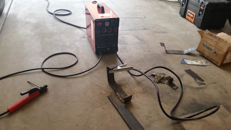

    Welder worked like a champ today!
    Edit: Have practiced my welds a lot since that first one. Lmao!

    Welder needs more practice :p
    Mine aren't much better though :eek:. Watch some youtube vids, very helpful for me.

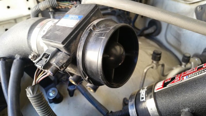

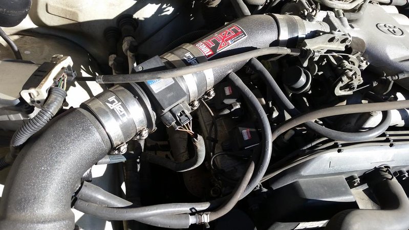

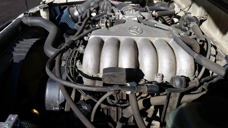

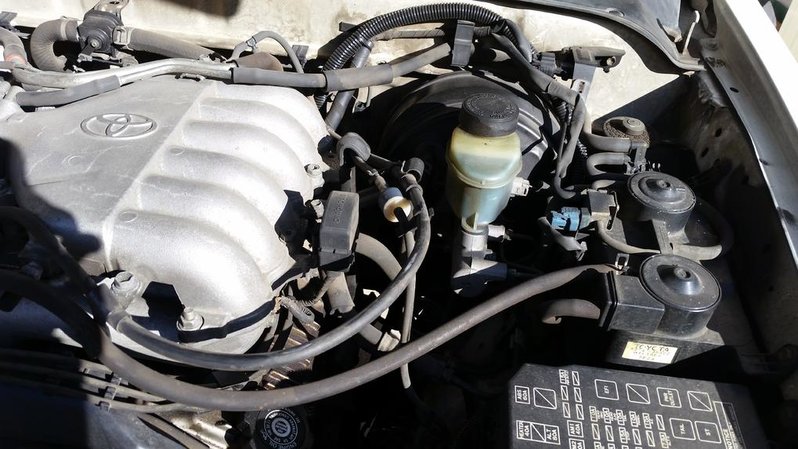

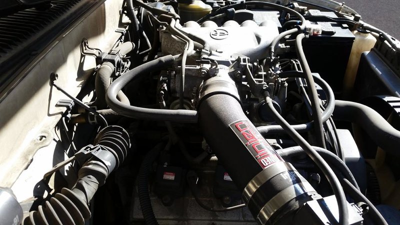

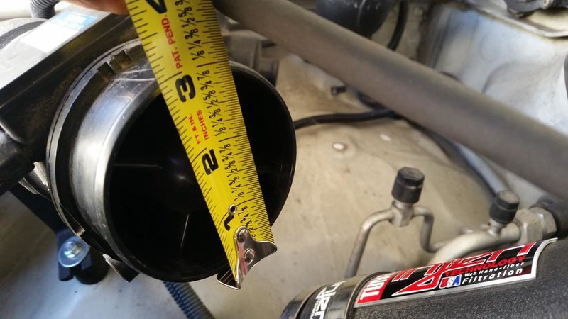

    My maf is weird, I just looked at it and measured. It's 3" and in its own plastic tube with a vane/propeller looking thing inside of it running down the tube......also took pictures of the engine bay. Not sure still where to put the check valves and tap into vacuum. Also not precise as to run things for my catch can and coolant taps. I might need some t fittings for the coolant and vaccum but don't know what size because I am still unclear.
    [​IMG][​IMG][​IMG][​IMG]
    If you can, please photo edit and point out what I am doing with what here as far as the vaccum and coolant lines. I can also shoot better images over to you if that would help.

    The inside diameter of your MAF is 3"?

    [​IMG][​IMG]this is how my maf looks, outside diameter is 3", I think inside is 2.75......can someone look at my engine pics and please show me where to tap into vacuum and coolant?
    Edit: 2.75" inside

    I can help you a little on the vac lines. First, locate the vac line that is on your intake and closest to the TB that runs down between the upper and lower intake manifold. That is for you fuel regulator. Now, locate where your PCV valve plugs into your manifold right after your TB. When you do your catch can and run your PCV there, rout the fuel regulator vacuum to the fitting the PCV valve is currently using.
    Next, there is a vac line that goes across the entire engine bay and connects to your fuel evap box behind the battery. That can be removed and the box can be capped with a filter.
    Next, on the front of the upper intake manifold, there is a rather large fitting that has a cap on it pointed out straight ahead. I use a silicon vacuum hose and got it to fit over that. I ran that hose into the cabin for the AEM FIC. I t-ed the boost gauge off of that as well.
    The turbo will come with a vacuum fitting. That is the one you want to connect to your waste gate (via boost controller if you have it).
    DONT put a check valve on the brake booster vac. I took mine off as my brakes started to not work...
    Let me know if I missed a vac fitting.
