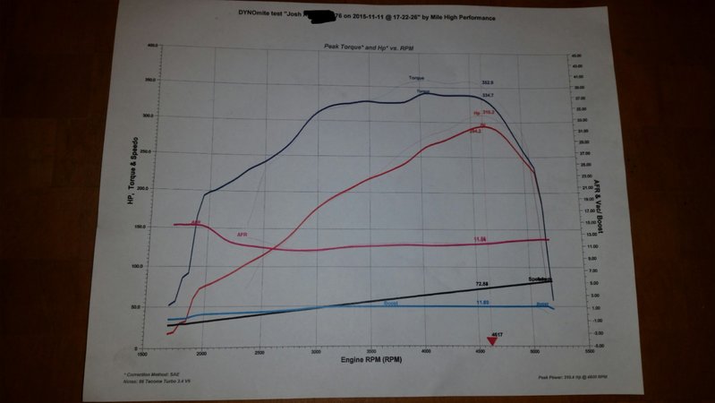

    Made 352ft lbs and 310hp this time. Me likey......
    So here is my latest graph. Upgraded to the supra TT fuel pump. Left the fpr hose going to the plenum. Runs good, afr around 11 to 12 in boost.
    Only got one dyno pull recorded. It wasn't the best pull but I thought better than nothing.

    Making 2nd Gen TRD S/C modded #'s. Well done. :thumbsup:

    Damn, crazy torque! Get some top end work and raise those RPM's to 6-7k and HP will rocket.

    What are the specs of that turbo again? It sure shows no sign of slowing down.

    Billet Whee Ball Bearing GT30 GT3071R l Turbo Charger
    Stage III Ceramic Ball Bearing on Compressor Side
    .70 A/R Compressor Housing
    .82 A/R Turbine Housing For Super Fast Spool 1.8L-3.0L Motors
    T3 Flange to Manifold
    3" V-Band Downpipe Flange
    4" Air Inlet and 2.5" Turbo Outlet
    Works for Many Bigger HP Applications, 400-600 HP
    Light Weight Billet Wheel Offers Excellent Performance
    Each Turbo is Individually Tested and Computer Balanced.
    Item(s) Specification :
    - 4" Air Inlet
    - 2.5" Compressed Air Outlet
    - Ceramic Ball Bearing on Compressor Side Compressor
    - Standard T3 Turbine Housing Flange
    - 3" V-Band Exhaust Outlet
    - 400-600 HP
    - Oil Cooled
    - Working Pressure: 8-30 PSI
    - 0.70 A/R Compressor
    - 0.82 A/R Turbine
    - Compressor Wheel (Major/Exducer): 71/53mm
    - Turbine Wheel (Major/Inducer): 68/62.3mm

    Someday maybe. Would be freaking sweet.

    Get an electronic boost controller, increase the "start boost" (name brand dependant), and you can break lower the peak boost rpm. Basically increase the spool speed and break the boost threshold sooner. As it will keep the wastegate from cracking open until full boost is reached. So no bleed off until full boost.
    Works very well.

    Ok. See, I have an ebc, and can't dial it in. I could use your advice. I can't accurately dial in the settings because there are a crap ton first of all. I thought the tuner was going to do it but he didnt, and I may contact his boss. Long story. So anyway, I want to dial it in. Duty cycle, and gain are what I want most. But yes, I want the spool to ramp up quicker, keeping the wg closed longer.

    Which brand electronic boost controller do you have?

    Innovative sgc-1
