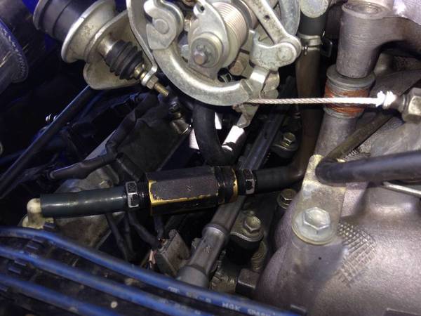

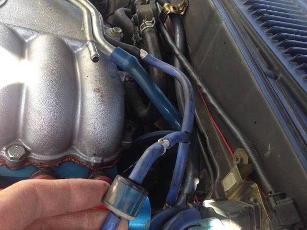

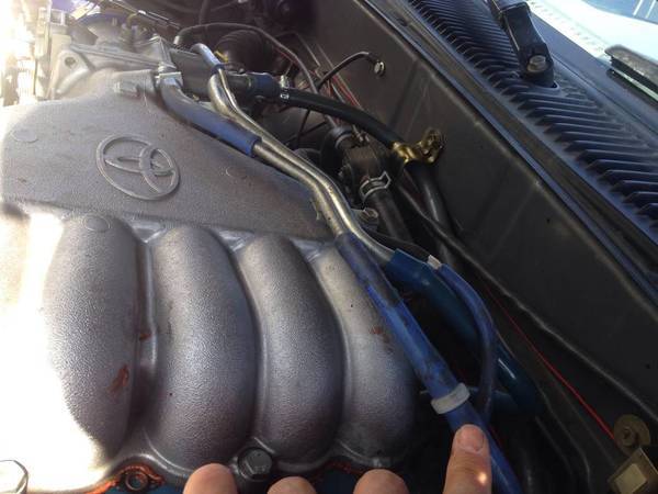

    Here are all of my check valves. I'm sure your 4wd actuator vac line left the factory with a check valve (the little blue one). My PCV system has a brass check valve but that probably won't help you since you're doing an oil catch can. Upon further inspection I realized that you'll only need to add one check valve on the 3/8" line in the very top of the intake manifold (the white one in my truck).[​IMG]
    Literally every single hose that connects from your air filter to your throttle body can be T'd into one single line and a tiny little 3/8" air filter can go on the end... or you can add a nipple just barely post turbo intake filter (after you install the turbo and charge pipes) and hook that single line up to that.
