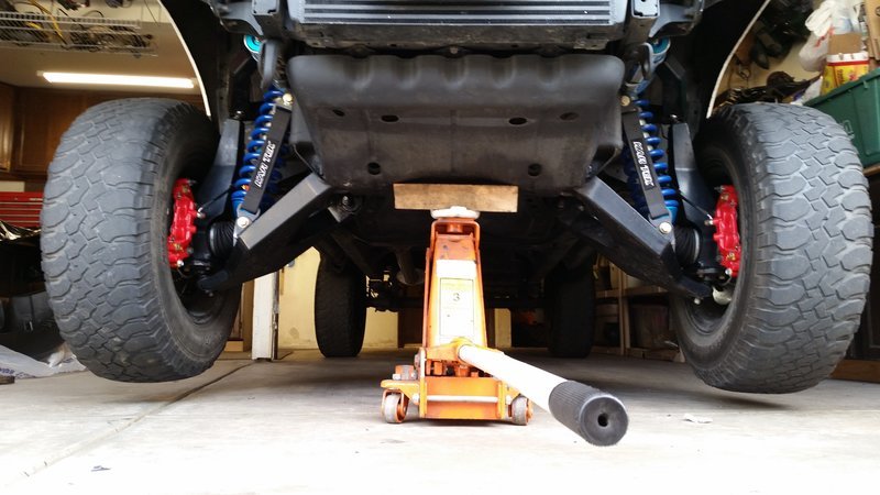

    4x4 droop
    And boost

    Holy droop! :eek:
    Looks awesome!

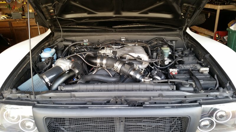

    Love beefy lower arms. I don't know how you keep your engine bay so clean. Mine is a disaster right now. I'm dreading washing it with the turbo blanket and heat wrap.
    Might have to buy that catch can too. I just have a hose dumping down right below the frame and it looks like snot under the truck. Glad it isn't going into the motor at least.

    Got a small electric pressure washer, I hit the bay from time to time. At one point I just taped a few things off in there and flat black sprayed it. A lot cleaner that way.

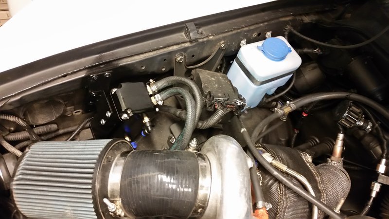

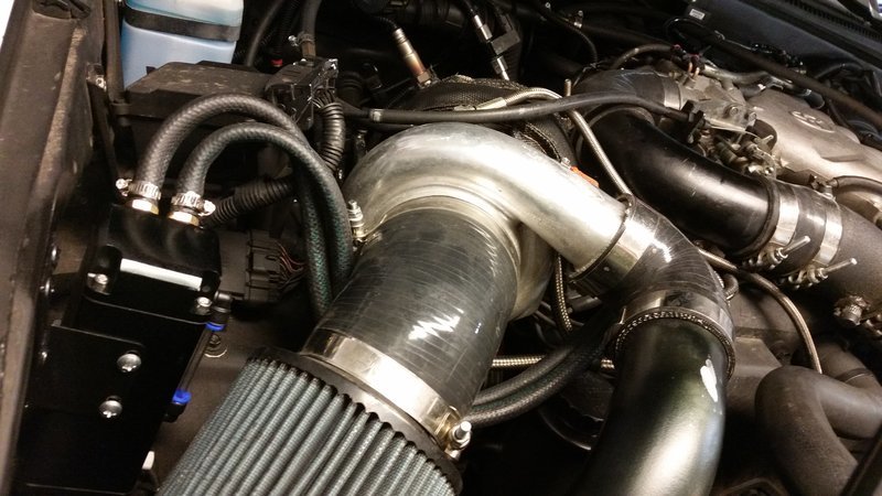

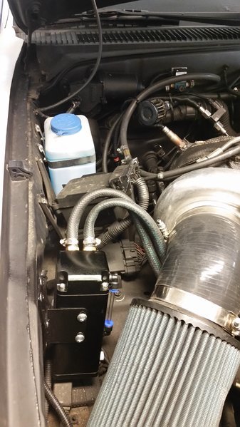

    Finally got around to installing the oil catch can. It was super easy and I'm not quite sure why I waited so long to put it in. The hardest part was getting the correct length and type of hose and finding the proper fitting to mount into the can. My oe PCV line didn't have any residue in it and the PCV valve was clean. Does this mean the can wont collect anything? We will see what it gets if anything, just worried that it might not even need it if the oe run was clean anyway.

    Is it 2 lines in and 1 out on that can? Think I'm going to pull the trigger finally on one instead of dumping below the frame.
  16. Mar 21, 2016 at 10:41 AM
    #836
    j0shu4
    j0shu4 [OP] 98 TRD 4x4, 3.4 Turbo, Full LT, Fully Locked
    Dec 21, 2014
    #144706
    1,995
    98 TRD, Turbo, 3.4L, 4x4, LT
    Turbo, Fiberglass, Full Long Travel, Lockers, T100 axle, King Shocks
    Yeah man, 1 runs from your valve cover pcv to the can then can to manifold intake. Basically runs in line with your PCV system. I've also seen guys vent to atmosphere and just put a small breather filter on the mani intake. Other guys remove the PCV check valve too but mine still works. Not really sure if that helps anything removing it?
    MadTaco461[QUOTED] likes this.

    Lol that's ironic that we got like the exact same catch can. I hope you used teflon tape though... No residue in the valve might mean that the valve is old and not working properly.

    Can I just run it straight out with no pcv valve? Dude that tunes said you don't even need one on boosted cars.
    I had to get smaller brass fittings 3/8 instead of the huge aluminum ones that came with it. Found good ones at O'Reilly.

    It comes with large fittings? I was curious if they be too small for my truck. How large is the inside diameter? I use 3/8" hose because I get a good amount of blow by.

    Yes, in fact I was going to set mine up like that. You need to plug the intake mani fitting though or you'll have a vac leak.
