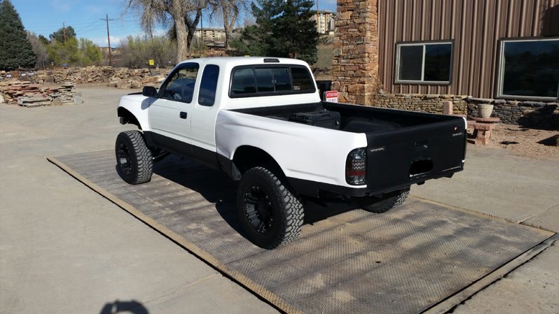

    Got the truck weighed today while picking up some boulders. With 2 people it weighed 4200lbs, so minus us about 3800lbs. That is freaking light as sh$t! Especially for a 4x4 with a turbo, 32" tires, and a front LT setup. And with 310whp thats impressive. Good stuff.

    Loaded weight was with the rocks and us in there. ; ] Empty had the 2 of us inside.

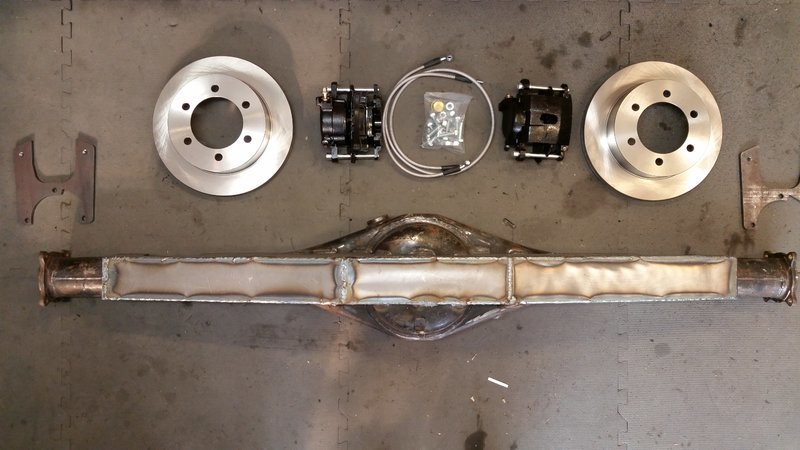

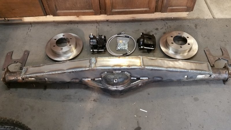

    Got the axle truss welded on the old t100 housing today. Just needs cleaned up, primed, and painted. Pretty much have everything I need to put my axle back together aND build my rear LT. Disc brakes came in. Went with the Chevy S10 brakes. The drums and brakes were shot on the axle I bought anyway, so, instead of buying new drums, pads, etc., just got discs. I know some guys say no but I've seen em done with good results too. Have to press in the new seals, bearings, and axles, and install the 3rd.

    Whose truss kit is that? I should really do my tundra axle, but I really don't want to cut out that much steel if someone did the work.

    Relentless Fab, modeled off of jberry813. It fit perfect. Was a pretty good deal too, about $125 shipped or so if I remember, thick steel too. I'm happy with it. Made the axle housing weigh a ton but I'm pretty sure it's fairly bulletproof at this point.

    Thanks, what is the best way to get a hold of them call?

    Yeah, thats what I did. They have the pattern already to laser cut out.

    Noob question... what's the point of adding all that steel? Just for strength and rock damage protection?

    Maybe to add weight to the rear? I dunno. My though is maybe it helps ballance the truck

    When you jump your truck (as the OP is want to do), your rear axel can get bent. The trusses are pretty much required for jumping, desert running, etc...
