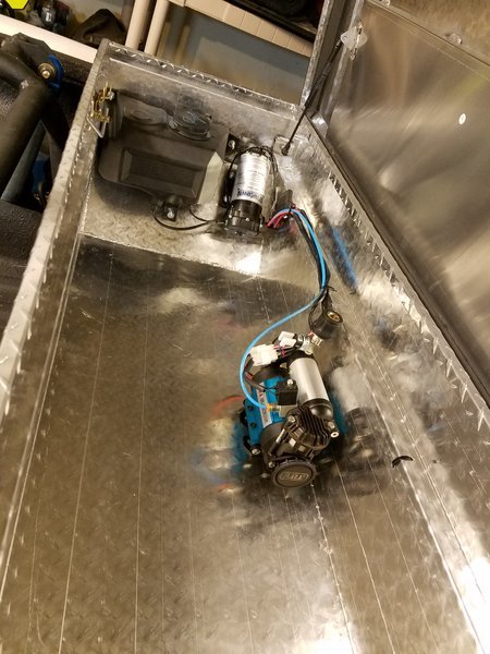

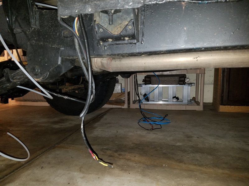

    Got a bigger tool box than my two little ones. Lowes had 20% off plus military discount. Had to remount and plumb stuff again which is taking a while. Putting in the arb system too while I'm at it.
    Stuff still hanging for me to return to.

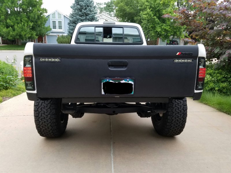

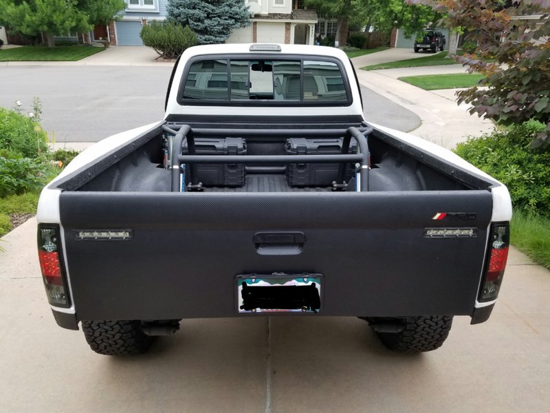

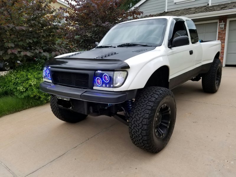

  10. Jun 27, 2016 at 1:54 PM
    #950
    j0shu4
    j0shu4 [OP] 98 TRD 4x4, 3.4 Turbo, Full LT, Fully Locked
    Dec 21, 2014
    #144706
    1,995
    98 TRD, Turbo, 3.4L, 4x4, LT
    Turbo, Fiberglass, Full Long Travel, Lockers, T100 axle, King Shocks

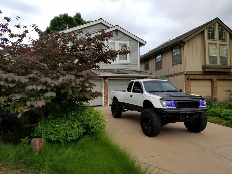

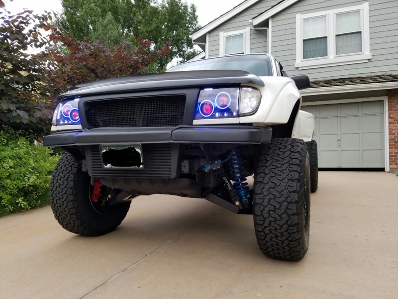

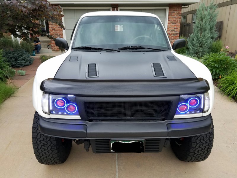

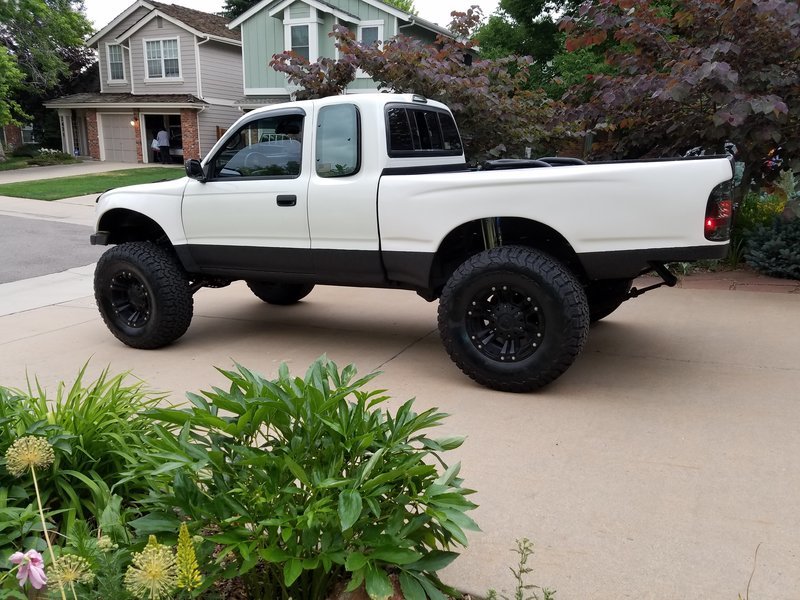

    Couple more sexy pics.
    Dem chikes tho......! Lol. (Not bad considering there's no bumper)
