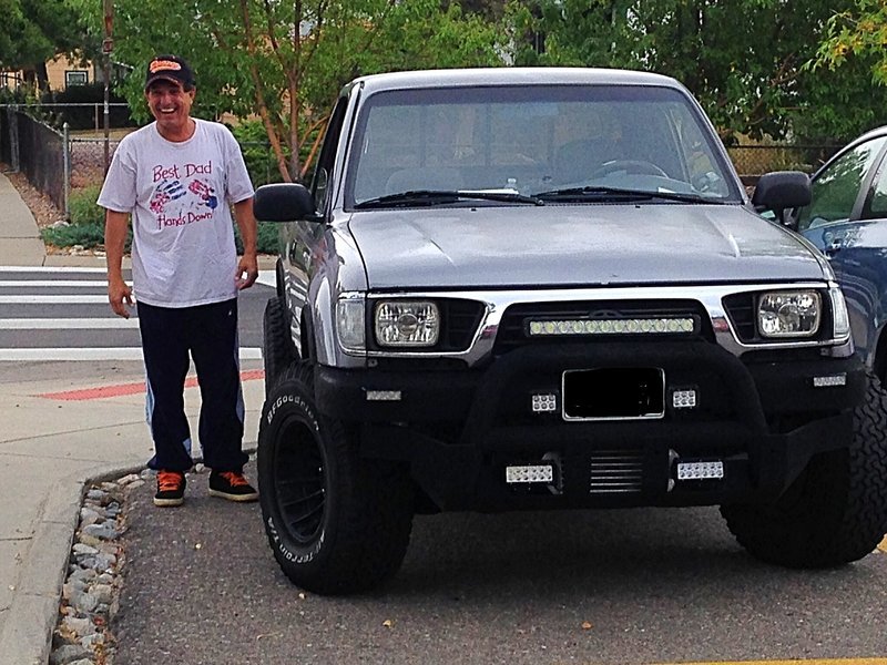

    I'm pretty good where I'm at. I'm making 310whp and the truck moves pretty damn good with 35s and 4.88s. It's definitely not a highway vehicle anymore. I'd like to get more power and I'm sure I could if I had better tuning knowledge. I'm just booked up with a lot of stuff that takes more priority for me right now. Plus I need bumpers and to put my light bar on first. DAMN I need bumpers bad!

    I had planned to go e85 right off the bat but now I'm not certain because it'll probably be too much power for the motor to even handle. I got huge injectors accordingly and they were a total PITA to tune on gas. After finally figuring out my tune I can see why people say not to even mess with this engine for higher hp, the ecm is a total bitch and hates being tampered with. The fuel map I have now which effectively zeros my trims at all loads is the exact opposite of what you would logically predict it to be. But like you say, thing fucking boogies :burnrubber:.
    Are you going to fab your own bumpers? Your truck would look nasty with a big stinger off the front. Are you going to try and fit around the IC or just move it? I've always wondered how much the turbo IC would affect the radiator if it's sitting right in front of it. I kind of like the way mine looks where it sits now though :notsure:

    Fabbin up a bumper isn't that hard. Especially if you have 3/8" steel plates laying around
