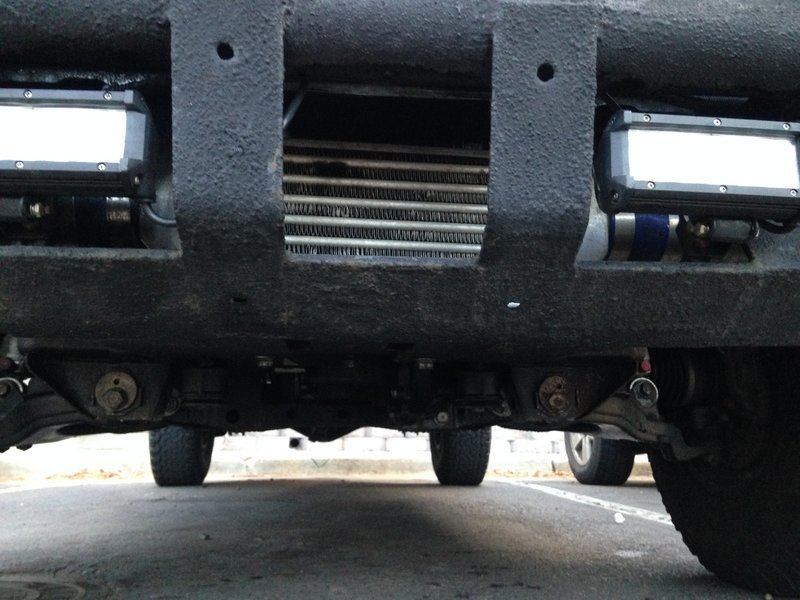

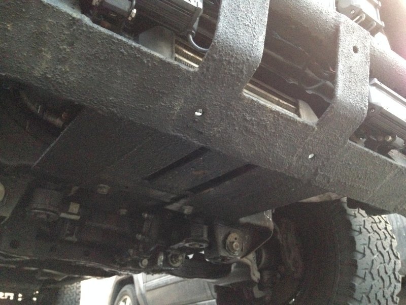

    Its not a legit skid plate, but there is plenty of protection.

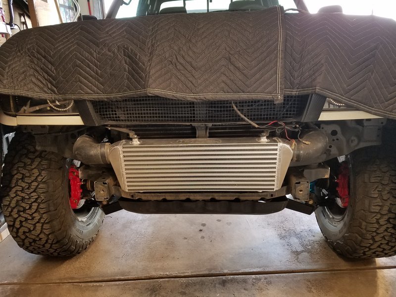

    Got my smaller intercooler in to fit inside my bumper more comfortably. Not looking forward to dropping the front diff again but you gotta do what you gotta do,

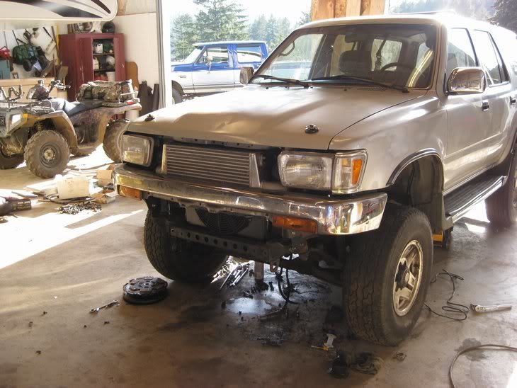

    it's do able. This is what i would do.
    Granted a 4runner but still. Shows you it's possible. Then you could rock a winch still.
    Im actually surprised none of you have done this yet really. Seems way more practical to me.

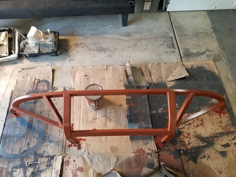

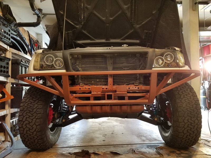

    1st coat primer. Remounting IC. Liking the size of the new IC much better than that 1000hp IC I had on before.

    Liking these way more too.

    It's a pain in the butt to do that spot. I might be able to do it once I get rid of the factory hood latch. If we only had the room of 2nd gen tacoma's

    Looks like he has an electric fan, no a/c, and no radiator possibly.....? A LOT was removed to put that there. Theres no clean way to run the charge pipes for that. How he did it it I don't know? Its doable but might be messy with more bends.The lower your IC and further from the bay the cooler the air. Not like it would make much a difference. Would be more convenient for bumper/winch options for sure.

    You can still see the radiator down below.
    This is a 2jzgte swap. So yes i believe he has an E fan. AC..not sure.

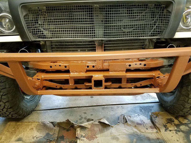

    This is coming out amazing. Totally happy with things so far. I have a hitch mounted shackle and will be getting a hitch mount winch. Bucked and pulled on it hard with my girlfriends Jeep Grand Cherokee and it's solid...... just a view of how it's mounted. Once it's painted and the intercooler goes back in all that will disappear.
