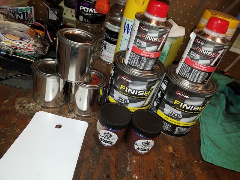

    Had a leak in my turbo oil feed line. Kept rubbing on the hood. Re-angled the 90° to be 135° off the turbo so it clears and tucks better. Got a 36" braided line off eBay for $15. Still need to look at this front locker situation. Thinking @Blackdawg @Clay_916 you're right. That's just how a front locker goes until you hit gravel where it can slide/turn. I'll find out more this weekend and do more testing. Getting ready to prime and paint it.....lol. I know 95% of the people on TacomaWorld are going to laugh but it's my build. What I want. Doing a 7 way colorshift. Already bought the pearls I want to do it with........ Solis Hypershift. But it's going to be a flat black matte finish.......
    http://www.didspade.com/solis-supershift-pearl/
    And I'm going to vinyl wrap sticker bomb the hood, gate, door jams, and wheels......
    Like I said most of you guys will laugh at this but it's going to be a jaw dropper. Like my Close Encounters of the 3rd Kind headlights.....more fun to come.

  10. Mar 4, 2017 at 2:02 PM
    #1150
    j0shu4
    j0shu4 [OP] 98 TRD 4x4, 3.4 Turbo, Full LT, Fully Locked
    Dec 21, 2014
    #144706
    1,995
    98 TRD, Turbo, 3.4L, 4x4, LT
    Turbo, Fiberglass, Full Long Travel, Lockers, T100 axle, King Shocks
    Paint stuff so far......
    boostedka and MrCrowntown like this.
