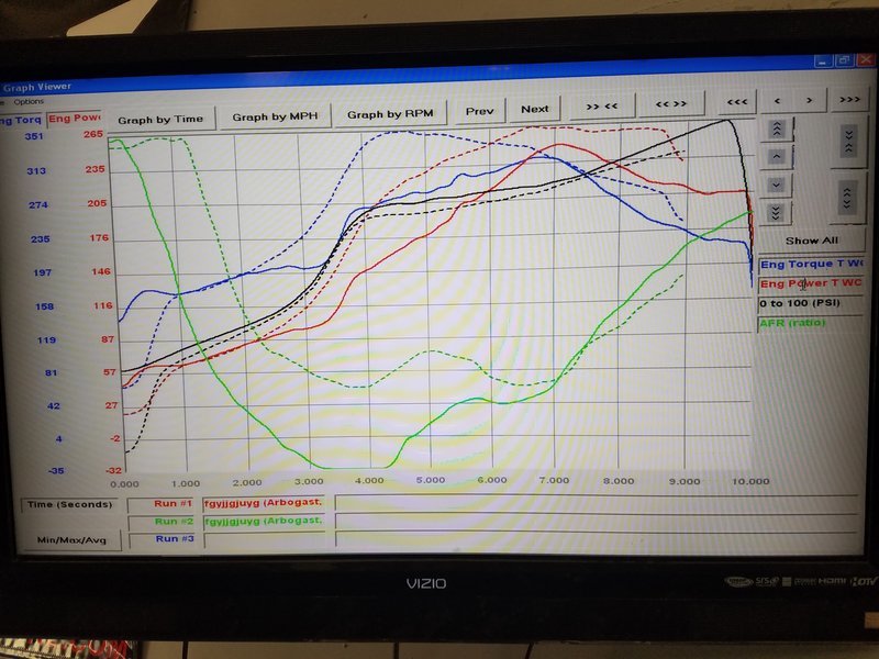

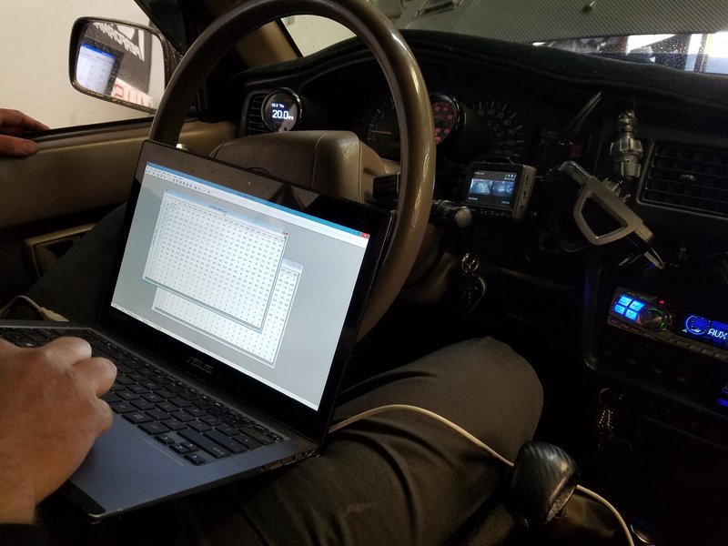

    Encountering some trouble making more power. I can only boost up to 11 PSI. After 11 pounds I can't add enough fuel. The 42 pound injectors should be good up to high 300 horsepower low 400. What can be limiting me? Does FPR have enough? What about the MAF? The tables are completely maxed out in from 5000 to 5500 RPM we can't give it any more fuel

    Nice, if I'm reading that right 350ft lb torque and 265 hp

    Yeah. Lower than my last numbers. Different dyno.....

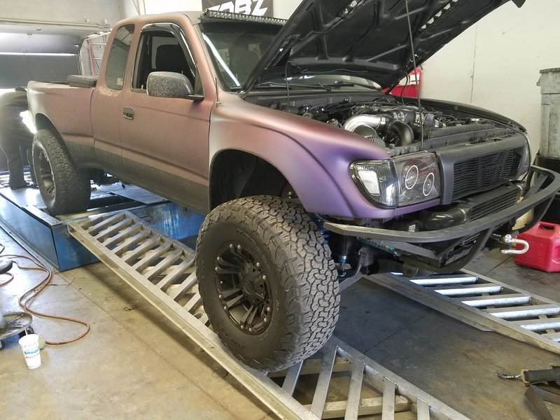

    whats your measurement from outside of tire to outside of tire? your just on the normal solo kit with their spindle right? looks bitchin and fills it out

    I believe this is an AWD Mustang Dyno. Plus I have 35s and 4.88s now too. I'm glad it's boosting 11psi with consistent 11.5afr......ish

    No, I was on 4.10s and 32s......Made 310whp at 8 psi.....different dyno.
