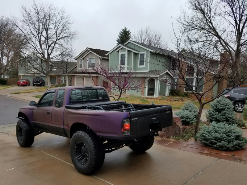

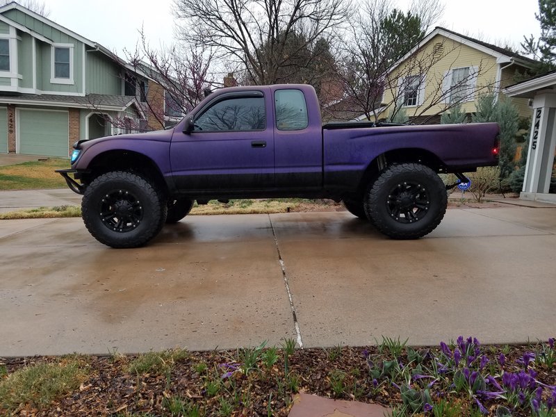

    2019 TRD Pro Tacoma - Voodoo Blue / 06 double cab PreRunner Turbocharged (sold)
    That's one hell of a color u got there. Is that a dip color or paint?
    j0shu4[QUOTED][OP] likes this.

    It's paint. I actually go off road when I'm not at the mall (true story) so I thought dip would be a bad idea...... Went into the paint project fairly blind but it turned out great for me. Learned a lot too since it was the first time using my HVLP guns and compressor for it.
