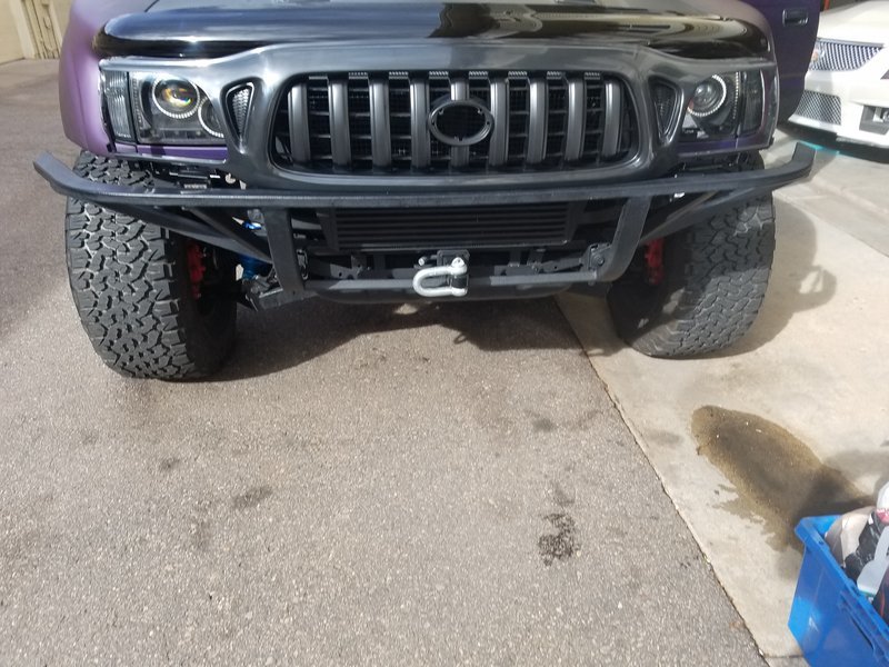

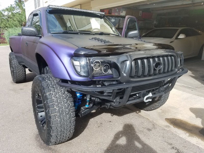

    Like the new grille way better too. Going to be lots of work to swap all this out and build new custom lights. Still need a hood and a few things.

    Damn that paint...Looks epic

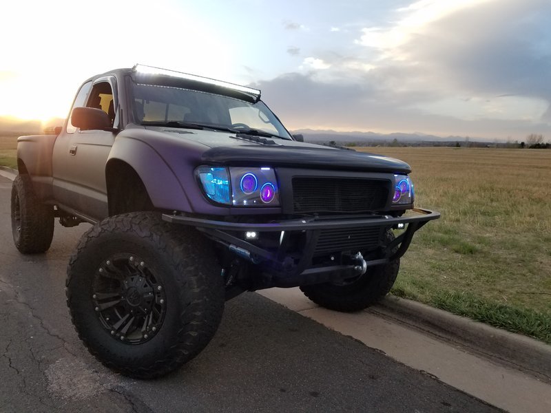

    Can't keep the name. Apparently @jberry813 has already dangled before me. Cannot disrespect the master......
    All set to convert to 01 - 04.
    The hood is a secret......

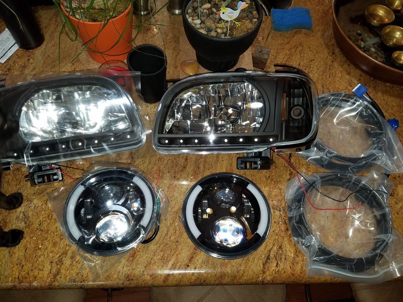

    Headlights......well not sure if this gives an idea of the retrofit.....
    Harley Davidson daymakers.......

    Nov 25, 2013
    #117294
    3,196
    Jack
    Abq New Mexico
    Wannabe Trophy Truck
    Sick Gnar Trophy Truck Tacoma and King Ranch Raptor Killer
    whered you get the headlights? found the same set for 175$ shipped. debating on smoked or clear lense. tired of losing corner lights...

    Ebay bro......think they were like $160 or so. Do you know the bracket parts that are needed to mount them? I'm 98 00 but converting. I need the core support brackets. Can't find the part #s.
