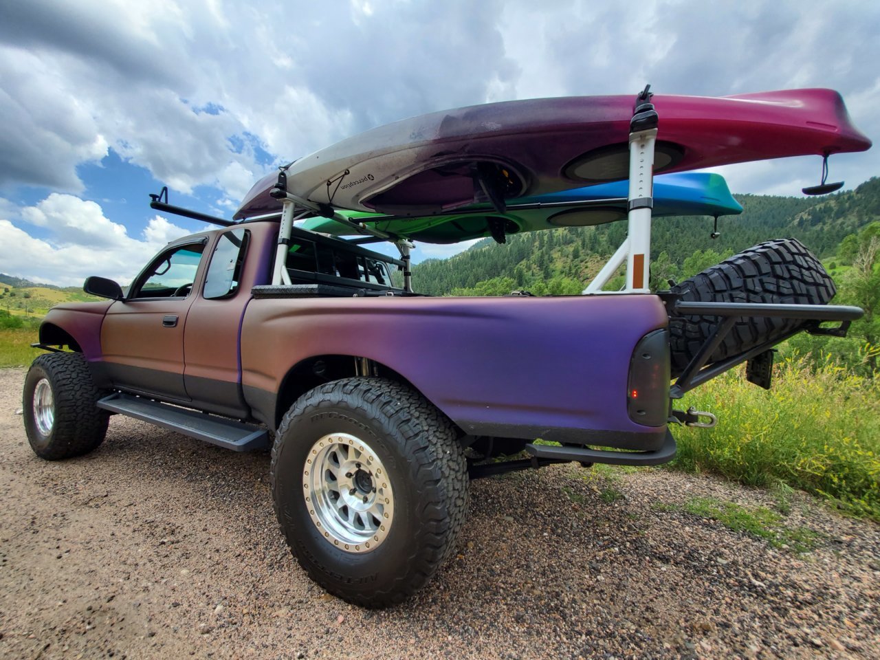

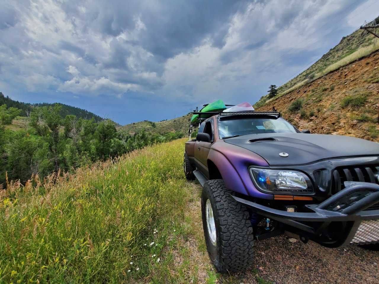

    That's an awesome wrap color? How does it hold up to pin stripes from bushes and such?

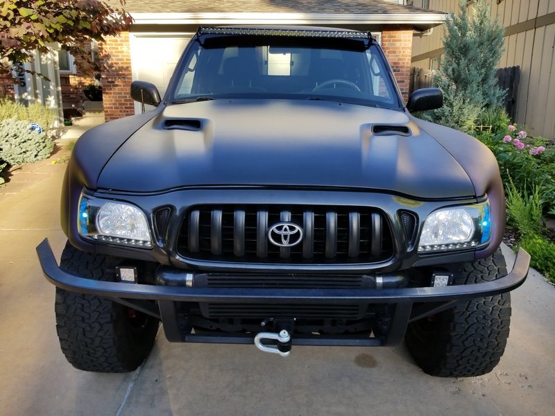

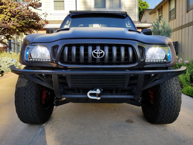

    What amber led's are those under your headlights?

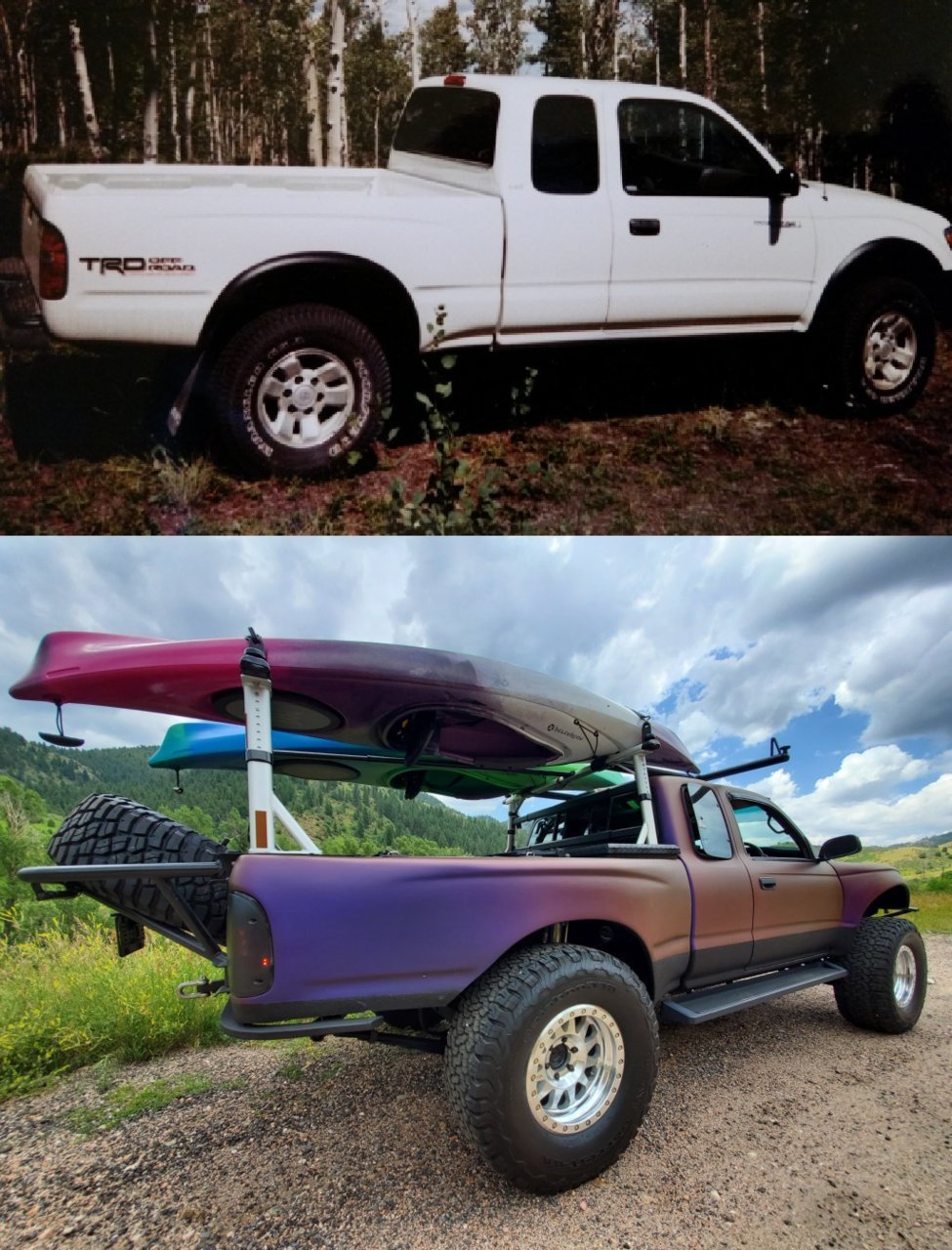

    I sprayed it in my garage with a harbor freight hvlp. Came out amazing it color shifts 5 colors in a matte finish. Couple small scratches from my mountain bike but holding up near flawless.

    Those are a brown like vinyl reflective sticker. I thought they were cool I dunno. Safety

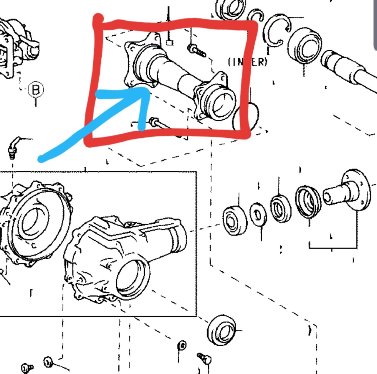

    Can anyone show me a picture of this output shaft on the passenger side of the front diff? I think mine rotated some how or my front diff mount is massively bent on the right. When I mount my diff the right side goes crazy high and is way wrong. Not sure if it's from the axle breaking that pushed the diff all crazy or what. Or do they make a bigger heavy duty output shaft?[​IMG]
