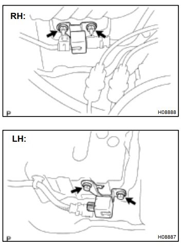

    After completing a front end suspension and steering restoration on my '99 Prerunner, I was attempting to re-install the crash sensor on the driver's side by trying to match up the holes in the fender well and couldn't line it up to where it made any sense. I failed to take pics of the location pre-removal because I took it off while I was rushing to make room for removing the UCA bolt along with a coupl'a other parts.
    If anyone here has a pic of the sensor as originally installed, would you be kind enough to post it in this thread pls?
    Safety check is due in a coupl'a months and I'd greatly appreciate any help toward re-installing it correctly.

    one is hidden just below the battery tray, on the fender and the other one is at the same level on the opposite fender

    image on the bottom shows the battery tray at top center (with the battery and plastic tray removed)

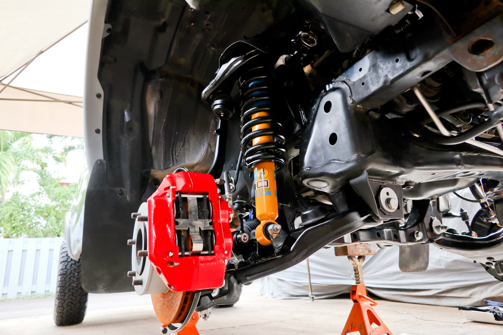

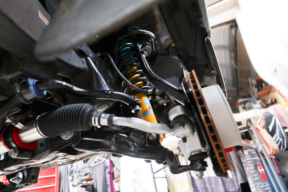

    Sorry for the delayed response @onakat, and thank you a hundred times over for posting exactly what I needed to complete the front end resto project.
    Very much appreciated, hope I can return the favor.
    Added a coup'la pics. Still needed to install small items here and there when these pics ere taken. Rain hit the rotors and developed some surface rust on them.
