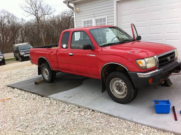

    Haha the engine was blown, and everything was sh!t. When I post more pics, you'll see why I got it so cheap.
    but this is how it currently looks:
    This is really bugging the shit out of me. I turned it "CW" in settings, but the pic still appears like that. Help???

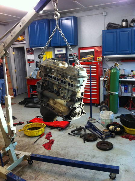

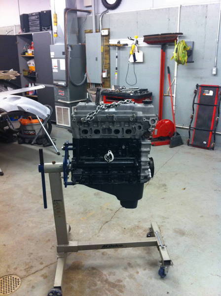

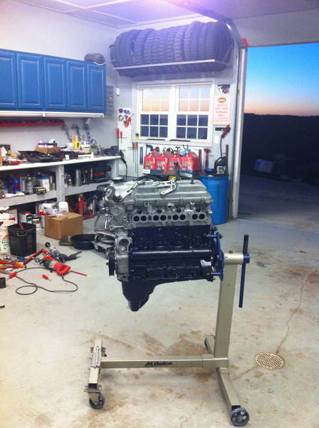

    Before & After engine block [3RZFE]

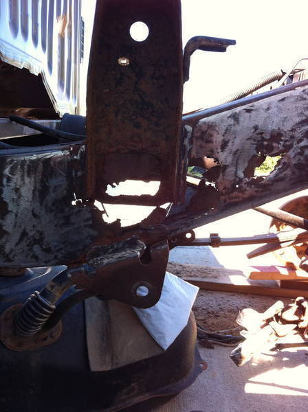

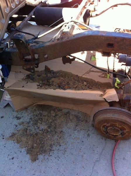

    Anyone else have rust problems on their 1st gen Tacoma frame? I found out about a silent recall where Toyota will actually buy your truck back for 1.5x's the Excellent value, if the frame fails to pass inspection.
    There is absolutely no way that my frame would have passed, and I really didn't want to give the truck up (I had too much time invested in the project by the time I found out about the recall) so I just fixed the rust holes myself.
    Pulled out probably about 10lbs of dirt out of the frame

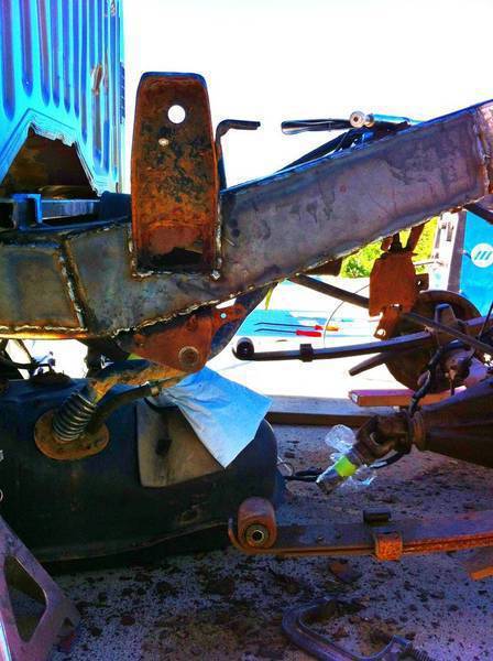

    All welded up

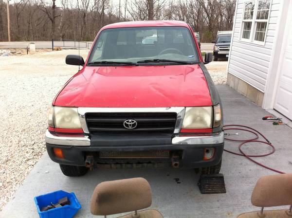

    More pics of how the truck looked when I got it. Notice all of the body damage :eek:
