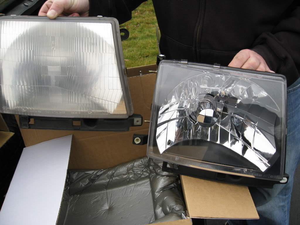

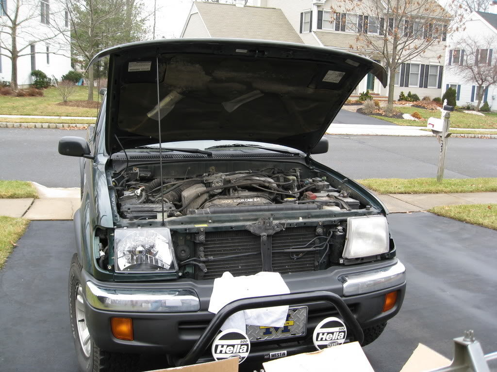

    The 1st gen headlights from 1995-2000 were never fully clear so the best you will do with the kit is to remove the yellowing effect. I was going over the same dilemna over the summer and I found a clear headlight kit on ebay for about $100 with shipping. I then installed some silverstar ultra bulbs on them and I have yet to see a brighter tacoma. Not to mention it looks better than all pre-2001 tacos in town.

    Thanks, was the kit on ebay a complete set of replacement headlights?

    Yeah the kit was a complete drop in headlight set. You do need to remove the grille and the little painted strips on the front. The headlight casing stayed the same so you do need to pull out the old ones but it shouldn't take longer than an hour.

    Wow, those are very nice. Thanks!
