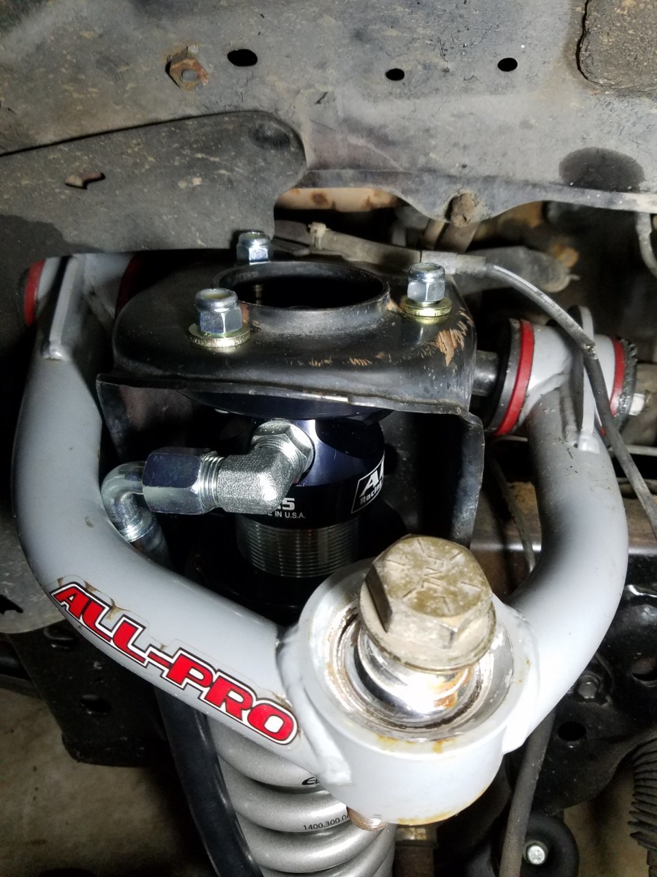

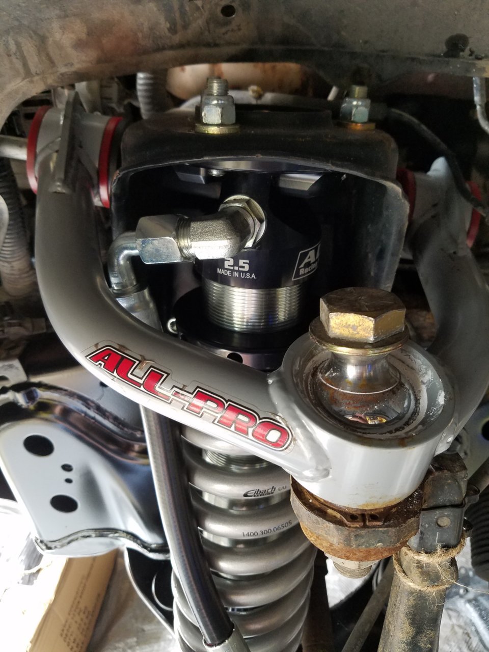

    I tried installing the front suspension last weekend as well but there had been a mix up with my order and ADS sent me the top mounts for a Tacoma which slightly changes how the reservoir hose sits in the coil bucket. This caused the UCA to bind on the hose fitting.
    After getting in touch with Tyler at ADS he sent me the correct top plates. I have to say their customer service is awesome! He made sure I had the right parts 3 days after I contacted him which was super cool considering it wasn't ADS's fault with the order mix up. Tonight I tried installing the front again only to realize that even with the correct top plates the shocks wont work with the All-Pro UCAs.
    The way the UCAs are designed doesn't leave enough room for the hose fitting to clear. Im going to contact Tyler again to see if ADS has had any issues like this before. If not I may just have to bite the bullet and order a different set of UCAs.

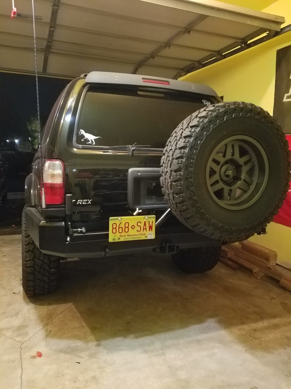

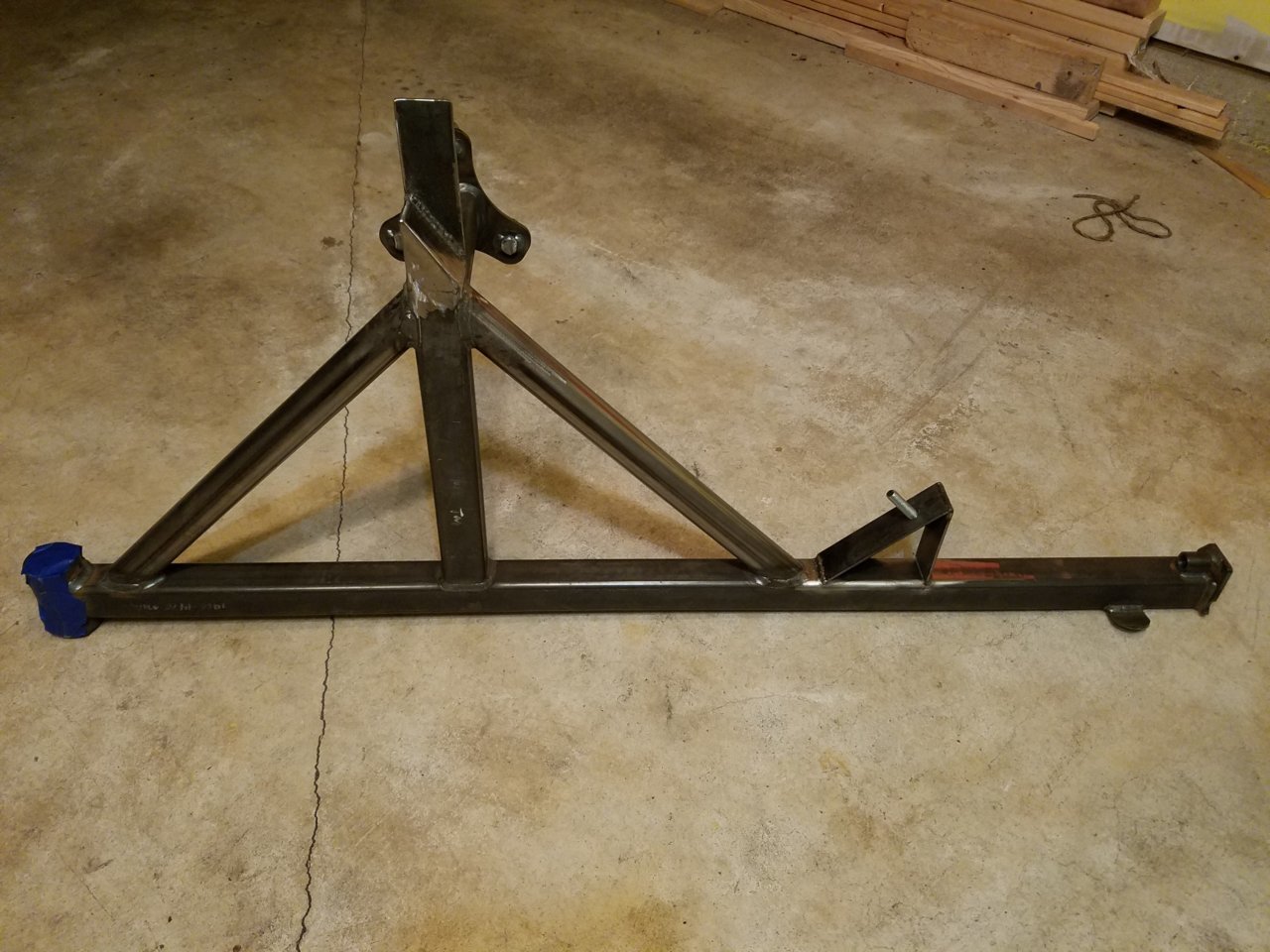

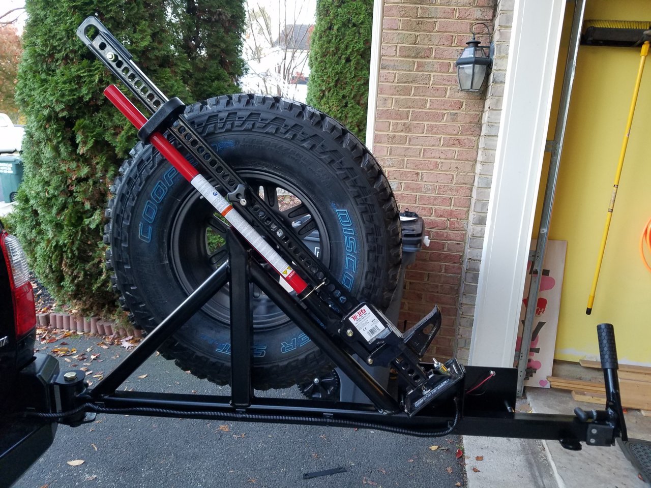

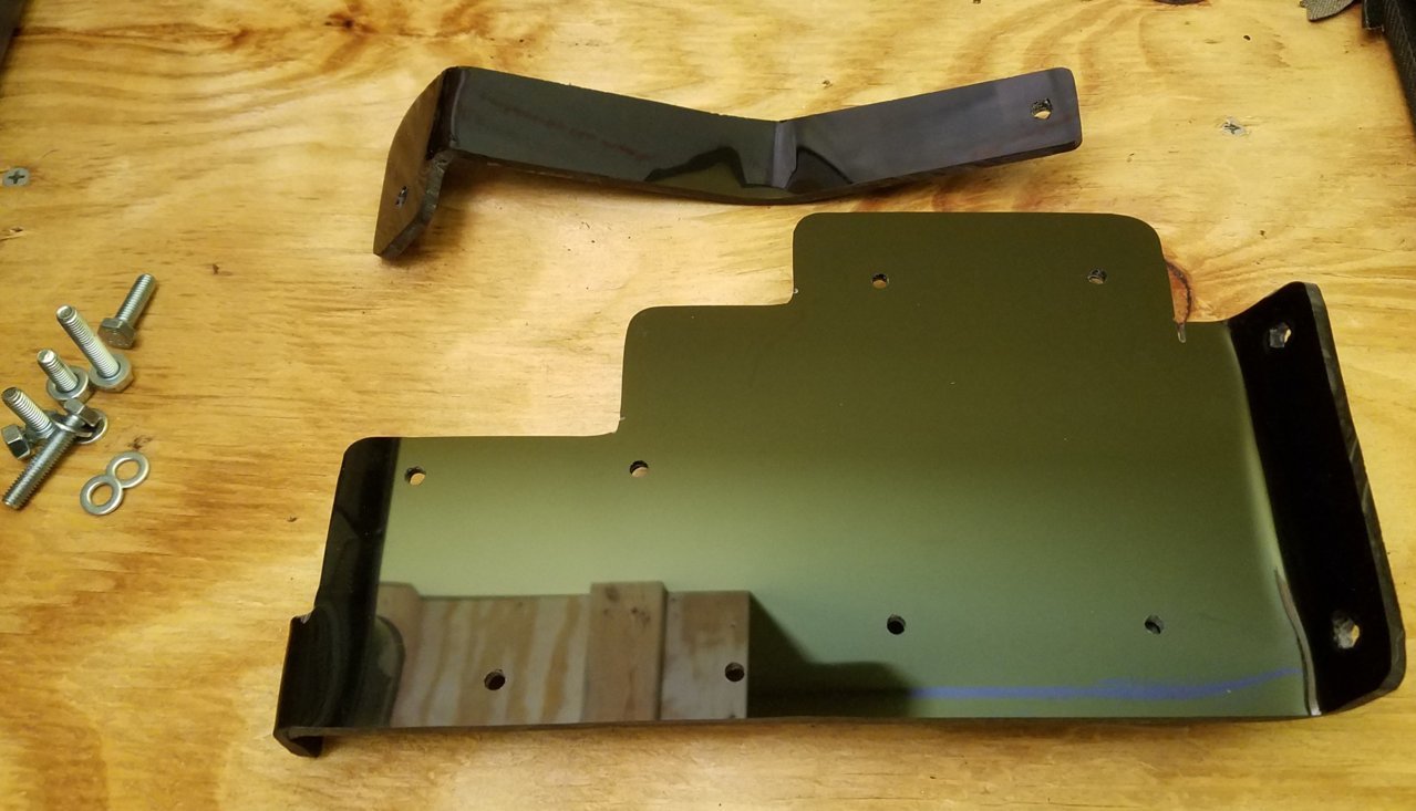

    Since I can't install the new front suspension yet I decided to start prepping the tire carrier for install. I started off by fabbing up a mount for a hi-lift.
    After I got it cleaned up I painted and installed it.

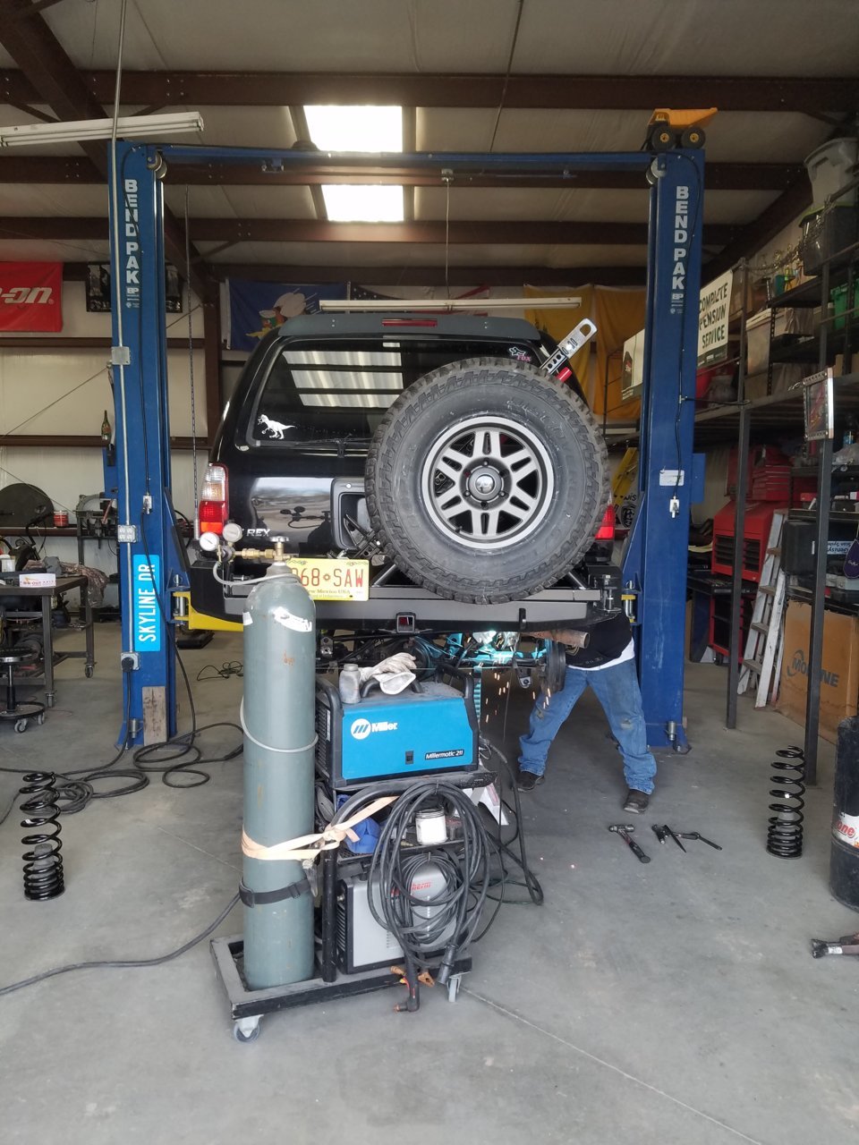

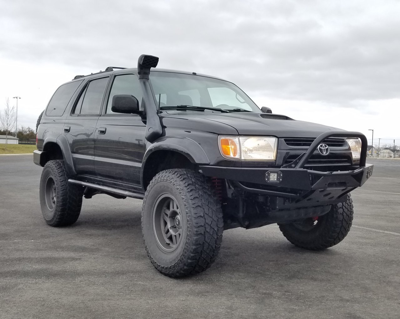

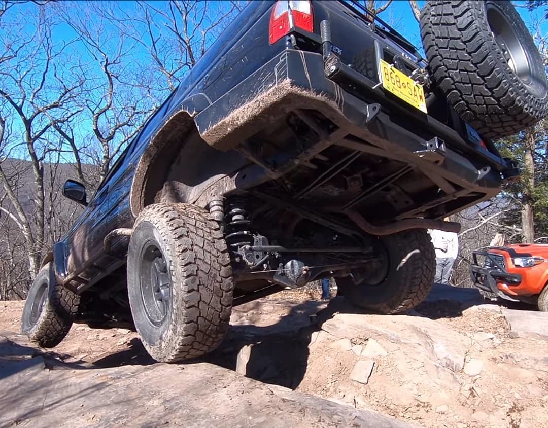

    Took the 4runner over to a friends shop to have him weld on the panhard bar correction brackets. While we had it on the lift we installed the OME 861's too.
    I have to say I was a little nervous at first because of how much taller the 861's were in comparison to the 891's. After getting it back on the ground it has a little rake but nothing too bad. It rides extremely well paired with the ADS shocks and made a world of difference! No more hitting the bump stops and still plenty of articulation.

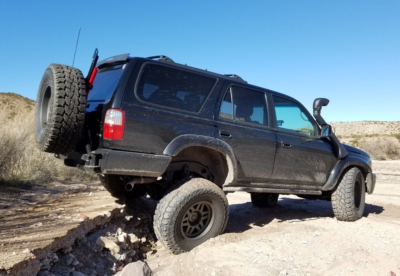

    Went for a short drive yesterday and found a small ledge to stretch out the new rear springs on. They flex really well and ride great through rough terrain.

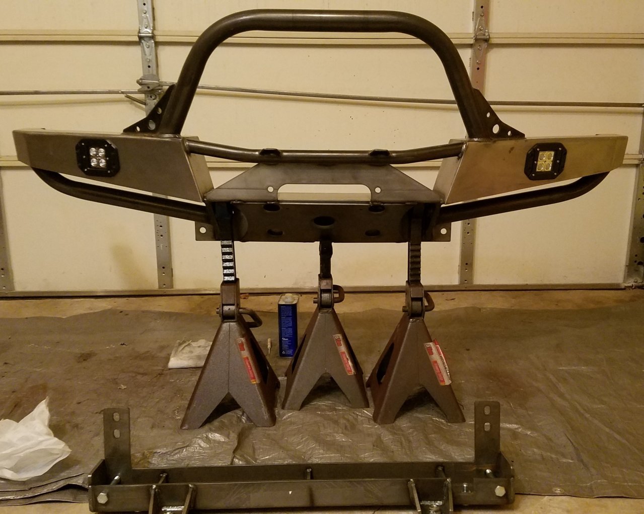

    Finally started preparing the AOR front bumper for paint last night. There was a bit of a mixup with my order so I didnt receive it until the end of October (4 months after ordering). Scotty was awesome to deal with though and made it right. It was a bit of a bummer though because I really wanted it installed before our trip to the southwest In November. Overall the quality of the bumper is great and I love how they look on the 3rd gens.

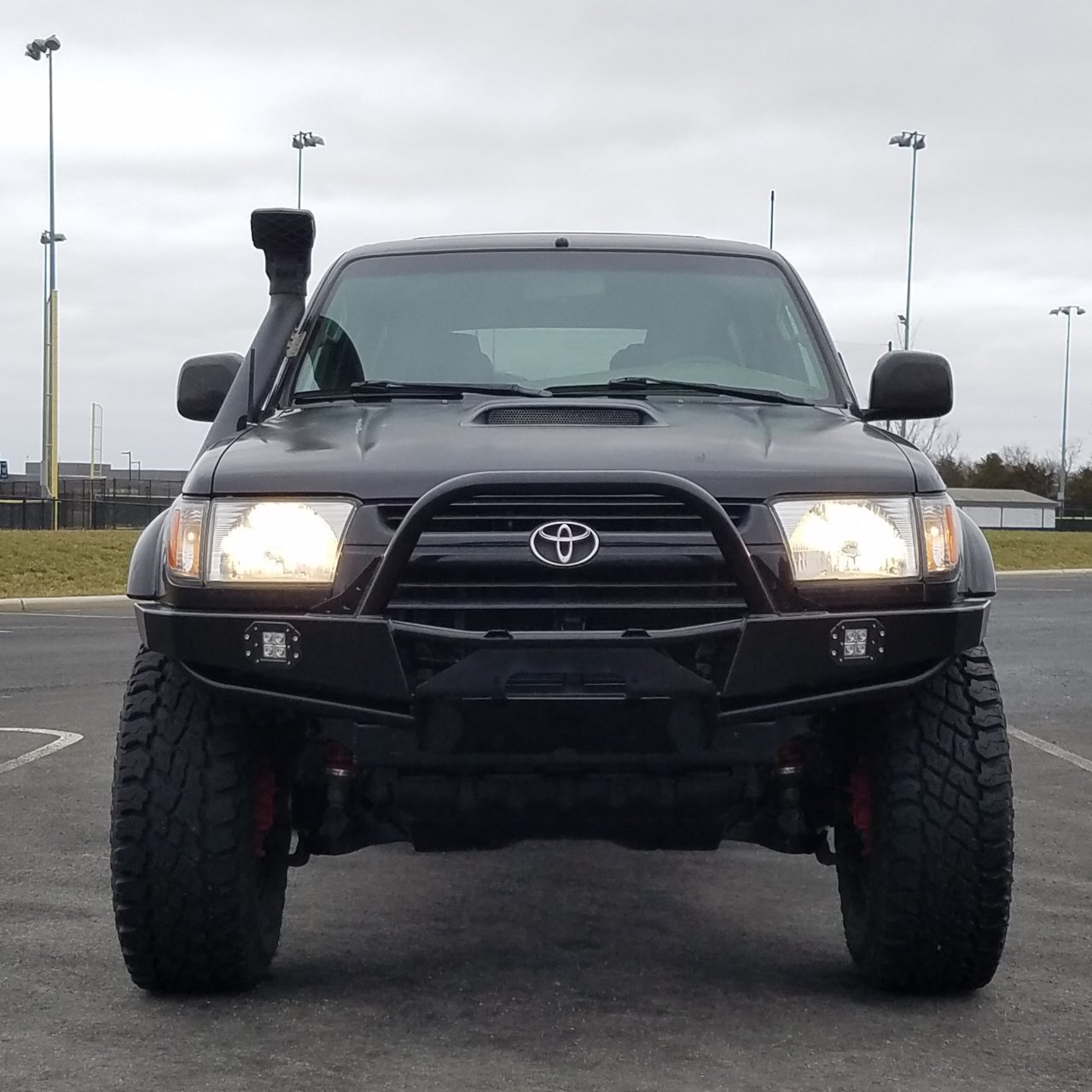

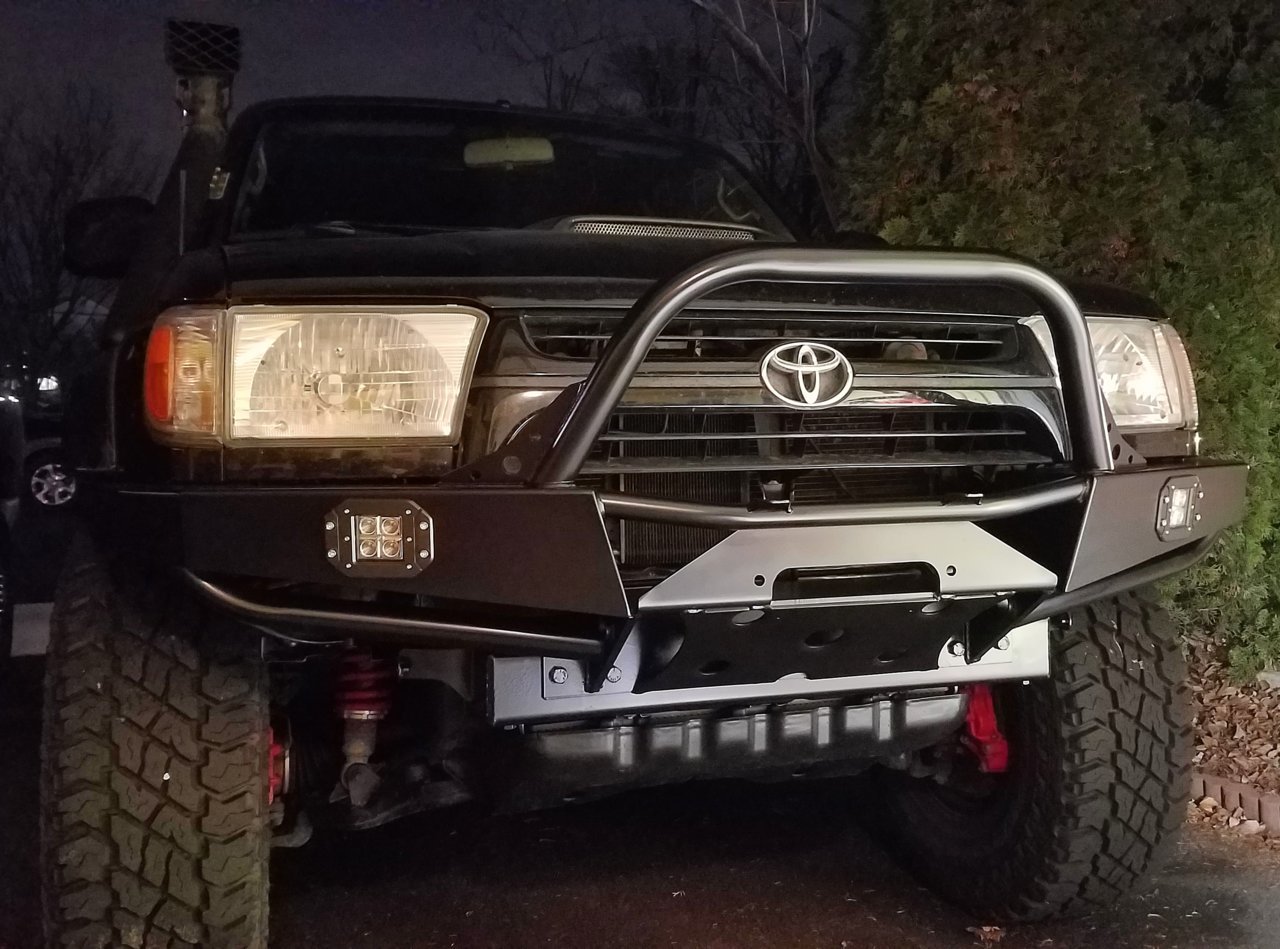

    I finally had a chance to install it last night. I love the way these bumpers look as well plus they are lighter than some of the other options on the market. Ill get better pictures during the day today.
    smw62891 and MattJakobs[QUOTED] like this.
  12. Jan 11, 2020 at 3:45 PM

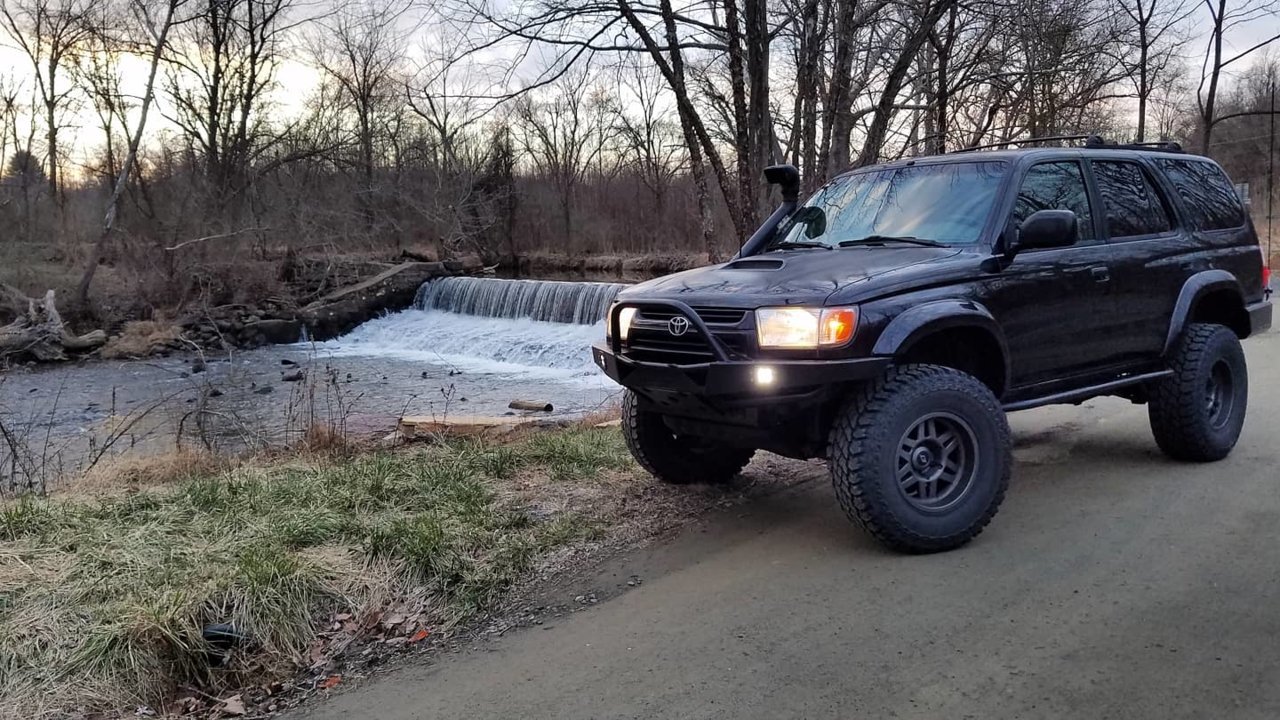

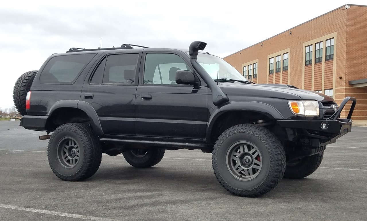

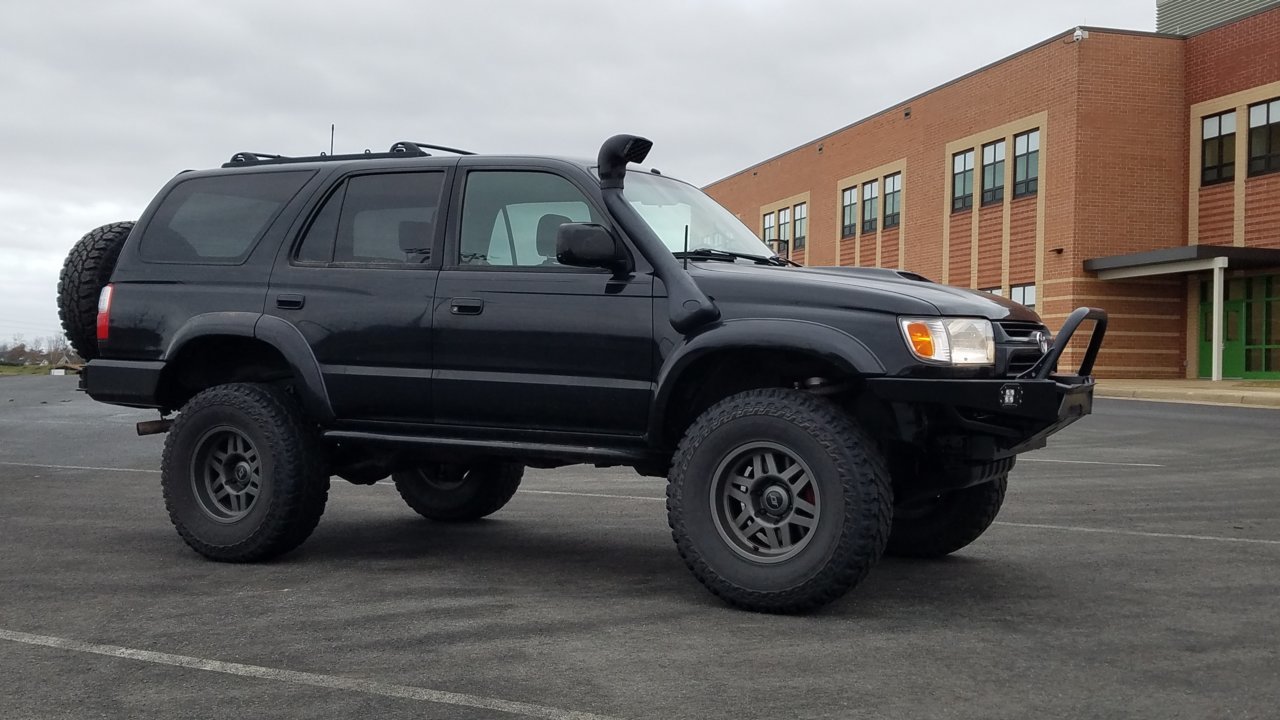

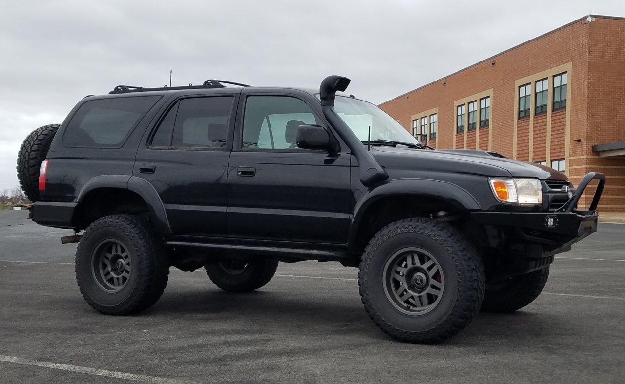

    Here's a few daytime shots with the new bumper.

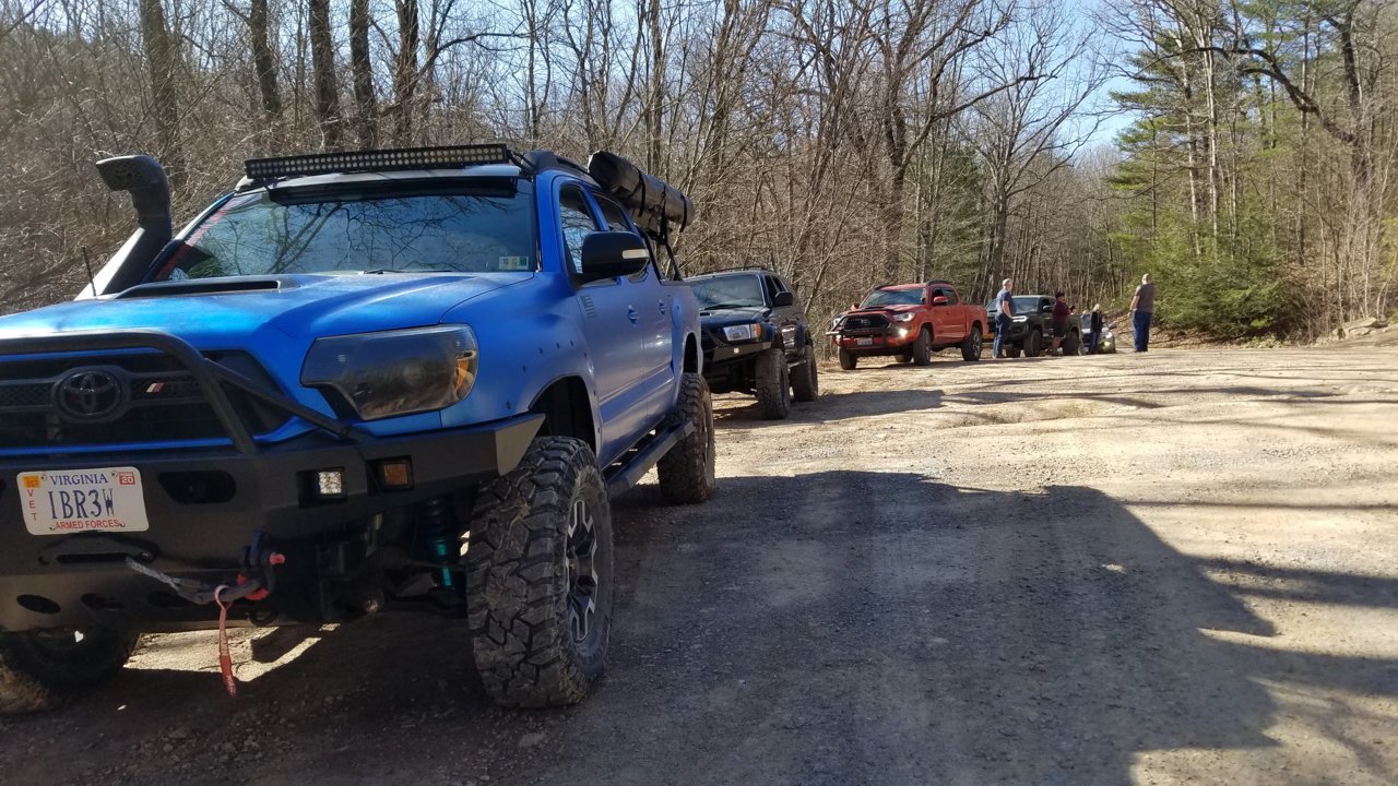

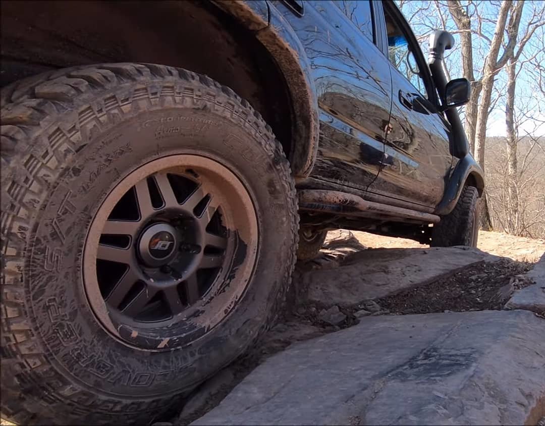

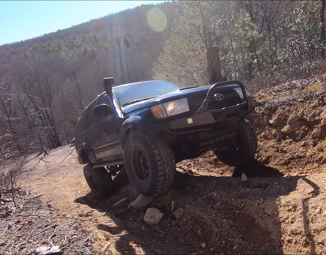

    Made it out for a group trail run today with a few local TW folks. Had a blast playing around in the VA mountains and really had a chance to test the new approach angle with the AOR bumper in a few spots. Unfortunately I didn't get any action shots of the 4runner but hoping someone else in the group did.
    20200308_133124.jpg 20200308_125659.jpg 20200308_102446.jpg 20200308_211652.jpg

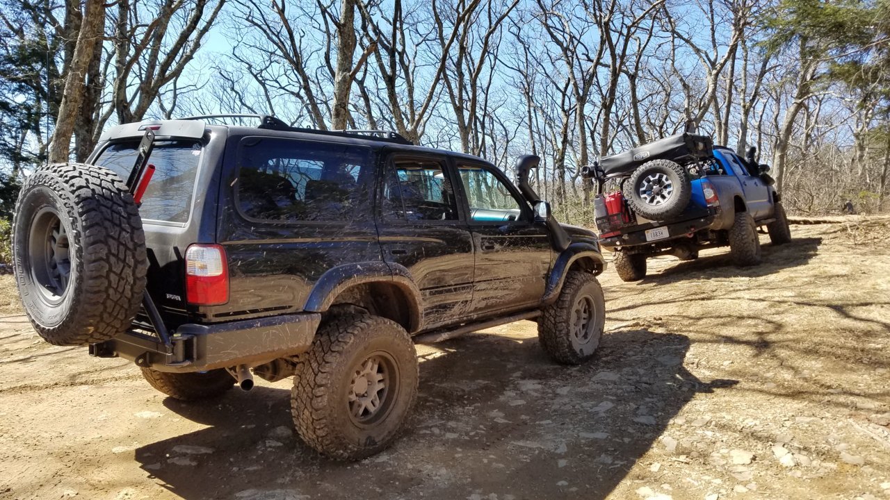

    Finally got a few more pictures of the 4runner from the last trail run.

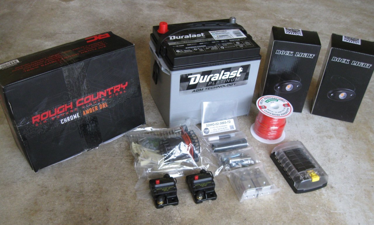

    Well with all the current restrictions on travel and having a little extra time off work I was able to finally get together most of the parts I needed to clean up some of my auxiliary wiring. I'll post progress pictures as I get things done but for right now here's a shot of the parts I've gathered so far.
    What I'm working with:
    -Duralast AGM Battery
    -SDHQ battery terminals
    -4 Gauge Wire
    -14 Gauge Wire
    -Blue Sea Fuse Block (12 fuse terminal)
    -Bussmann 120 Amp Breaker
    -Bussmann 100 Amp Breaker
    -Delphi WeatherPack 22 Position Connector Kit
    -Rough Country LED Pods with Amber DRL
    -Amak LED Rock Light Kit (8 pods)
    Electrical always seems to be the out of sight out of mind thing for me so I really did a lot of research into a few other builds for this project. Ultimately I hope to keep it all from looking like a rats nest under the hood when I'm done :thumbsup:.

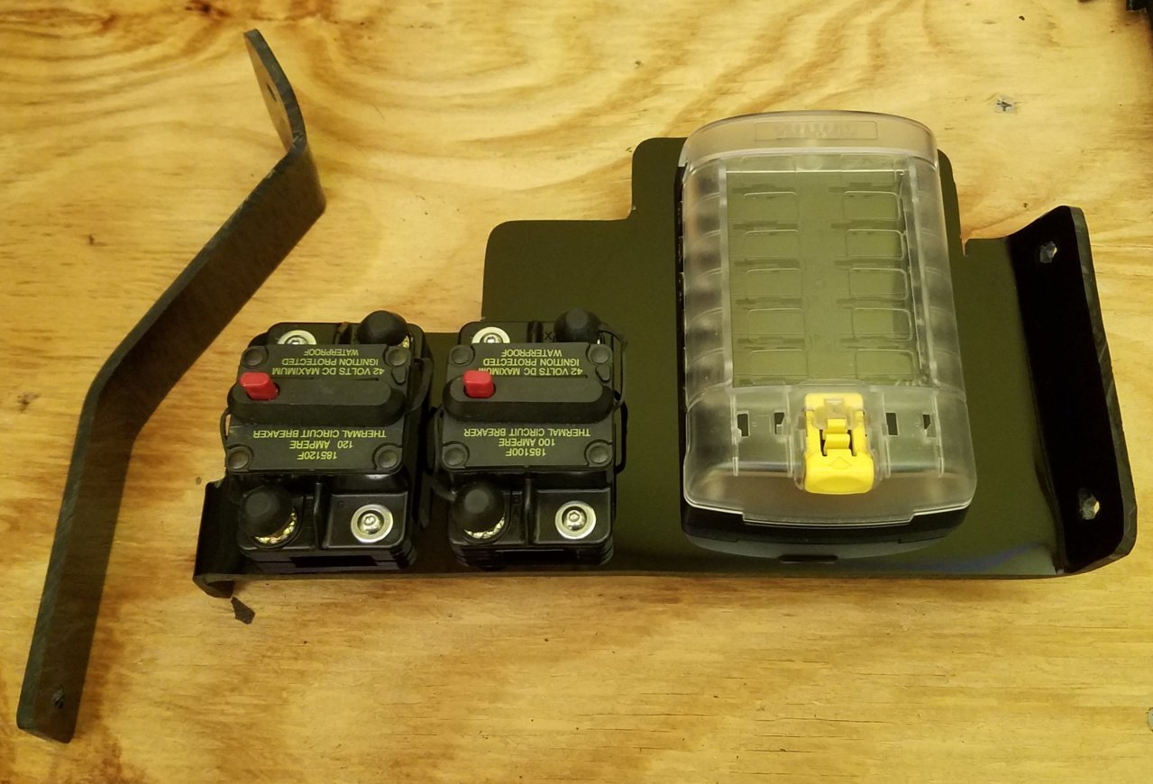

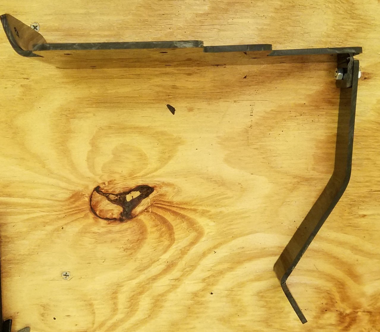

    Made some progress today on the fuse block mount. I can't take credit for this design as I borrowed it from Ripcord's V2.0 4runner build. I started out with a black acrylic sheet and cut and shaped it with a cutoff wheel to fit next to the factory fuse block under the hood. Next I used an angle finder to determine what my bends were going to be on the mounting plate and the support leg. Once I had my measurements I used a heat gun to help make the bends.
    Platform and support leg
    Side view with the support attached
    Fuse block and breakers attached
    I should have install pictures by this weekend. After I get this setup I can start working on my wiring.
