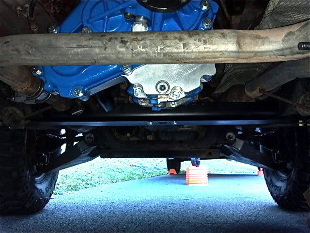

    4,992
    I'm running the 4.7 XD set in the crawl box and 2.28 in the lefty. I went this rout over the Fj case so I could convert to a flat belly (see pic below). I know most people say the lefty gear drive case may be weak compared to the chain drive case but 3 years 2 trips to Moab and many other trips and no issues yet.:cool:
