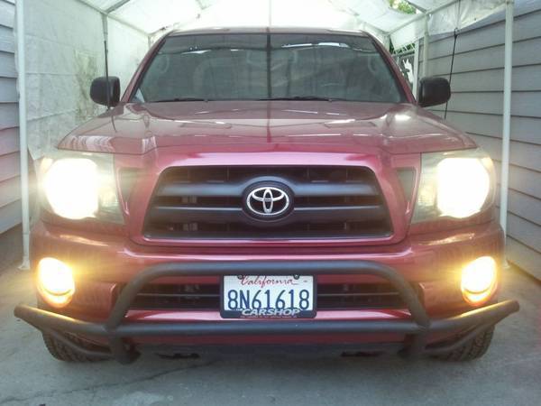

    Here's a comparison of the philips (drivers side) and the silverstars (passenger side) and you can see the light is not the same color, so those are out.

    Yikes... I got your PM, unfortunately I've always gone yellow with the fogs and never attempted to match the color. Unfortunately, I think you might have a hard time getting them to match exactly. I think you're going to end up with slightly different shades of white. The PIAA Xtreme white bulbs I have now are pretty close to the Philips bulbs, maybe a little whiter and they have a blue hue in the lamp itself (none of the light is blue).

    Thanks Mike I will keep those in mind. I have some cheap "ultra white" bulbs that I had from a while ago that I'm going to try first but I'm betting they will be too blueish.

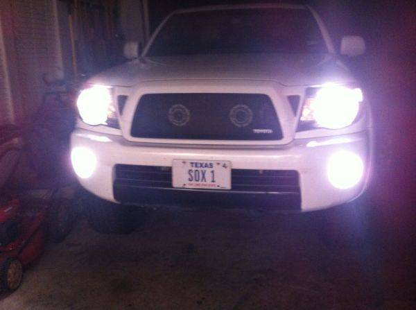

    Got the Philips bulbs in and I really like them. Much brighter than stock, without the worry I had before that I was blinding people with my hids.
    As for the color, I noted earlier that I purchased some cheap "super white xenon" halogen bulbs to try out. The color is pretty close to the Philips, close enough to make me happy. The cheap bulbs light output is terrible, but I've never relied on the fogs for much lighting anyway.

    Here's a picture of the match. You can see that the fogs are just slightly less yellowy, if that's a word.
