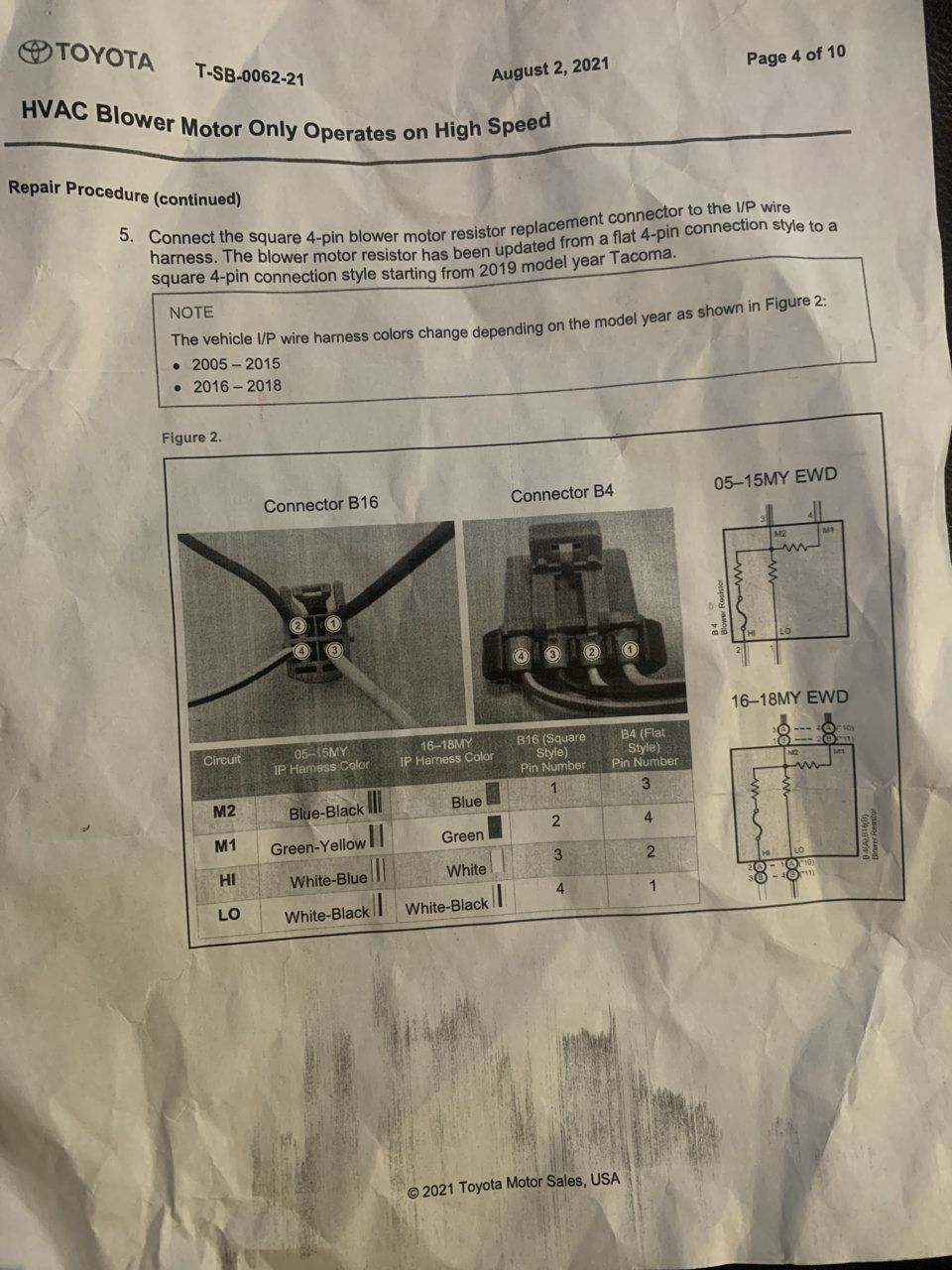

  15. Jan 1, 2022 at 9:02 AM
    AANorthwest
    AANorthwest Well-Known Member
    Feb 27, 2016
    #179604
    170
    Washington
    2012 DCLB 4x4 TRD sport
    Had to get a new blower and the newer ones have a different plug. This helped me wire the new plug up. I bought from dealer and they gave me this paper to help me out. Hmmm. Not sure how to upload pic.image.jpg
    Jimmyh likes this.
