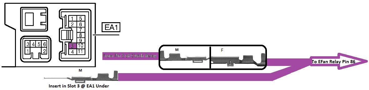

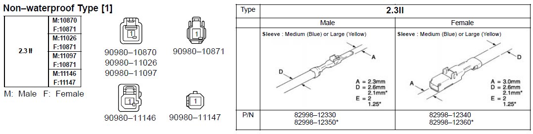

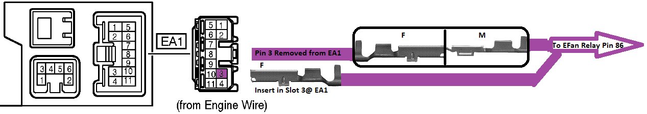

    So the OEM harness is not cut, get a matched pair. Then remove the purple wire from the EA1 plug. (position 3) [these are non-sealed pins]
    It can be left on top or done underneath.
    There's a 2015 TSB that addresses the addition of a EFan.

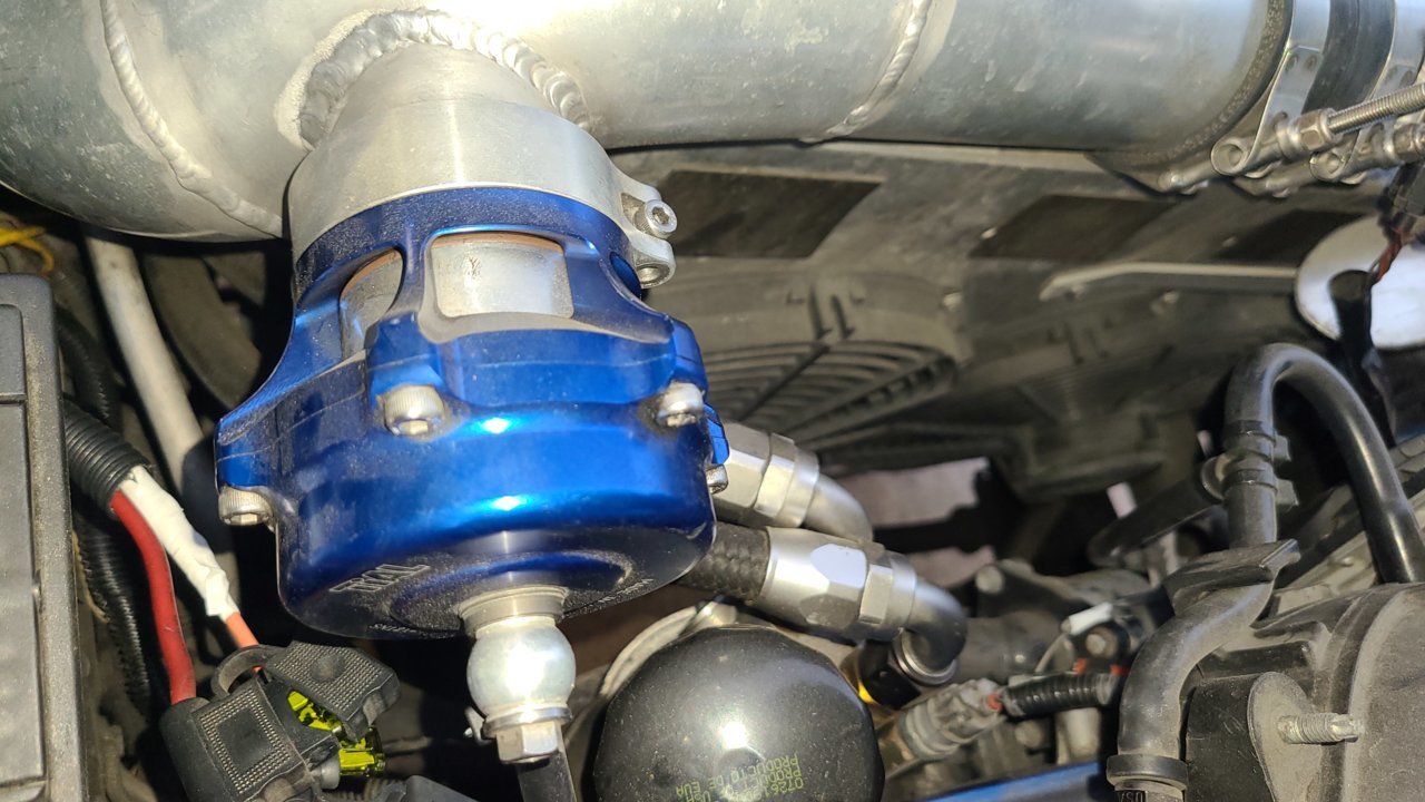

    More airflow, in normally low airflow situations.

    I have two SPAL 14" or 16" fans. Pretty sure 16"
    They were installed long ago where they both came on 100% with a thermo-switch in the thermostat manifold. I recently made one come on with the Fan speed knob.
    They cool the engine extremely well. Including through an intercooler and condenser.
