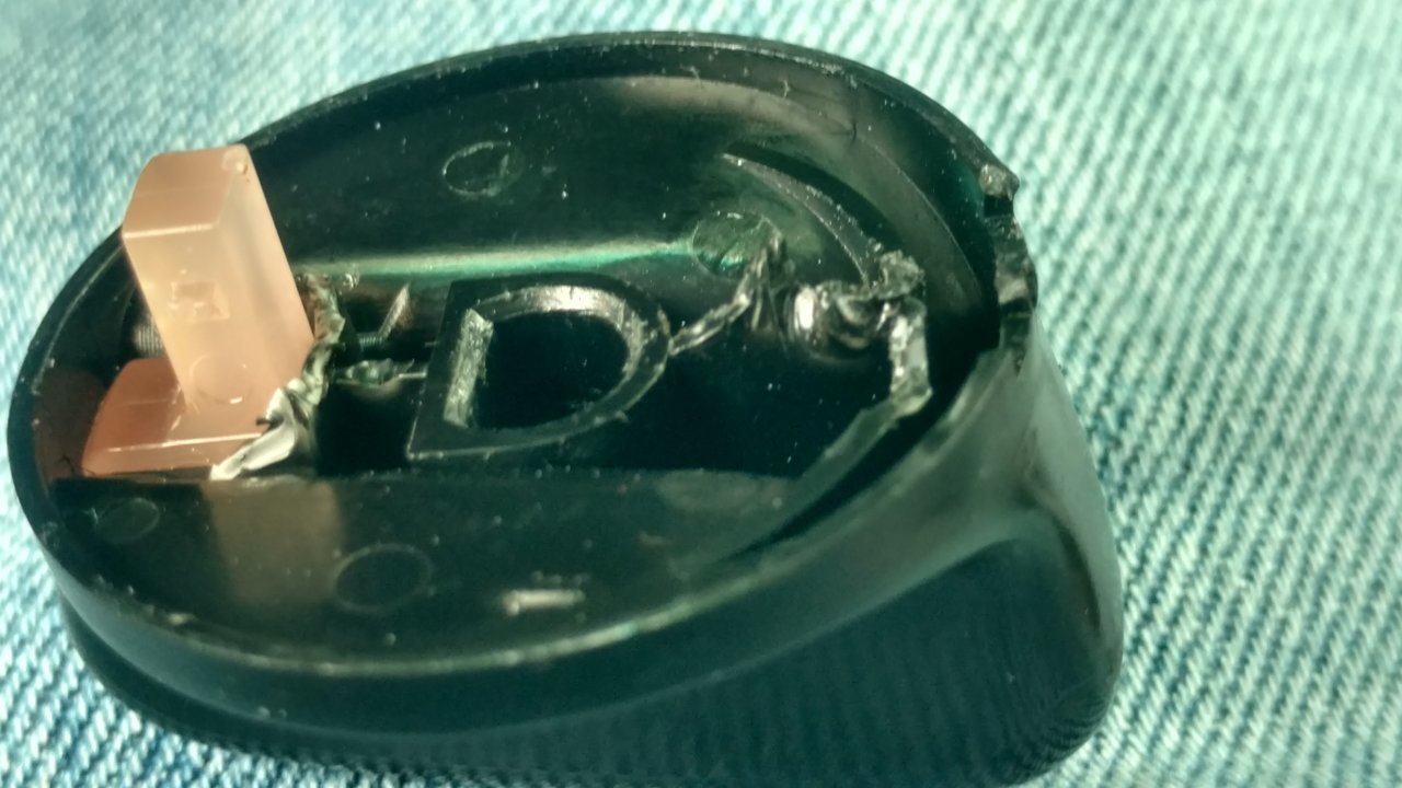

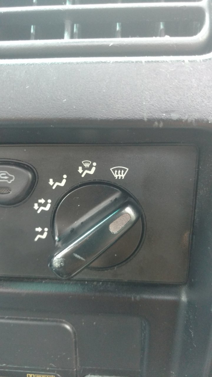

    2002 Tacoma 2.7 - 4 cylinder - PreRunner
    I was able to fix the issues simply by breaking the clips... and turn right ( more than the where defrost location)

    DD Deck+backup camera, LED DRL, All LED except H4 Hella
    From my understanding it is recommended to run AC from time to time even in winter. Actually nobody would run AC in winter (I mean real winters with sub-zero temperatures, not California stye) unless for blowing dry air in defrost mode. So the built-in feature of auto AC-on when in defrost position helps with that periodic use of AC. When it is disabled you will have to remember to use AC from time to time.
    I'm not saying this mod is wrong - it just gives you more control with more responsibility for your actions. My truck is like that - the vent position direct the air, the AC switch turns AC - both functions separate.
    In my 2012 4Runner the AC comes on automatically when I switch air to defrost position, but probably Toyota people were pissed for owners breaking the tab in the air control knob (like you did :)) and in that truck I can turn off AC even in defrost mode just by pressing the AC switch.
