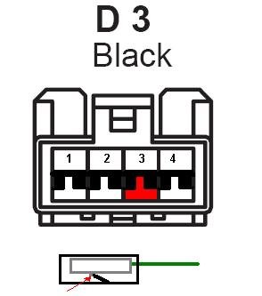

    So I got bored and wanted to disable the A/C from coming on when selected the mixed(floor/windshield) and windshield only modes on the environmental selector. It kind of sucks to have the heat on in the middle of the winter only to have the A/C turn on and waste MPH.
    So consider this is an Eco-Friendly mod!:D
    After looking at the schematics I found that the green wire from the D3 connector triggered the A/C amplifier to engage the compressor. There is also a separate trigger wire for the manual A/C switch. Bonus!

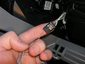

    Here is how it's done:
    Locate the D3 connector on the defroster servo and remove it.
    Remove the white retainer and insert a small piece of wire to release the SOLID Green #3 wire. Not the Green with Black stripe.
    Fold it back for safe keeping and tape it up to prevent shorting.
    Then plug it back into the Servo. Don't forget to re-install the white retainer!!
    I've tested this for a few days and the A/C will still turn on with the manual A/C button on the environmental control panel.
    Edit:
    There were some questions on how to remove the terminal from the plug (plastic) and I just wanted to clarify for those who have yet to take one part.
    After you remove the white retainer, you still need to insert the helper wire, into the inverted 'T' slot below the square slot, to remove the spring loaded clip still holding the terminal to the plug.
    Edit:
    Fellow TW member rlg0613 suggested a jewelers screwdriver which I didn't even think of.
    Edit:
    I added a diagram to clarify this.

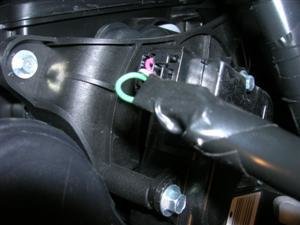

    Ok, so what panel did you find the connector behind, and how does it come loose?
  14. Apr 8, 2008 at 9:53 PM
    CtryBoyInMT
    CtryBoyInMT [OP] Lifetime Member
    Nov 27, 2007
    #3632
    487
    United States of America
    2008 4WD V6 Access Manual TRD Off-Road
    Tinted windows, Rear locker anytime, Secondary filter delete, Parking light activated Fog lights, USA▪Spec Ipod adapter, Map light mod, Relocated 7-Blade, Warn Trans4mer Brushguard & winch, Tire chains, Homelink© installed in headliner, LED lighted 4x4 Switch, Defrost w/o A/C, Heated mirrors, Bilstein 5100's (1.75") & Rear TSB, 50w Reverse lights, Pratt & Whitney PT6A-68, Will this list ever end???
    The only thing you need to remove is the glove box. Push in on the two limit stops holding it and lift the box off the hinge. The First picture is taken from the passenger seat looking toward the center of the dash through the opening left from removing the glove box.
    Edit: Just about forgot... If you still have that pathetic waste of a shock on the glove box, you need to remove that, too!
