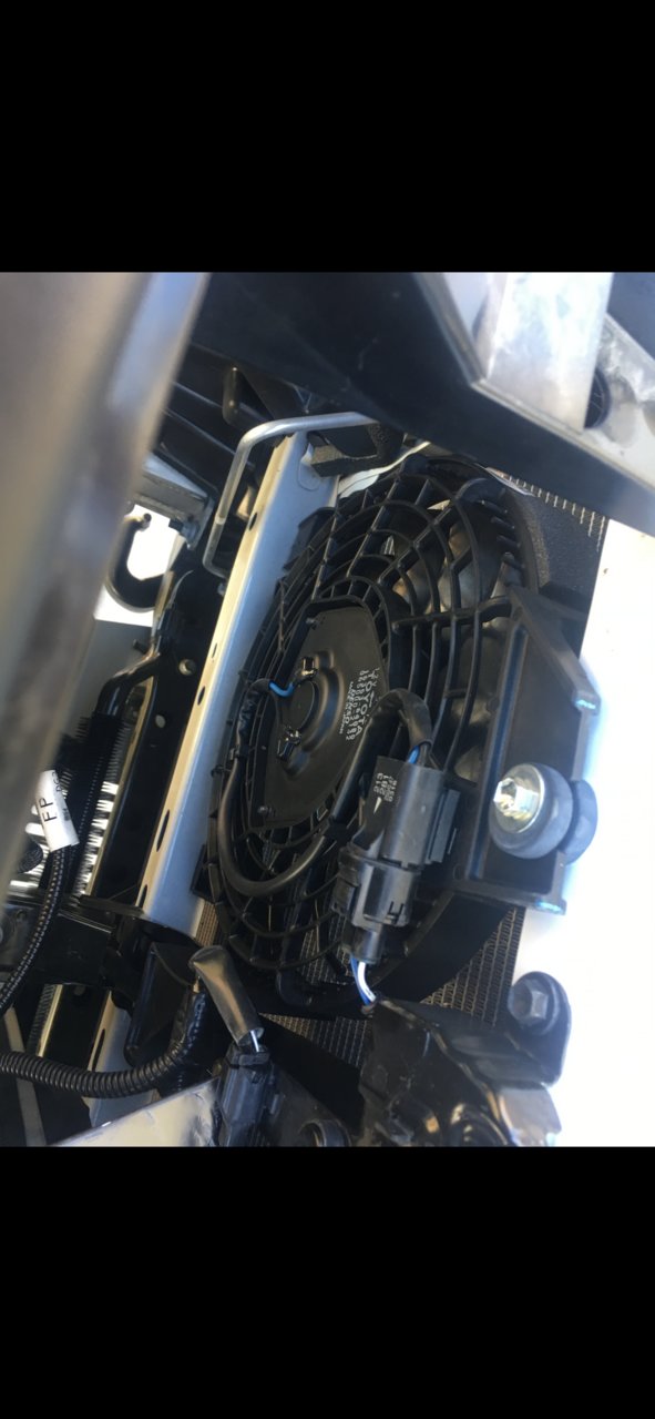

    They installed mine with no questions asked , all I did was bring up the tsb and they ordered the parts EB154962-6A5A-4666-990C-57F96F867766.jpg
