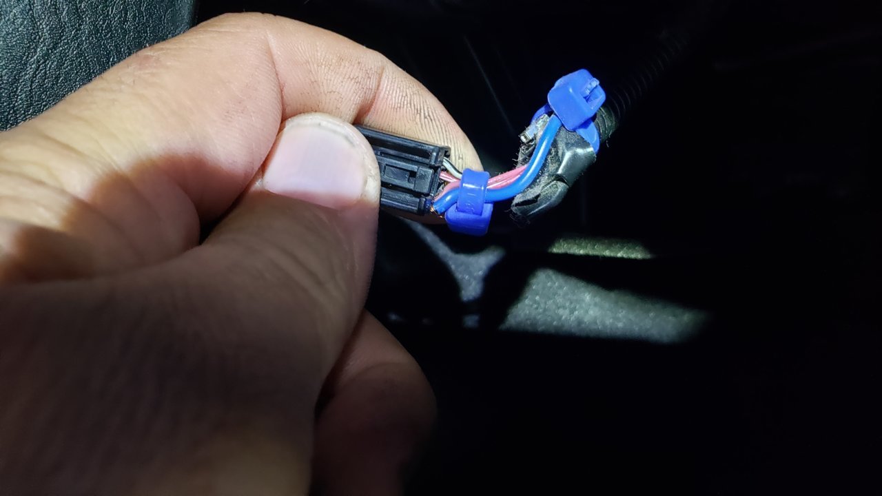

    Anyone know what gauge wires these are. Want to get a t splice to tap into the 12v pink wire..

    I would say about 20ga, i just depinned mine, wrapped a small piece of wire around it, stuck the other end in next to the 12v pin, and secured with a couple zip ties. That way it can easily be returned to stock, I've had it that way for over a year and had no issues doing it that way.

    This works in my 2010.
