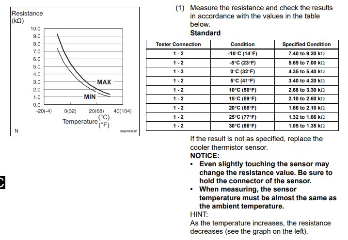

    @CurtB - I have been doing that. I bought the truck used a few weeks ago and on the drive home I noticed it, of course the guy said he never had an issue with it.... my plan is I'm going to give the truck to my son in a year so right now its parked. I have been doing the defrost method on the few trips I made, wife doesn't like it!
    I am a refrigeration tech by trade and also work with electronic controls, I know a little bit about whats going on but no means an expert on car a/c's! I started with verifying the charge, I pulled all the gas out, pulled a vacuum to 400 microns, then weighed the charge back in just so I knew that was correct. After googling and thinking through the issue more I arrived at checking the thermistor.
    I used the chart below to verify the sensor is bad, I will also measure the new sensor when i get it this week. My sensor is reading around 126 ohm sitting in my garage around 80 degrees. Its not completely bad as it does increase in resistance when the AC comes on.
    I can't believe they didn't make this a slide in and out replacement!!! I have a trust issue with hiring anyone because there are so many people out there (any trade) that don't know what they are doing, I didn't want to take this to a dealer and have them charge me big $$$ and still not have it fixed.

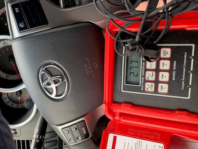

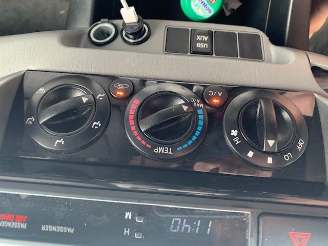

    I did a little test today in the driveway...
    -Fan on second lowest setting
    -AC on Max with recirc
    -Outside air - 81 degrees
    -Idled the engine to 1300-1400

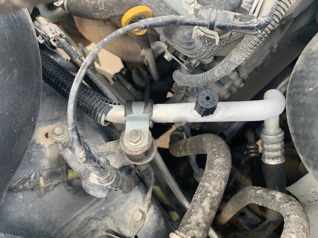

    After idling for three minutes at 1300-1400 the discharge air out of the vent was 27 degrees, I shut the truck down and popped the hood to look at the suction line and it was already icing (expected if evap air temp is that low). From reading posts in this forum someone said that the thermistor is suppose to shut the compressor off at 36 degrees... that coupled with the resistance readings I took is how I am arriving at the bad thermistor. I have had a few people think its the expansion valve but I can't wrap my head around all the data and how it would produce these results even if it was overfeeding...
    Looking for someone to confirm with me that its the thermistor causing the freeze ups.... helps me to have multiple minds that agree or disagree.

    If only you had LP gauge readings. At 27f the LP would be ~15psi. The LP switch should shut off the compressor at ~28psi. I kinda think you have 2 problems, the thermistor and the LP switch. I don't think that LP switch is expensive, and definitely easier to change. I'd try that 1st.
    I don't know about a Tacoma, but a lot of older vehicles had a schrader valve under the Lp switch, no need to recover the freon. Just unscrew the switch and screw the new one on. Maybe someone else knows for sure.
