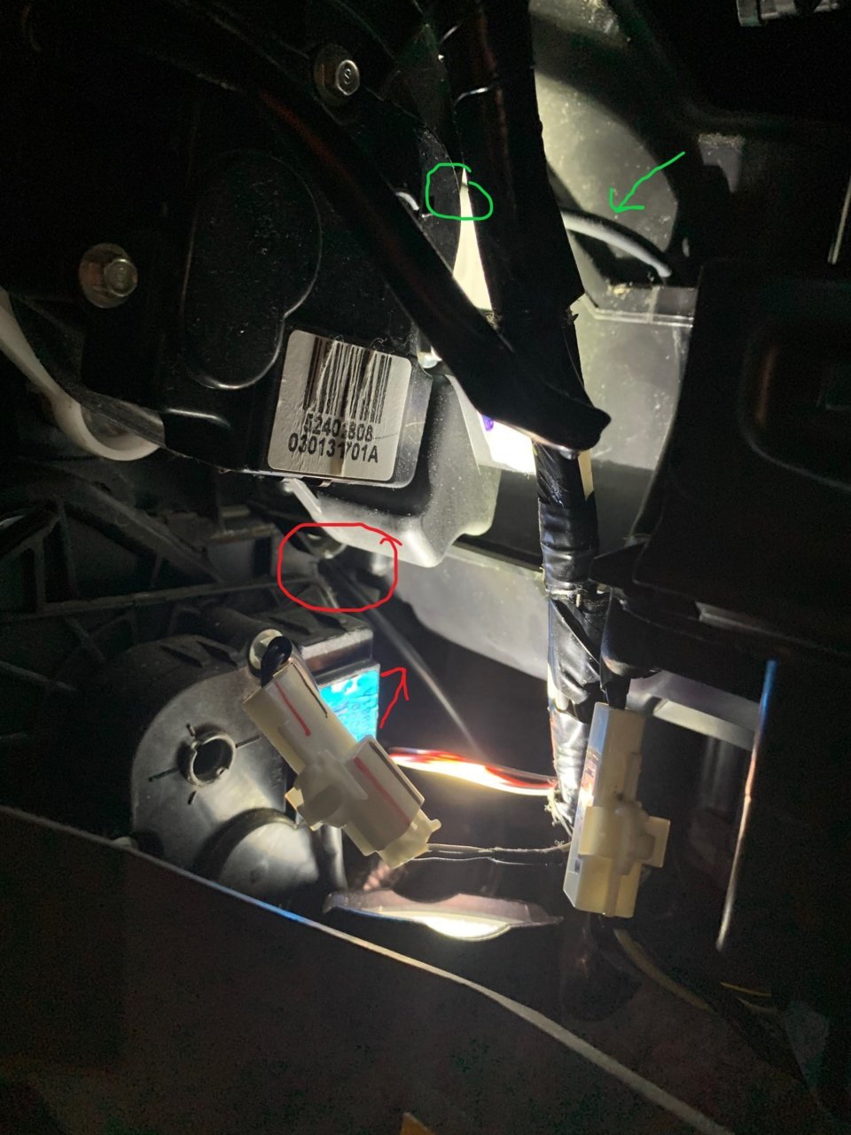

    Well i picked up my new sensor today, verified what we expected it was way off (1k ohms off) on resistance compared to new one.
    I have been studying the design of the evaporator box and all the dampers/servo's trying to find a way to not take apart the whole dash which to me seems silly... After doing my research and watching many video's and looking at pictures I made the decision I was going to drill a new hole about 6" lower than the factory sensor to install. It will still put it on the face of the evaporator and in the air stream before any dampers. I put the hole in a place where i knew it wouldn't hit the evap adn drilled VERY slow.
    It is working as expected installed in the new location. I know some may say this is not per OEM and this might be half-a$$ing it but i wanted to give it a try first and it works. All i could do is mess it up and still have to take the dash apart.
    Green arrow is the factory installed one, red arrow and circle is where I put the new one.

    As Plato said, Necessity is the mother of invention.
    As long as it works and doesn't cause a freeze of the evaporator I would say good job.
