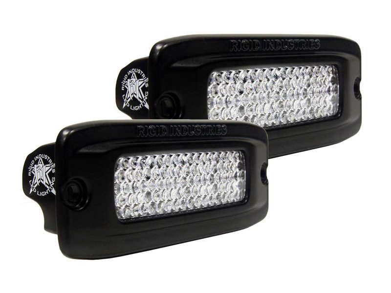

    IMG_2648.jpg I've been kicking around some thoughts on a more theft preventative approach to ditch lights on a 2nd gen. I don't have these lights nor a spare mirror to experiment with but was curious as to whether or not any of you guy had tried something like this. My thought is recessing a light like the rigid one in the pic into the mirrors. Obviously the 2 main concerns are a) is there room for it to fit behind the glass and b) will a light like this be bright enough to serve that purpose. This particular light claims near 1500 lumens. Interested in you guys thoughts. Especially if you have attempted a mod similar to this

    Problem with 2nd gen mirrors is they are power mirrors. So you are limited to mounting depth. And they are fix position. Which may not be a big deal, I like that I can move mine on my manual mirrors.
    I did a write up on mine.
    https://www.tacomaworld.com/threads/1st-gen-side-mirror-lights.248168/
    You'll want the slimmest light you can find. Should be do able if you have then time and mirrors to cut up. Should be easy to route power.
    I love them. Better then ditch lights as they are wider and more angled then ditch lights. They light up exactly where you look when you want to turn.
    Mine also aren't super duper bright. So I can use them around town and on tight trails so they don't reflect back and blind me a lot either.

    It's not the motor. It's the linkage and stuff that moves the mirror that gets in the way.
    Won't know till Ya take it apart though haha
    Those are TRS DLRL. Not as bright. But you could fit two or three in my mirrors. Also pita to fit. Look cool though.

    I was just looking at some like those with an aimable design. If they are difficult to mount then I doubt I'd go that route. Good write up sir

    Shit. Expensive. The dual one is cool though..also expensive haha
    Also remember lumens aren't everything. Lux is better.
    I don't remember what mine output but they are 6w.
